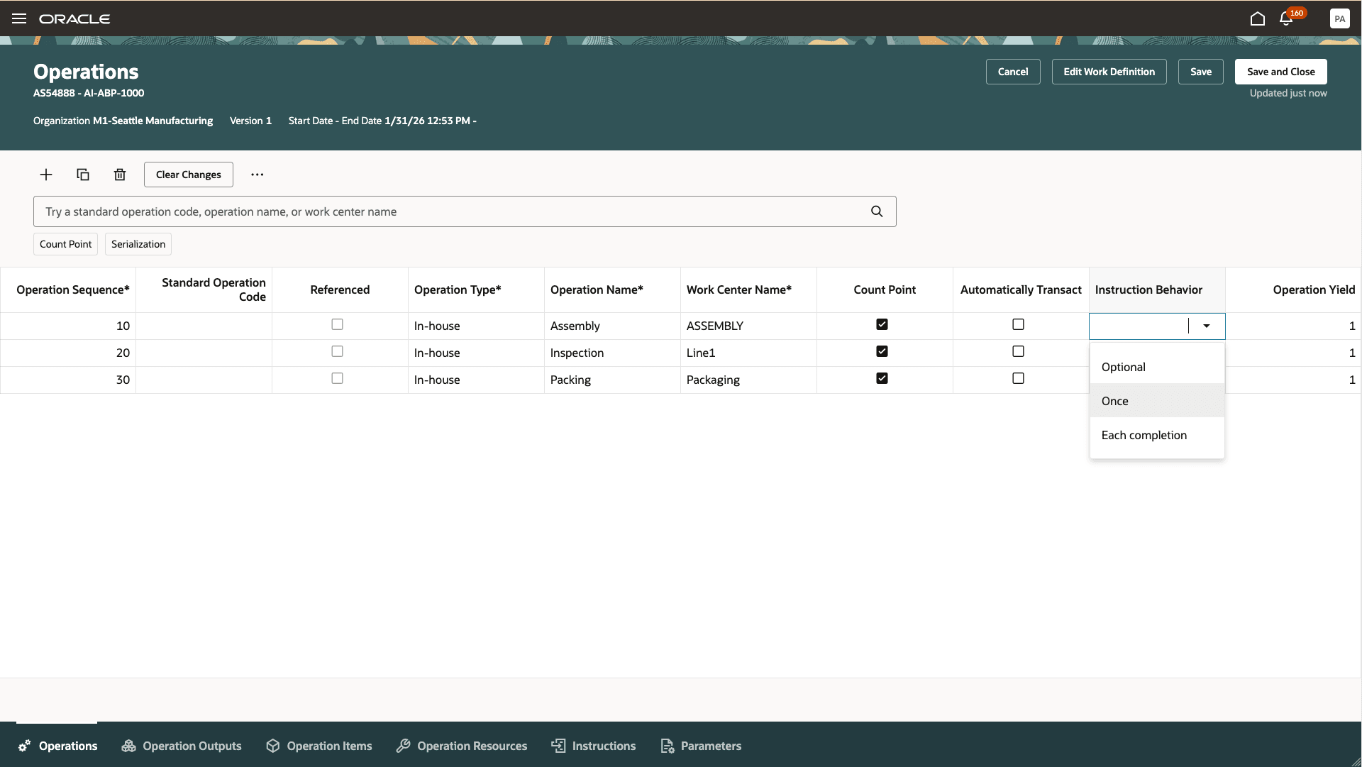

With this update, manufacturing engineers can set the instruction enforcement behavior for each operation. The following settings are available:
- Optional - Instructions are available during execution, the operator can complete them optionally. This is the universal behavior for all instructions before this update.
- Once per execution session - Instructions are mandatory for each execution session, which is a single Start to Stop cycle during production execution. You can report multiple transactions after completing the instructions.
- For Every Completion - Instructions are mandatory for each quantity reporting event. Select this option if you want the steps to be enforced every time an operation is transacted.

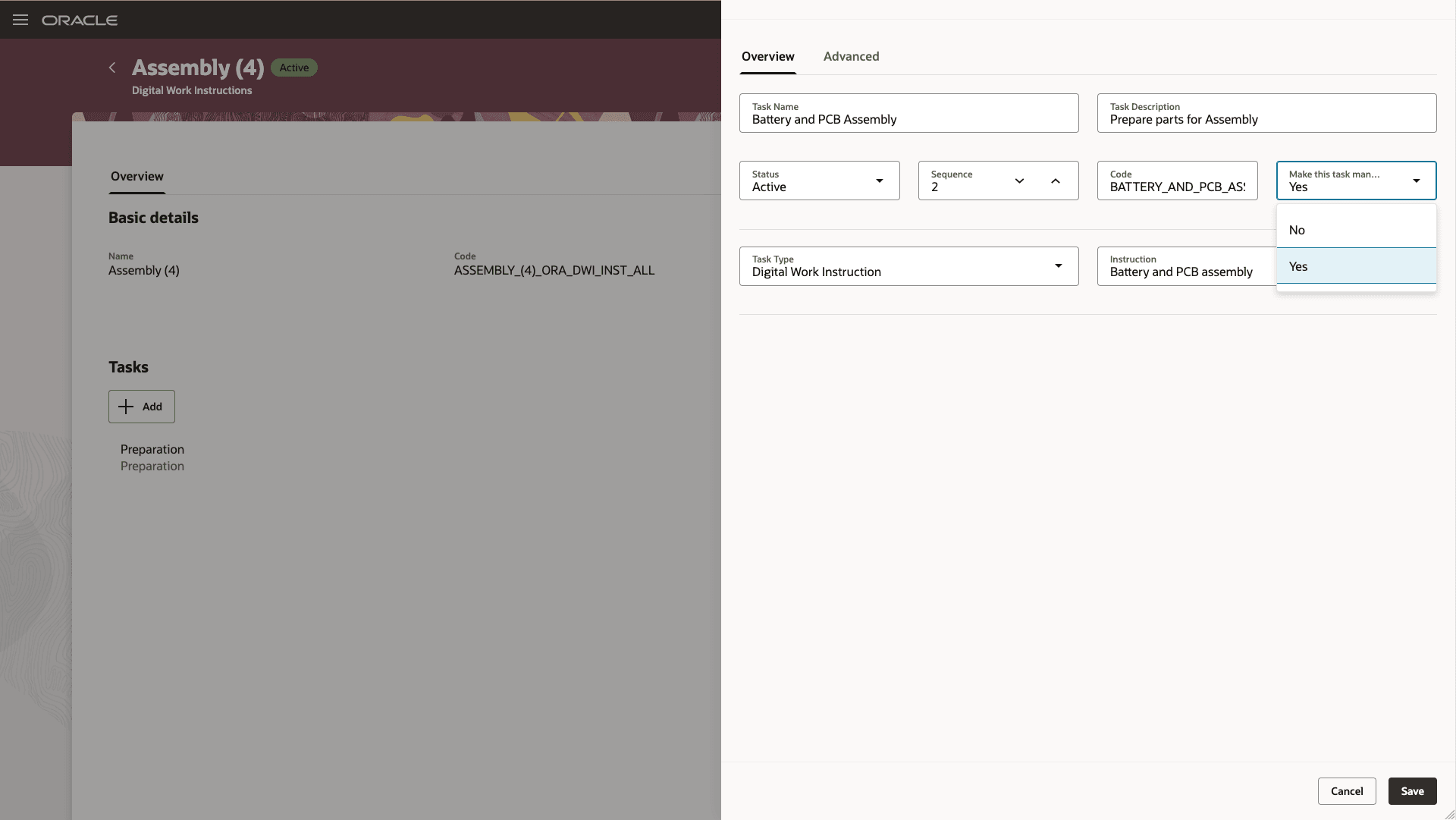

When you create a digital work instruction task using journeys, each step is marked as 'Mandatory' by default. If you disable this, then users can skip steps for optional or mandatory instructions.

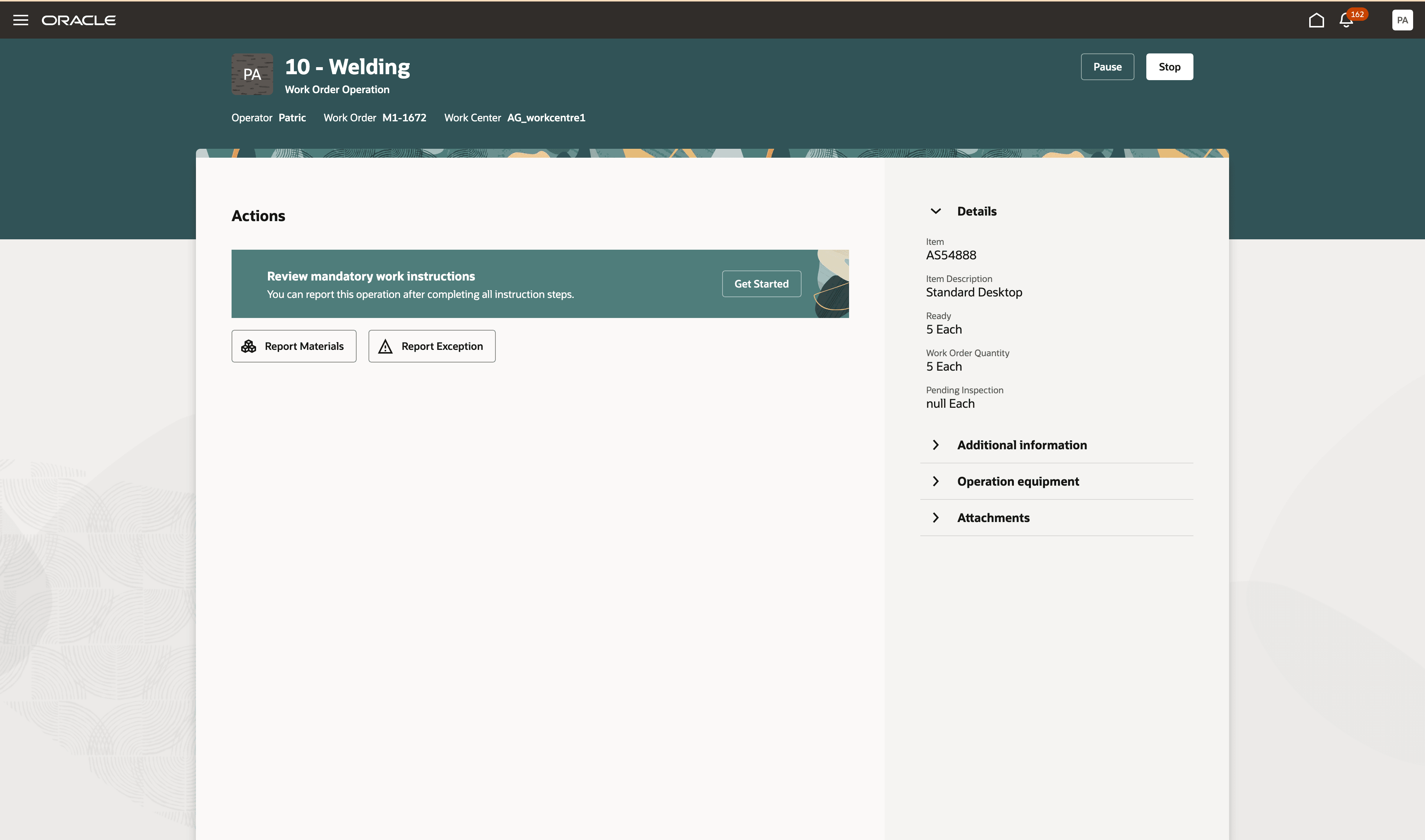

When the Operator executes an operation that is set to Once or Each Completion, and if there are tasks defined for the instruction steps, then the operator must complete these steps to proceed with transaction reporting.
Select Enforcement Behavior
Making Tasks Mandatory
Instructions Mandatory During Production Execution

- You can independently choose tasks to be mandatory. This is to specify which steps must be completed to complete the instruction.
