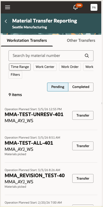

Workstation transfers are used to move picked materials from the staging location to the workstation subinventory. For work order operations assigned to a workstation with an associated supply subinventory, the picked materials in staging are available for transfer to that workstation. The following screenshot shows the Workstation Transfers page which enables the transfer of materials from the staging subinventory to the associated workstation subinventory.
Workstation Material Transfer
Workstation Transfers Page Lists the Operations Assigned to the Workstation

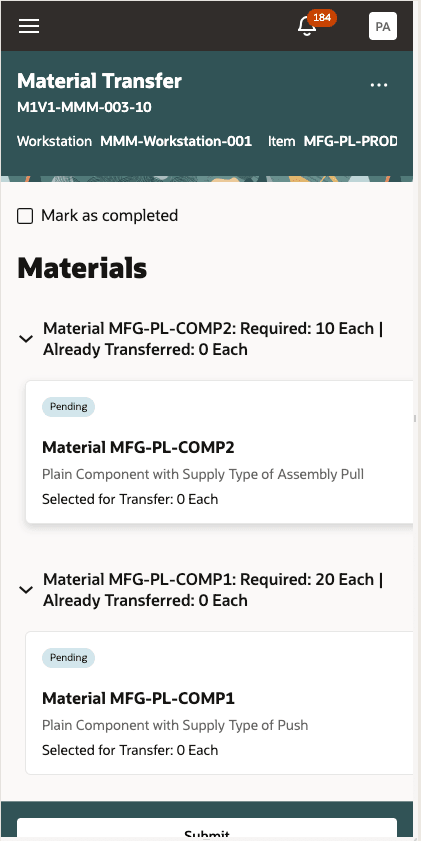

The following screenshot displays the list of materials for the selected operation, including the required quantity and the quantity already transferred. Selecting a material card opens the material details and transfer options.
Workstation operation materials list
List of Materials to Transfer to the Workstation
The following screenshot shows the transfer details for the selected operation material, including the quantity to be transferred.
Transfer details
Transfer Details for Material to Be Transferred to the Workstation

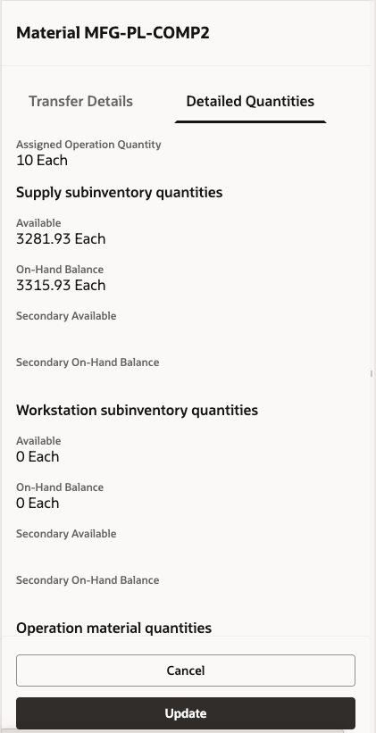

The following screenshot shows the quantity details that can be referenced when entering transfer information. It provides visibility into the assigned quantity and the quantity currently available in the supply subinventory.
Detailed Quantities
Quantity Details for Material to Be Transferred to the Workstation

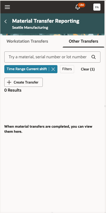

The following screenshot shows the Other Transfers option, which allows materials to be moved from the workstation subinventory back to the staging subinventory.
Other Transfer
Other Transfers to Transfer Materials from a Workstation to the Staging Location

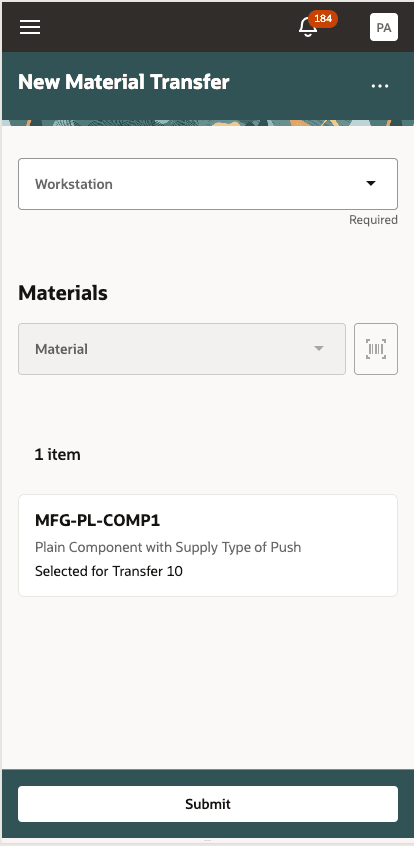

After the workstation, material, and quantity details are entered, the materials can be transferred back to the staging subinventory.
Select Workstation and Quantity to Transfer
New Material Transfer to Capture the Details of Materials to Be Transferred from the Workstation Subinventory to the Staging Location

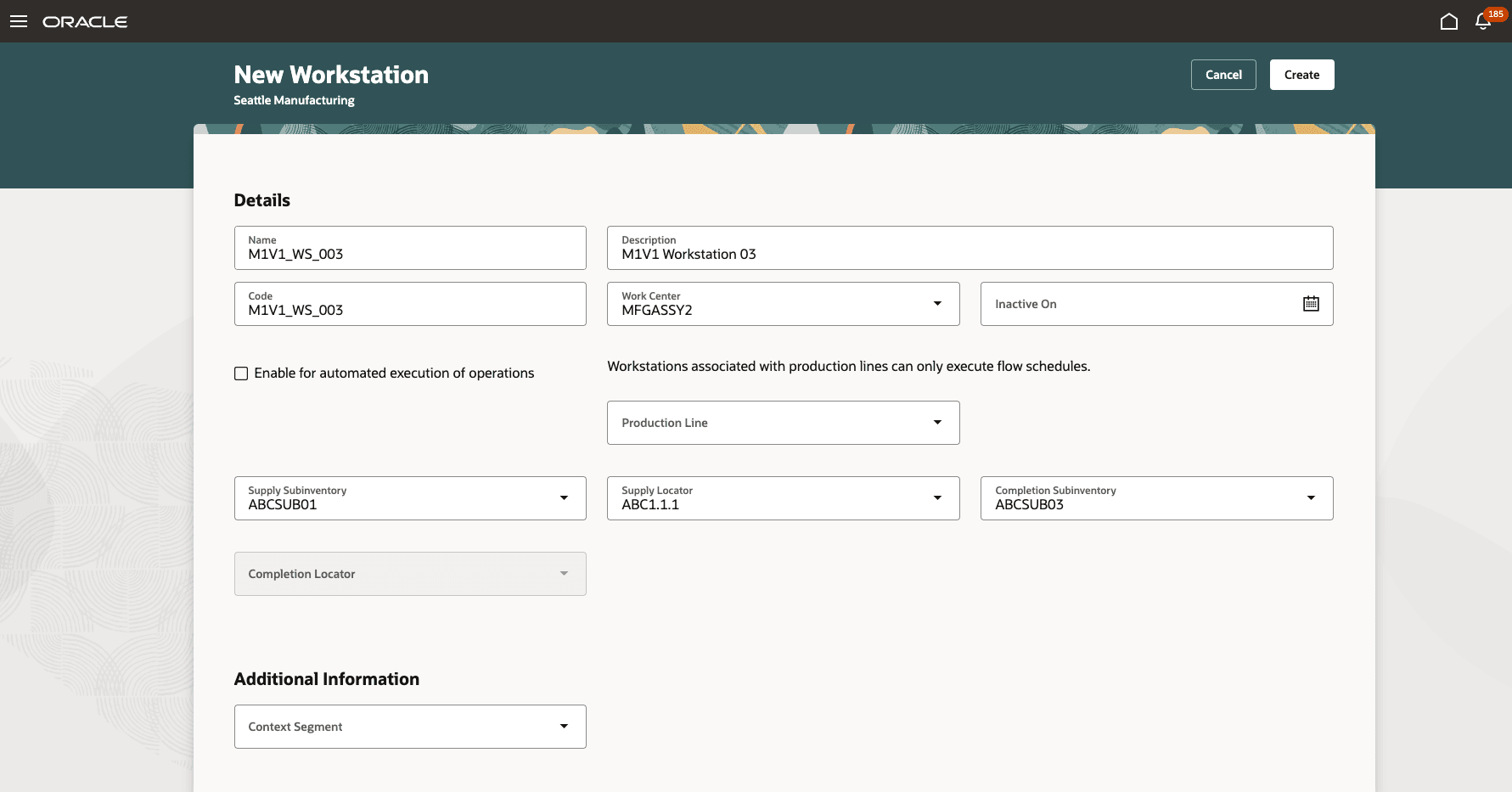

Configure the workstation with its supply and completion subinventories, so that operations assigned to the workstation are displayed.Define workstation subinventory
