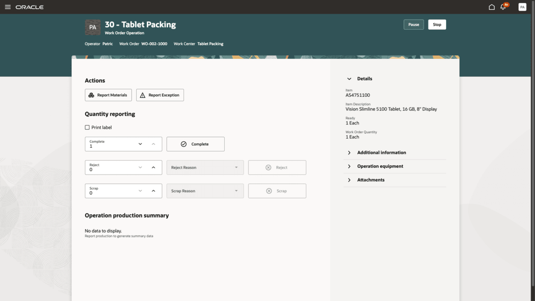

- Operators can start, pause (with reason codes), and resume work order operations in flows that do not use workstations.

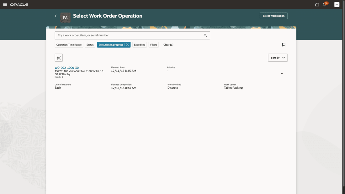

- Operators can search for and resume in-progress operations that they had started directly from the work order operations selection page.

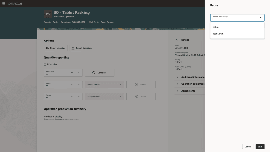

Select Pause to Pause Work Order Operation Execution
Select a Reason for the Pause
Select and Resume an In-Progress Work Order Operation

- A valid reason code must be selected when pausing operations—supported codes are those mapped to “idle” or “down” statuses.
