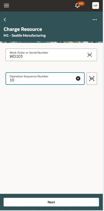

Sacn or enter work order and operation sequence and clcik Next
Scan or Enter Work Order and Operation Sequence

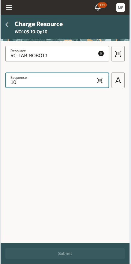

Sacn or enter resource and sequence
Scan or Enter Resource and Sequence

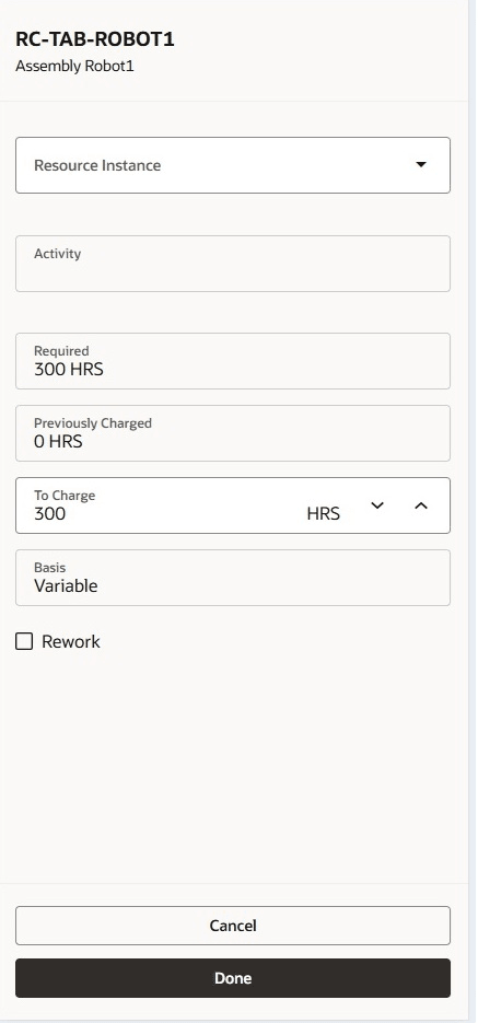

Enter resource details like quantity, basis etc and click Done
Enter Resource Usage Details

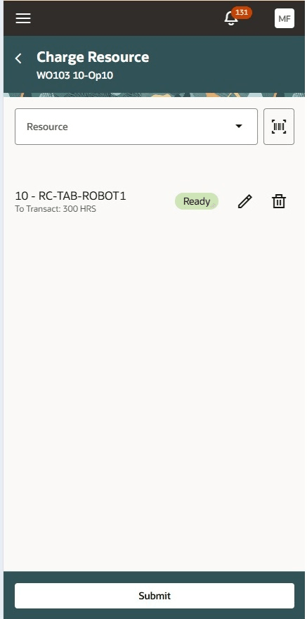

Clcik Submit
Click Submit

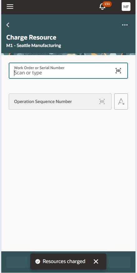

The resource is charged and teh confirmation message is dispalyed
Resource is Charged and a Confirmation Message Appears
