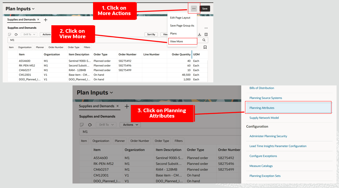

To access the Planning Attributes page:
  1. Click the More Actions (...) icon.
  2. Click View More.
  3. Click Planning Attributes in the Plan Inputs section.
The Planning Attributes page opens in a new browser tab

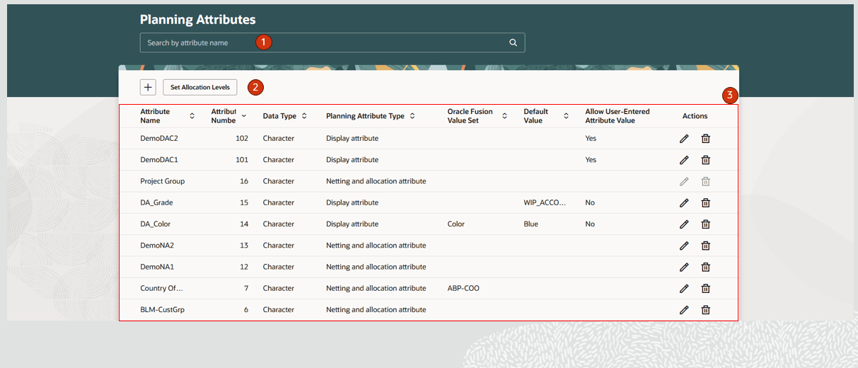

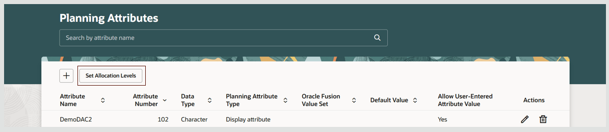

The Planning Attributes page contains the following:
  1. Keyword search - Lets you search across the Planning Attributes page. You can search by attribute name. The search is case insensitive and uses the contains operator.
  2. Action toolbar - Lets you create planning attributes and set allocation levels.
  3. Planning Attributes table - Displays planning attribute details. The details displayed are:
  • Attribute Name – Name of the planning attribute.
  • Attribute Number – Attribute number assigned to the planning attribute during the Create process.
  • Data Type – Data type of the planning attribute – Character or Number.
  • Planning Attribute Type – Netting and allocation attribute or Display attribute.
  • Oracle Fusion Value Set – Name of the value set associated to the planning attribute. Used to collect attribute values from Oracle Fusion Cloud SCM.
  • Default Value – Default value for a display attribute for which Allow User-Entered Attribute Value is No.
  • Allow User-Entered Attribute Value – Yes or No. Applicable for Display attributes.
  • Actions – Edit a planning attribute and its mapping. Delete a planning attribute.

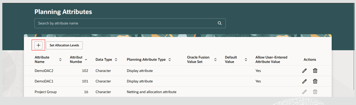

Create Planning Attribute
To create a planning attribute:
  1. Click the Add (+) button on the Planning Attributes page.
Create a Planning Attribute
  1. A New Planning Attribute page opens in the same tab.
  2. Provide a planning attribute name, select the planning attribute type, select an Oracle Fusion Value Set, and select a Data Type. Some of the options vary based on the planning attribute type selected.

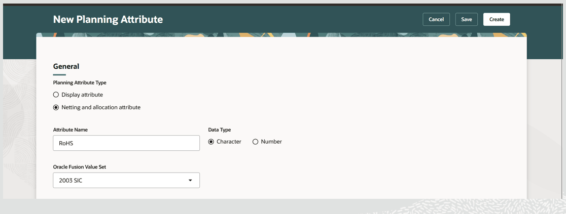

    • To create a Netting and allocation attribute:
a. For Planning Attribute Type, select Netting and allocation attribute.
b. For Data Type, select Character or Number.
c. If you’re collecting planning attribute values from Oracle Cloud SCM, select the appropriate Oracle Fusion Value Set name from the list of values.
Create a Netting and Allocation Planning Attribute

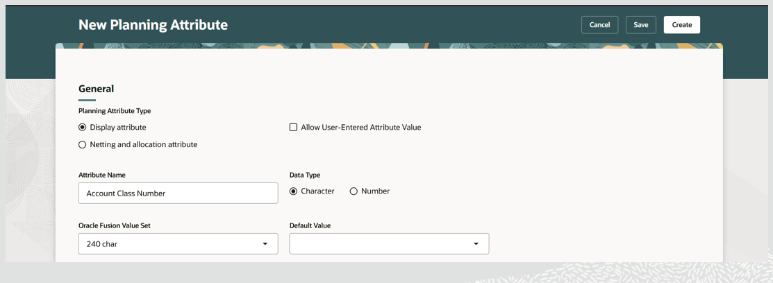

  • To create a Display attribute based on a list of values:
a. For Planning Attribute Type, select Display attribute.
c. If you’re collecting planning attribute values from Oracle Cloud SCM, select the appropriate Oracle Fusion Value Set name from the list of values. The Default Value for the planning attribute in edit mode can be selected only after running data collections for planning attribute values..
d. Leave the Allow User-Entered Attribute Value checkbox unselected.
Create a Display Planning Attribute Based on List of Values

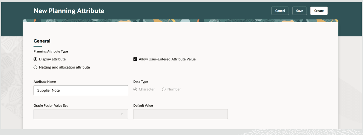

  • To create a Display attribute based on user-entered attribute values:
b. Select the Allow User-Entered Attribute Value checkbox. The Data Type then defaults to Character and can’t be changed.
Create a Display Planning Attribute Based on a User-Entered Attribute Value
  1. Click Create.
The planning attribute is created and is now displayed on the Planning Attributes page.

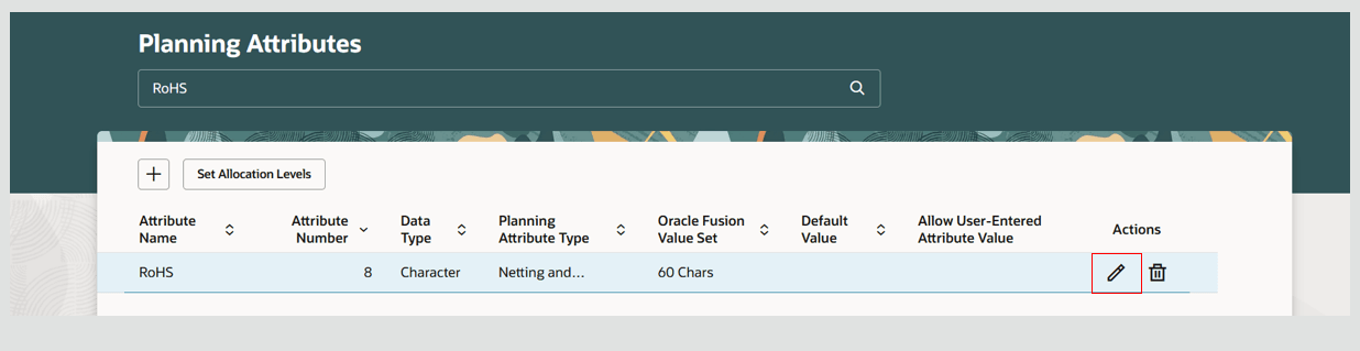

Edit Planning Attribute
To edit a planning attribute:
  1. Click the Edit icon in the Actions column.
  2. The selected planning attribute is opened for editing in the same tab.
  3. Make your desired changes directly in the table cells and then click Save.
  4. When you’re done making changes, click Update to save all the changes and return to the Planning Attributes page.

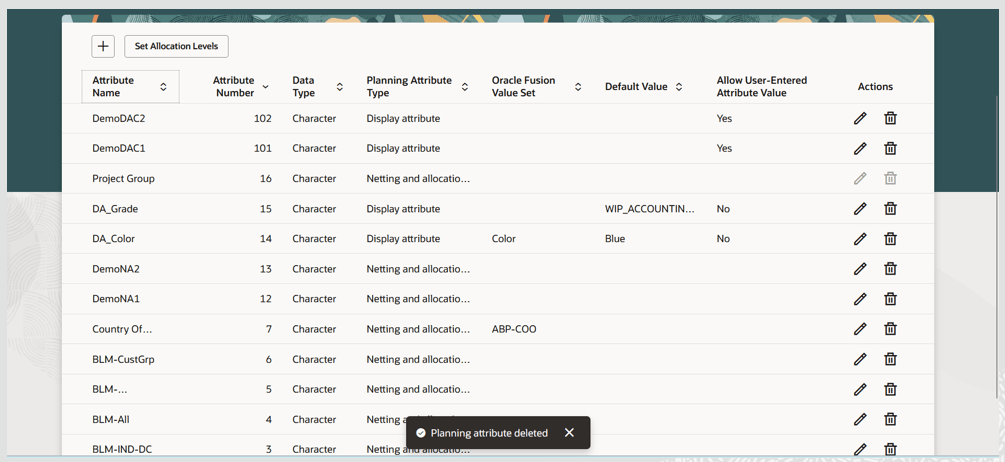

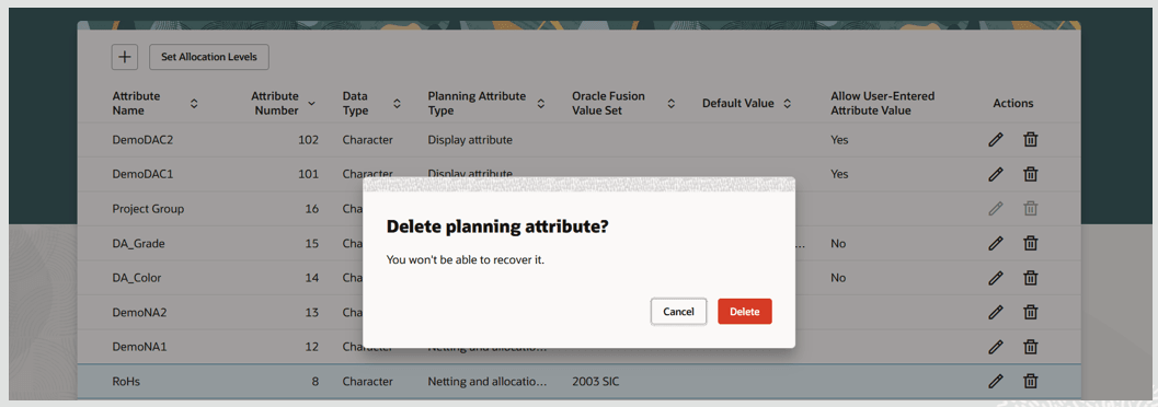

Delete Planning Attribute
To delete a planning attribute:
  1. Click the Delete icon in the Actions column.
  2. A confirmation message is displayed. Click the Delete button to confirm that you want to delete the planning attribute.
  1. The system performs some validations.  If the validations are successful, then the planning attribute is deleted. If the validations aren’t successful, then an error message is displayed. You must resolve the errors to successfully delete the planning attribute. Refer to the “Validations for Deleting a Planning Attribute” section later in this document
  2. Once the deletion is successful, a final confirmation message is displayed.
Confirmation Message Displayed After Planning Attribute Is Deleted

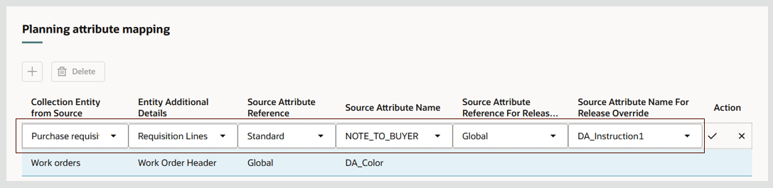

Planning Attribute Mapping
Planning attribute mapping is required if you’re collecting attribute values for supplies and demands from Oracle Cloud SCM.

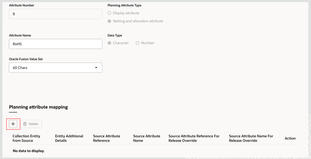

To create or edit planning attribute mapping:
  1. In the Planning attribute mapping section, click the + icon.
Create Planning Attribute Mapping

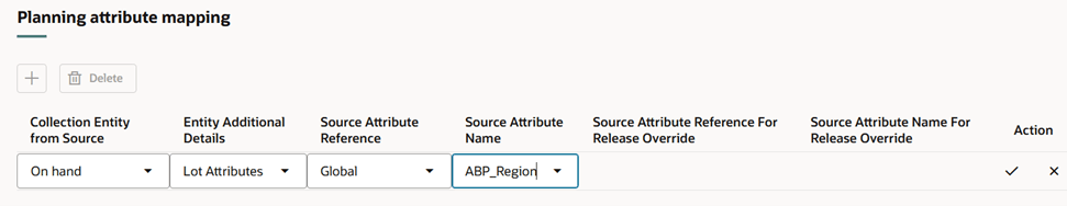

  1. Select an option from the list of values for Collection Entity from Source, its associated Entity Additional Details, Source Attribute Reference, and Source Attribute Name. Then click on the check mark.
Add Attribute Mapping for an Entity
  • The Source Attribute Reference For Release Override and Source Attribute Name For Release Override fields can be selected only if it’s a purchase requisition entity and the source attribute name is NOTE_TO_BUYER, NOTE_TO_SUPPLIER or NOTE_TO_RECEIVER.
Add Source Attribute Reference for Release Override Details

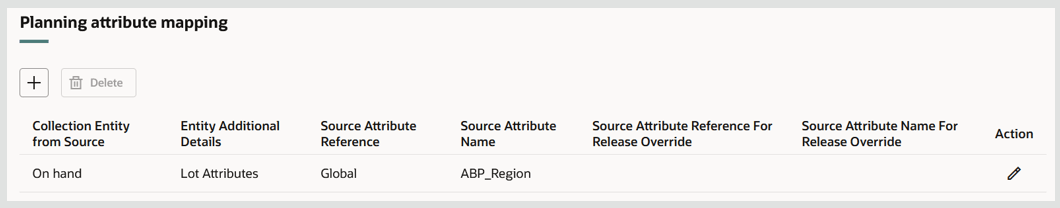

  1. The Planning attribute mapping is added.
Planning Attribute Mapping Added

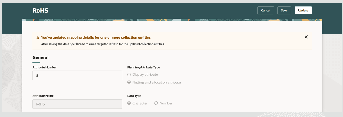

  1. Review the message displayed, which informs you that after saving changes planning attribute mappings, that you’ll need to run targeted collections for selected entities to collect entity details with planning attribute values.
  2. Click Save to save the mapping. You can continue to add another mapping or edit planning attributes. When done, click Update to save the changes and return to the Planning Attributes page.

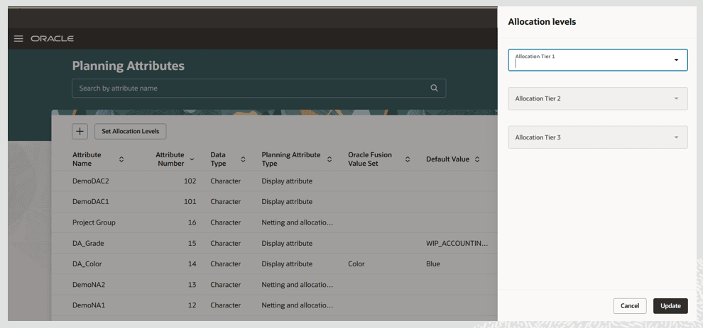

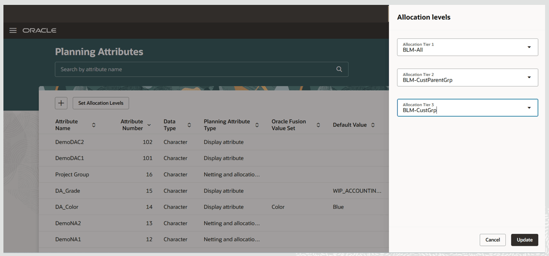

Set Allocation Levels
To configure planning attributes as allocation levels for Global Order Promising and Backlog Management:
  1. Click the Set Allocation Levels button on the Planning Attributes page.
  1. The Allocation levels drawer opens.
Allocation Levels Drawer
  1. Select netting and allocation attributes for the allocation tiers. You can select an attribute for any of the following combinations:
  • Allocation Tier 1
  • Allocation Tier 1 and Allocation Tier 2
  • Allocation Tier 1, Allocation Tier 2 and Allocation Tier 3
You must always start with Allocation Tier 1, followed by Allocation Tier 2, and then Allocation Tier 3.
Select Planning Attribute for Allocation Level
  1. Click Update to save the allocation levels.
When you attempt to delete a planning attribute, the system performs the following validations:
  • Planning attribute shouldn’t be assigned to a netting rule.
  • Planning attribute values shouldn’t be available in collected data.
  • Netting and allocation attribute values shouldn’t be available in plan data.
  • Planning attribute shouldn’t be assigned to any allocation tier in Set Allocation Levels.
  • Planning attribute shouldn’t be assigned within a demand priority rule.
  • Planning attribute dimension shouldn’t be used in a measure.
