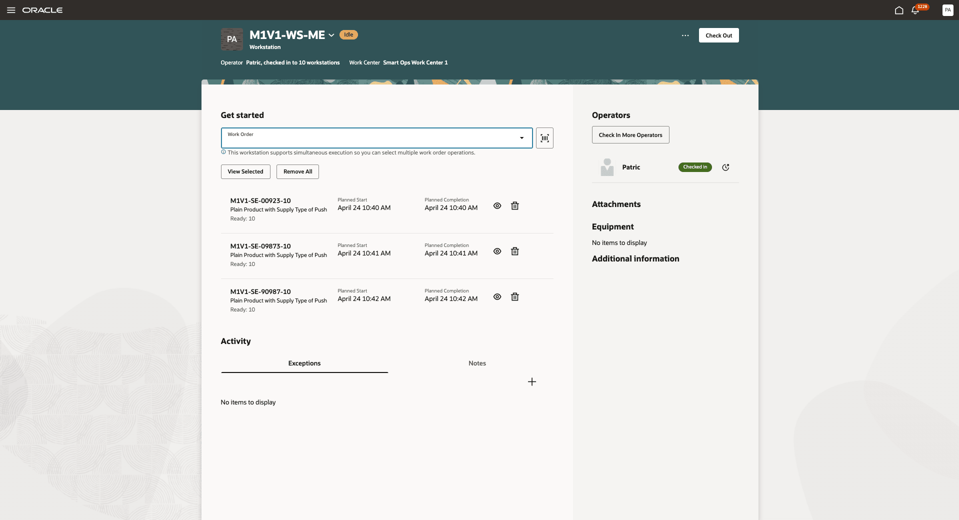

You can select multiple operations for execution on a workstation where simultaneous execution is enabled.View Work order operations
Select Multiple Operations on a Workstation Enabled for Simultaneous Execution

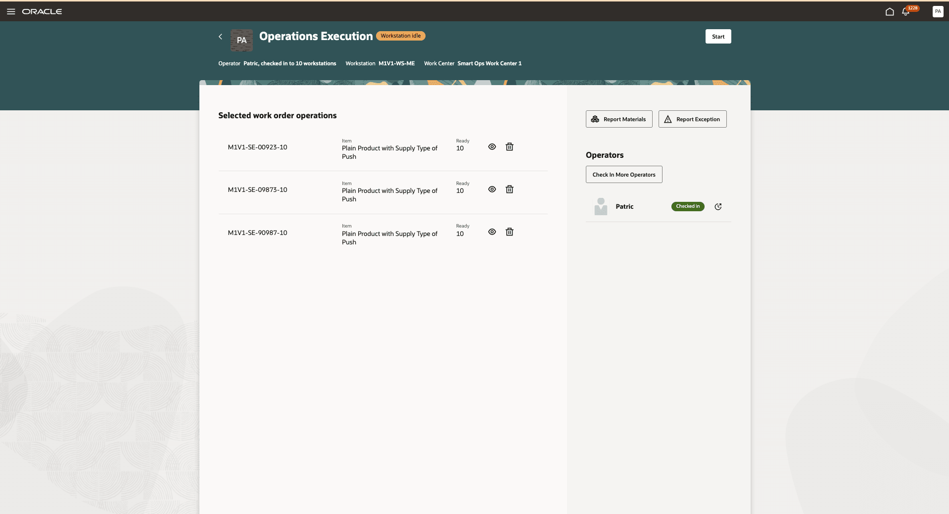

You can then view the operations selected for simultaneous execution at a workstation and click Start to begin execution for all selected operations.
View Operations selected to execute simultaneously.
View Operations Selected for Simultaneous Execution

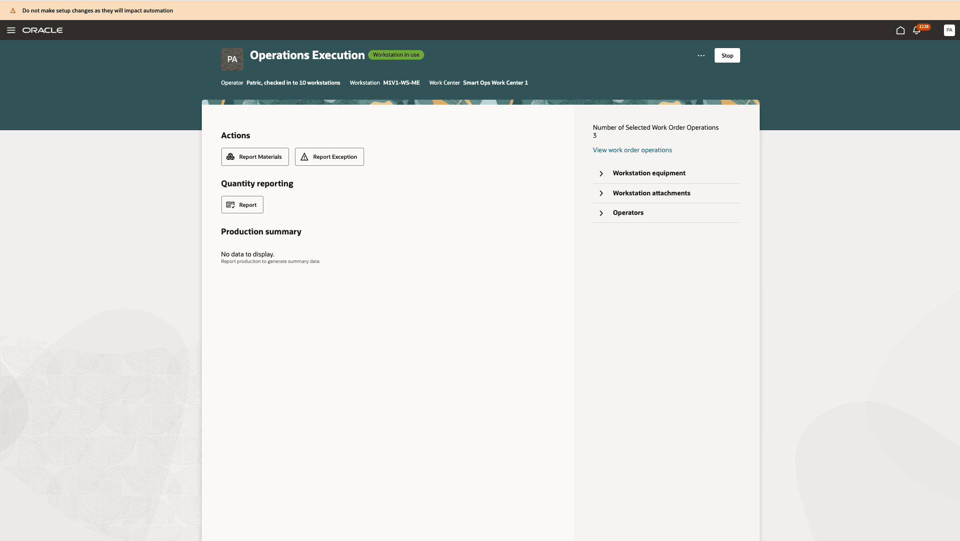

Execution starts for the selected operations at the workstation, as shown in the following screenshot:
Operation execution for multiple operations.
Execute Multiple Operations Simultaneously

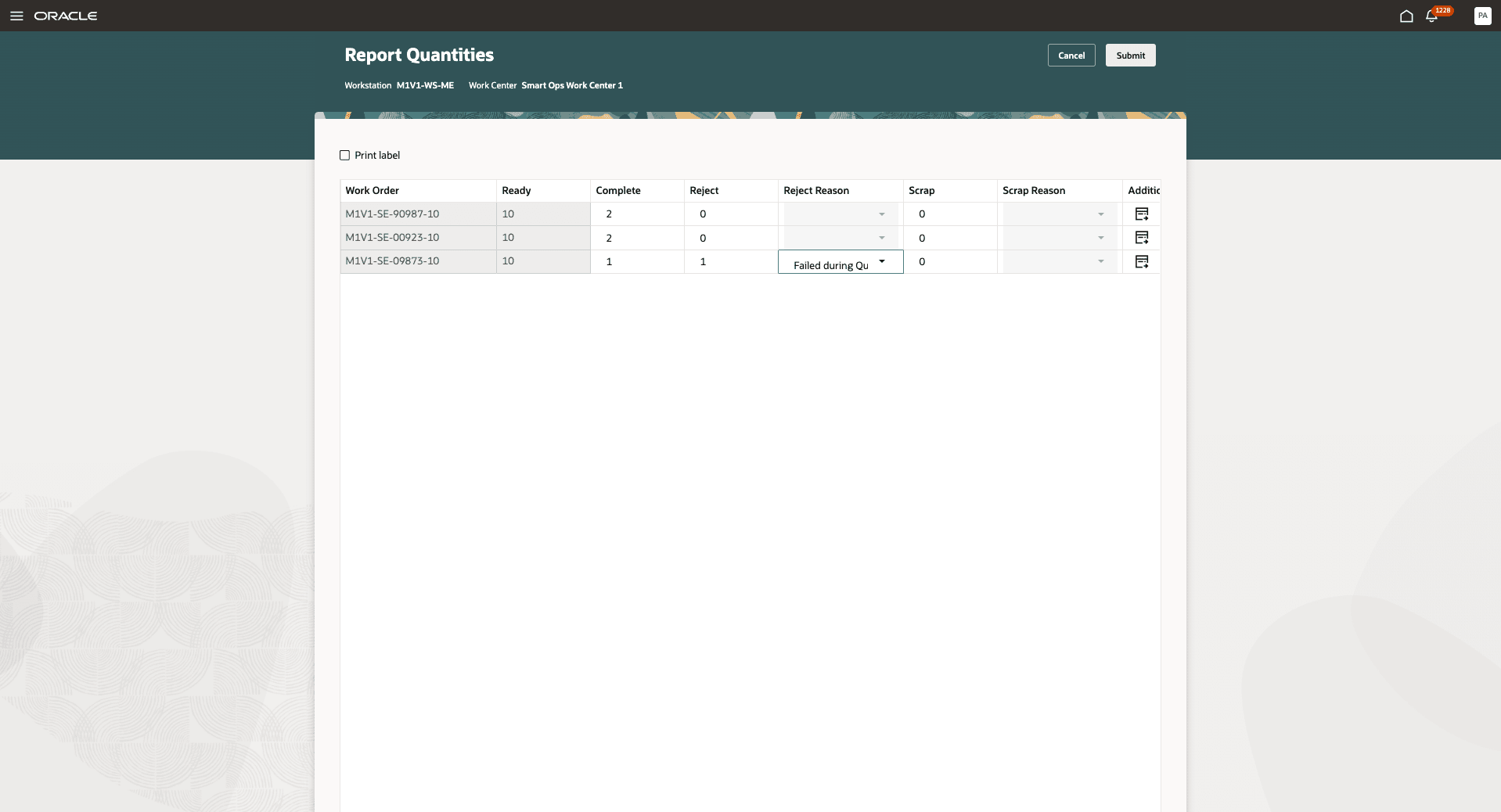

You can then report quantities for multiple operations using a single Report Quantities page, as shown in the following screenshot:
Report Quantities for Multiple Operations.

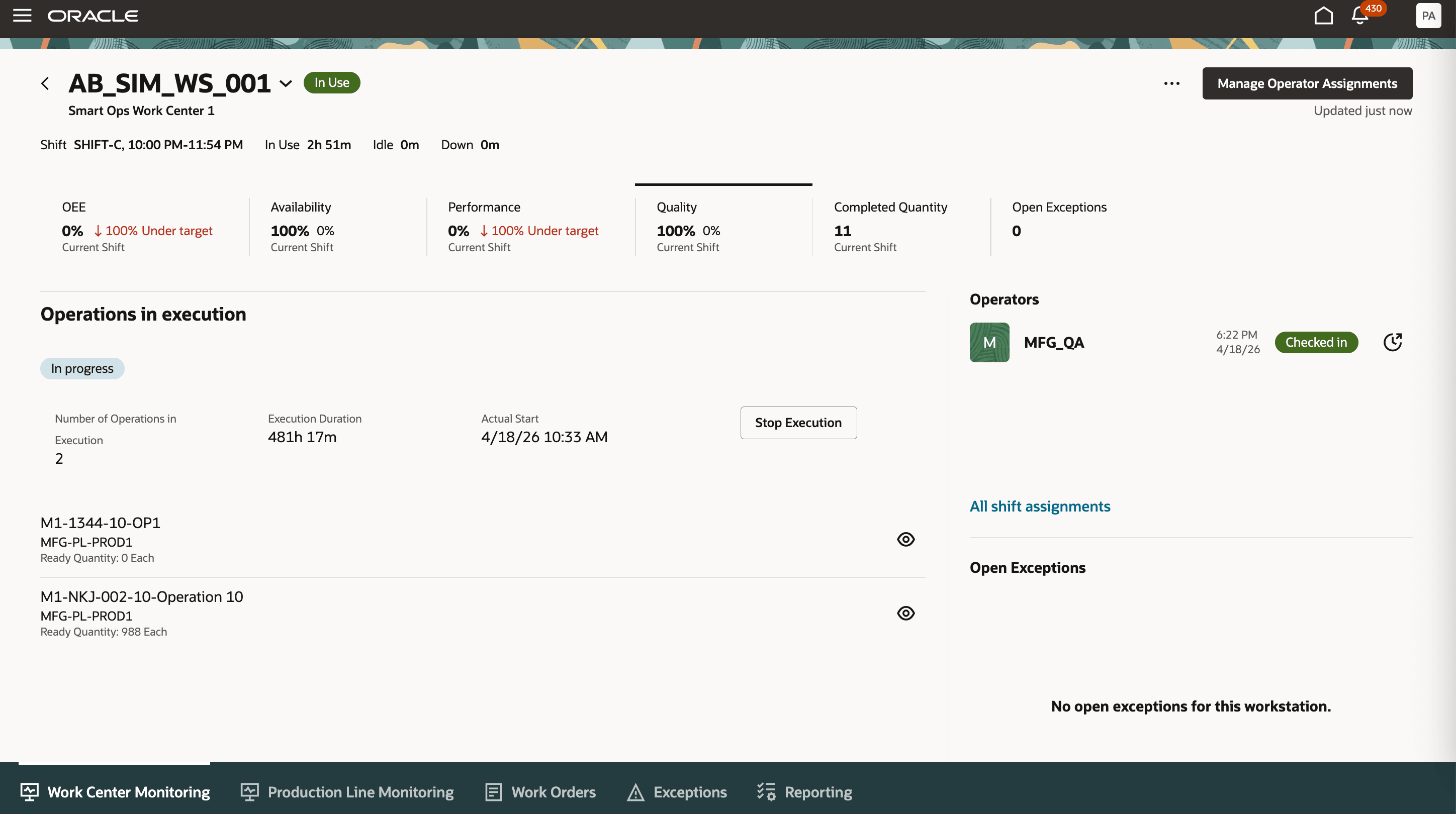

Supervisors can view the list of operations running at a workstation enabled for simultaneous execution. They can also drill down into an operation to view detailed execution information.
The following screenshot shows the list of work order operations currently running at a workstation:
View Operations Running at a Workstation Enabled for Simultaneous Execution from Production Supervision

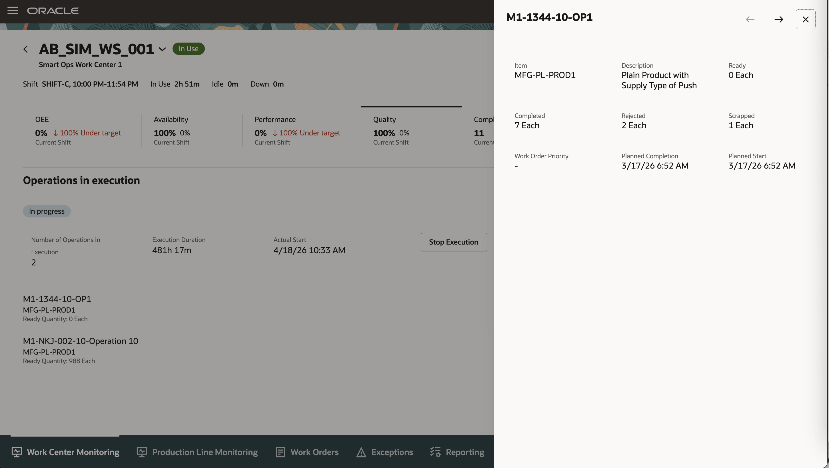

The following screenshot shows the execution details for one of the work order operations currently running at the workstation:
View Execution Details of an Operation
View Execution Details of a Work Order Operation

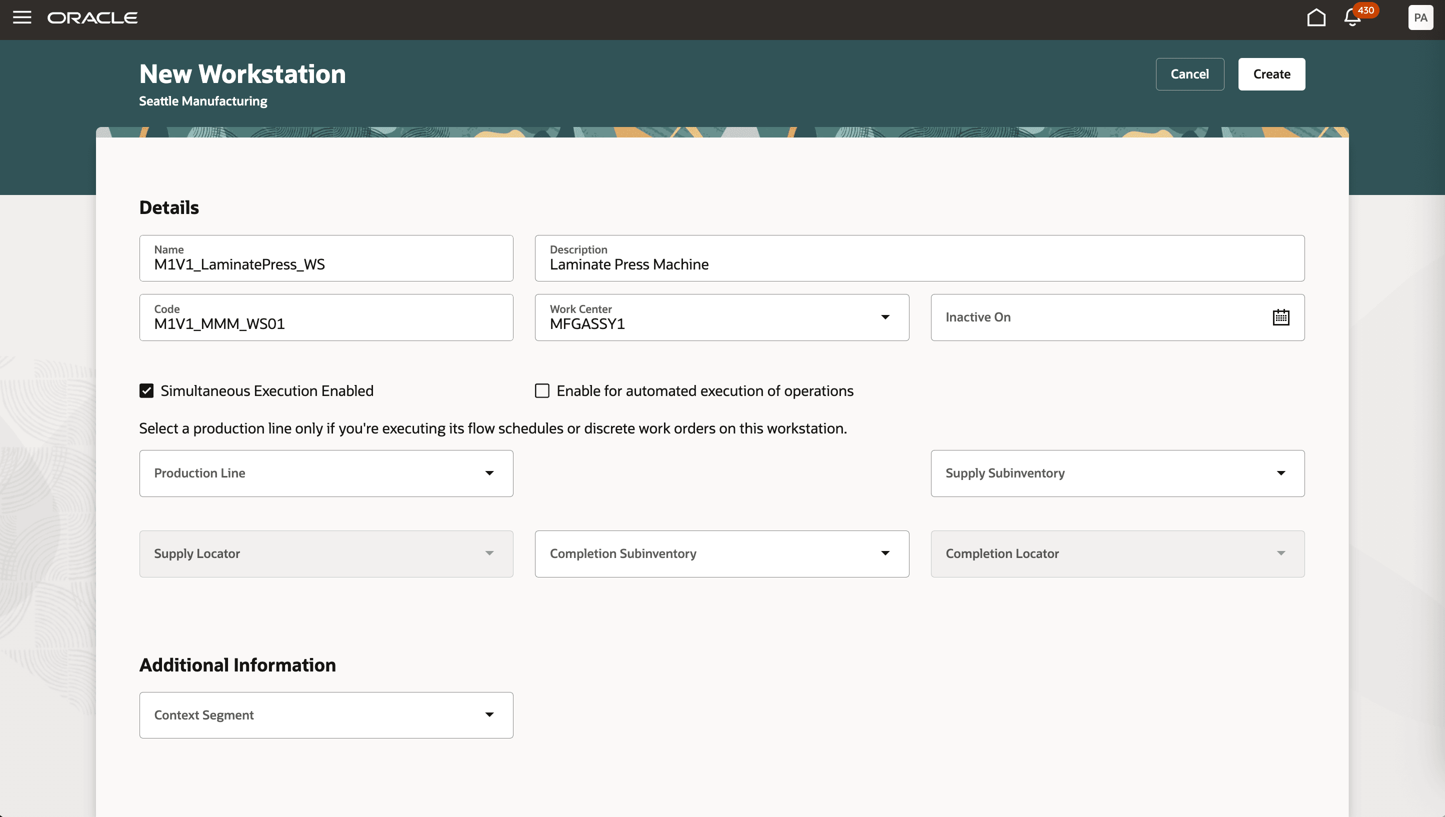

To create a workstation enabled for simultaneous execution, navigate to Supply Chain Execution > Work Definition > Workstations, create a new workstation, and enable the Simultaneous Execution Enabled option for the workstation.
The following screenshot shows the Simultaneous Execution option when creating a workstation. A workstation enabled for simultaneous execution cannot be part of a production line.
Create Workstation Enabled for Simultaneous Execution
Create New Workstation with Simultaneous Execution Enabled
