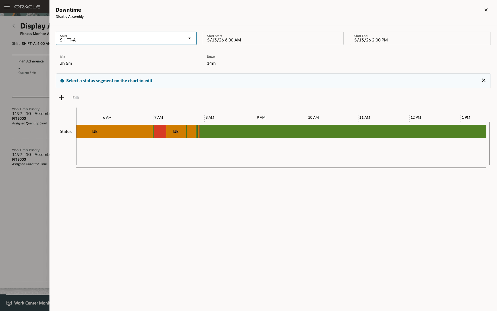

Production Supervisors
Production supervisors can now review and correct workstation availability records after production events have occurred. From the workstation availability timeline, supervisors can view all recorded segments, such as In-Use, Idle, and Down with their start times, end times, duration, and reason codes, and can correct downtime duration, update reason codes, or reclassify a segment status (for example, from Down to Idle) based on additional shop floor insights.
The application validates all edits against reported operation quantities and automatically adjusts adjacent segments to maintain timeline continuity, preventing gaps or overlaps. For example, if a downtime segment recorded from 10:00 to 11:00 is corrected to end at 10:30, the system automatically reclassifies the remaining 10:30–11:00 interval as an appropriate state. All confirmed changes trigger real-time recalculation of downtime totals and OEE.
Edit Downtime - Supervisor

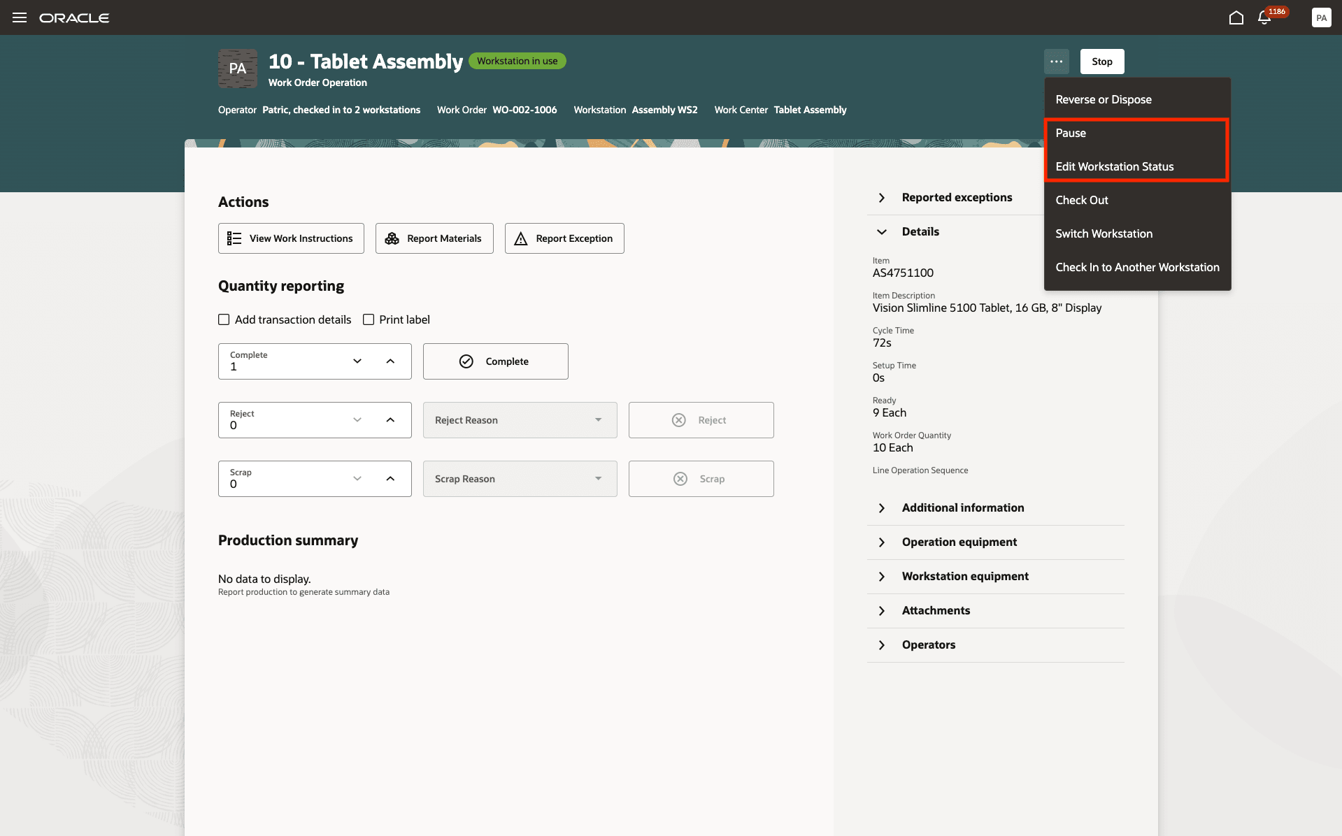

The high-level operator actions include pausing and resuming production execution, recording downtime details, and updating workstation status information.

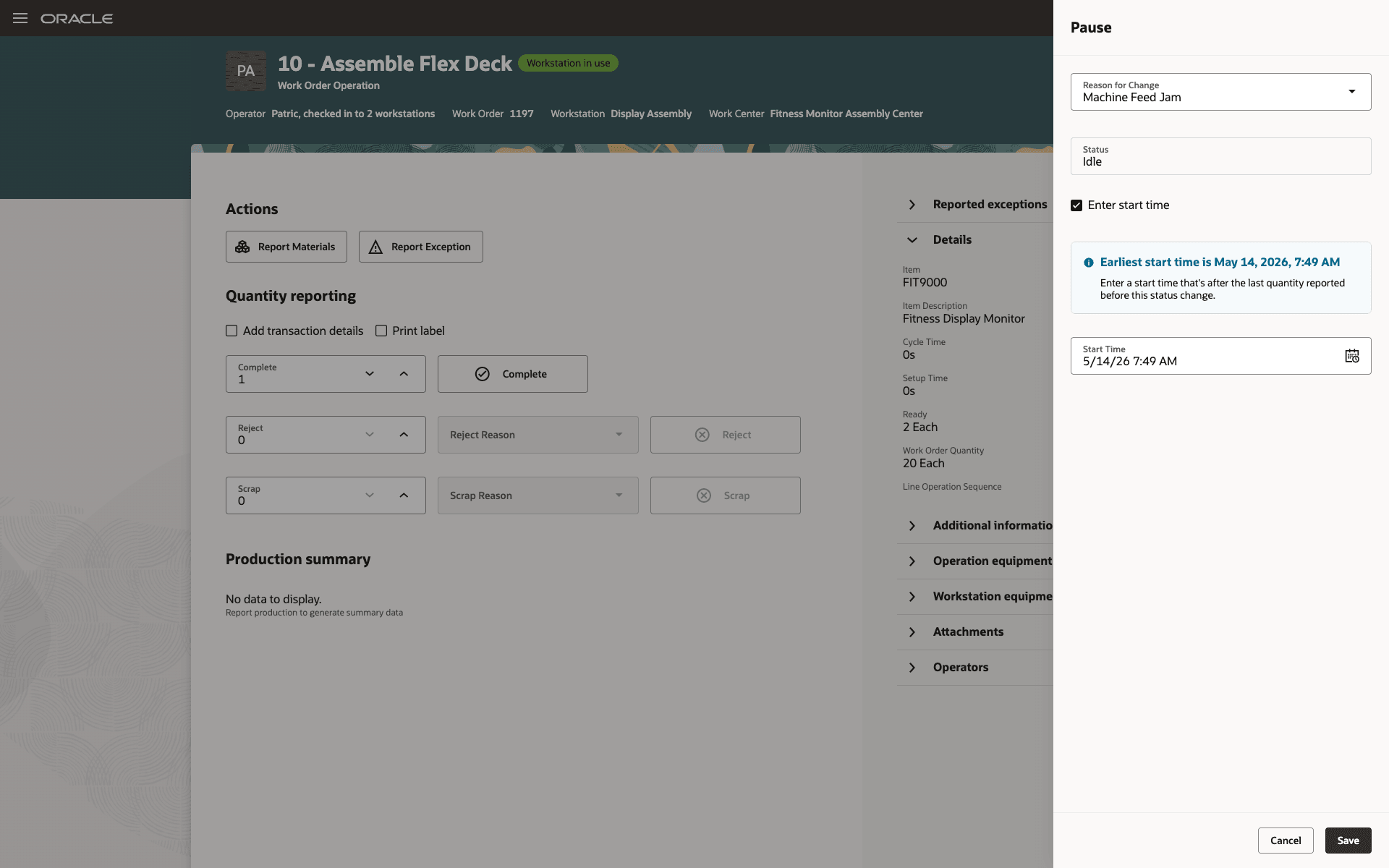

Pause
Operators can pause a workstation or operation by recording the appropriate downtime reason and status, and can optionally enter a custom start time if the downtime began earlier than when it was recorded. The application validates the entered time and updates workstation availability tracking in real time.
Pause Workstation - Operator

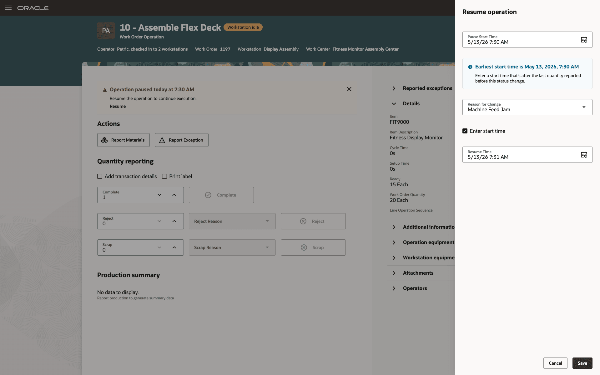

Resume
Operators can resume production after a downtime and record the actual time when execution restarted. This helps ensure workstation availability and production timelines accurately reflect shop floor activity.
Resume Workstation - Operator

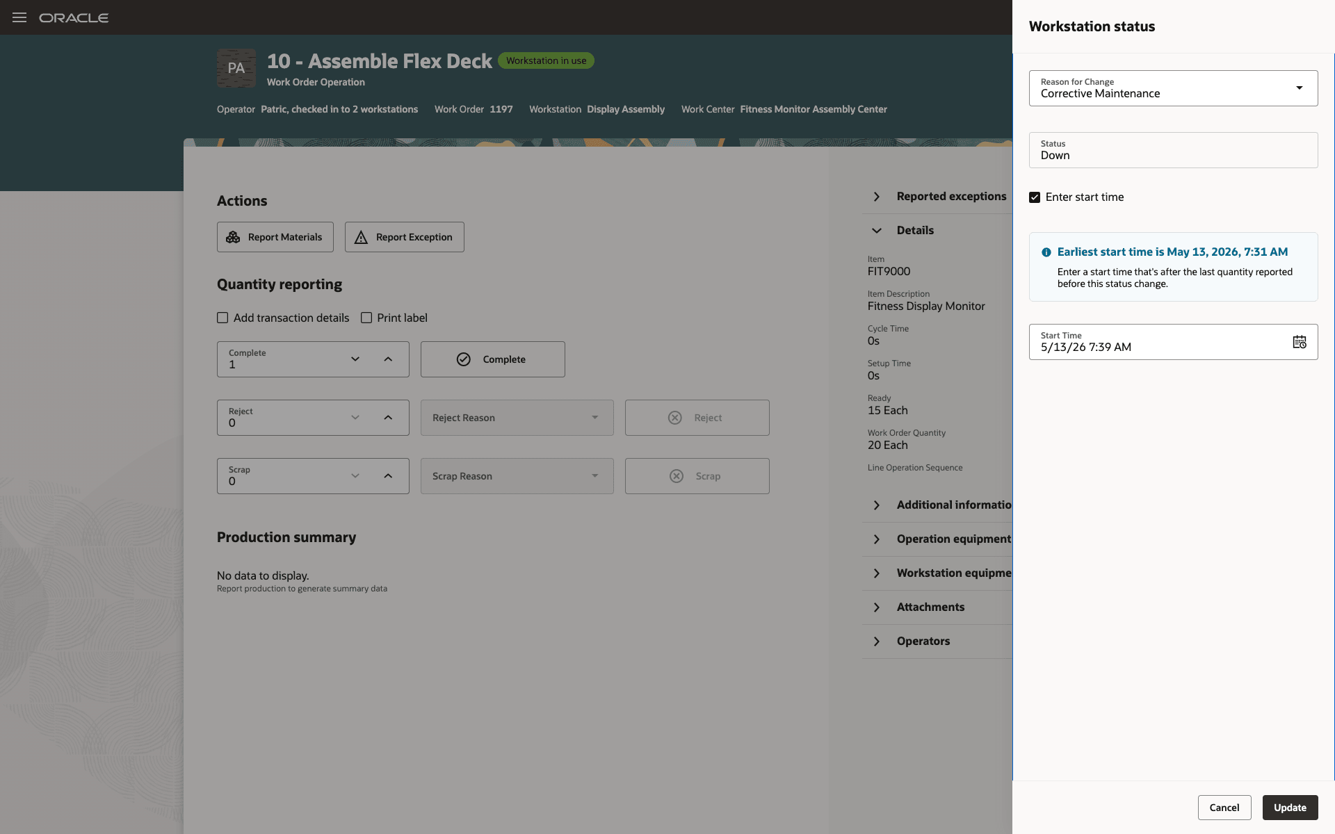

Edit Workstation Status
Operators and supervisors can update workstation status details when recorded information doesn’t match actual shop floor conditions. The application validates status changes and maintains a continuous workstation timeline across the shift.
Edit Workstation Status - Operator
