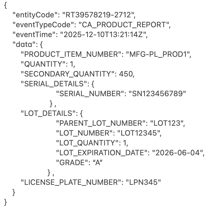

The connected equipment sends a dedicated "Product Report" (CA_PRODUCT_REPORT) event to report outputs that are configured for the manual completion type. The report can include the following outputs:
  • Primary product (Process work orders)
  • Co-products and by-products (Process and Discrete work orders, where applicable)
  • Ad hoc outputs (treated as by-products)
Events include item-level identification to determine the product being reported. This is important when a work order has multiple co-products and by-products. Additional attributes, such as lot and serial numbers, License Plate Number (LPN), secondary quantity, and grade are supported. Depending on the item setup, the following product attributes can be conditionally included:
  • Serial details: If the item is serial-controlled. One serial number allowed per event.
  • Lot details: If the item is lot-controlled. Lot number, parent lot number, lot quantity, expiration date, and grade can be provided.
  • Both lot and serial details: If the item is lot-serial controlled.
  • LPN (License Plate Number): If the completion subinventory is LPN-enabled.
  • Secondary Quantity: Secondary quantity, when configured.

Sample Product Report Event

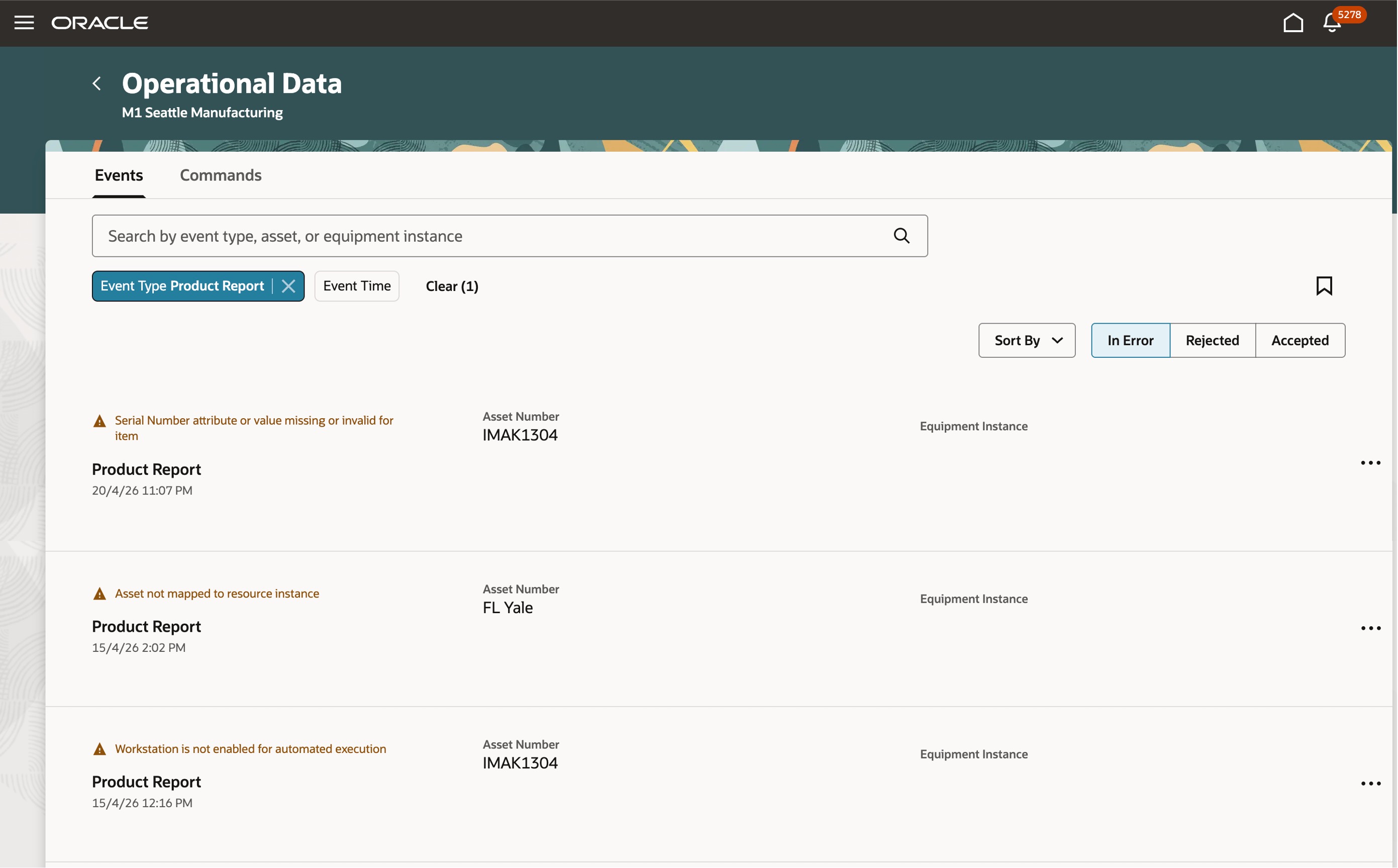

Supervisors can dispose events that are Invalid (missing required attributes like item/quantity) or In Error (missing required lot/serial/LPN details for controlled items). Failed and invalid events can be viewed under Operational Data.
View Events Operational Data

  • Events received from an equipment can be viewed in the Events tab using the "Operational Data" task in the Work Execution work area.
