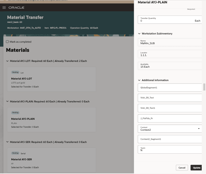

The following screenshot shows the option to capture additional information while transferring materials from staging to the workstation supply subinventory:
Provide Additional Information while transferring materials.
Provide Additional Information While Transferring Materials
This enhancement improves shop floor inventory management by allowing manufacturers to capture all required material movement attributes within a single transaction flow, reducing the need for additional manual updates or follow-up transactions.
