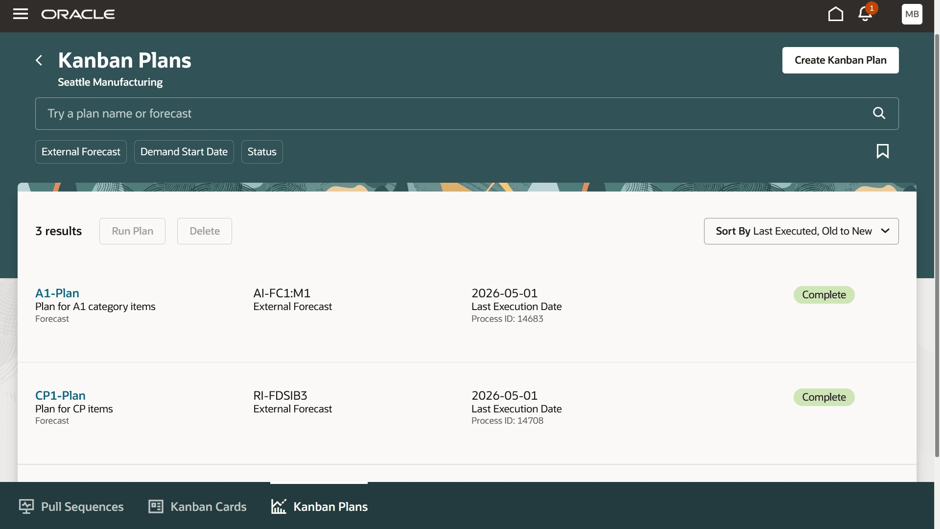

  • Invoke the new action 'Kanban Plans" to navigate to the Kanban plans summary page for defining the Kanban plan.
  • Create and run Kanban plans against an external forecast with optional filters for item and date from the Kanban Plans page.

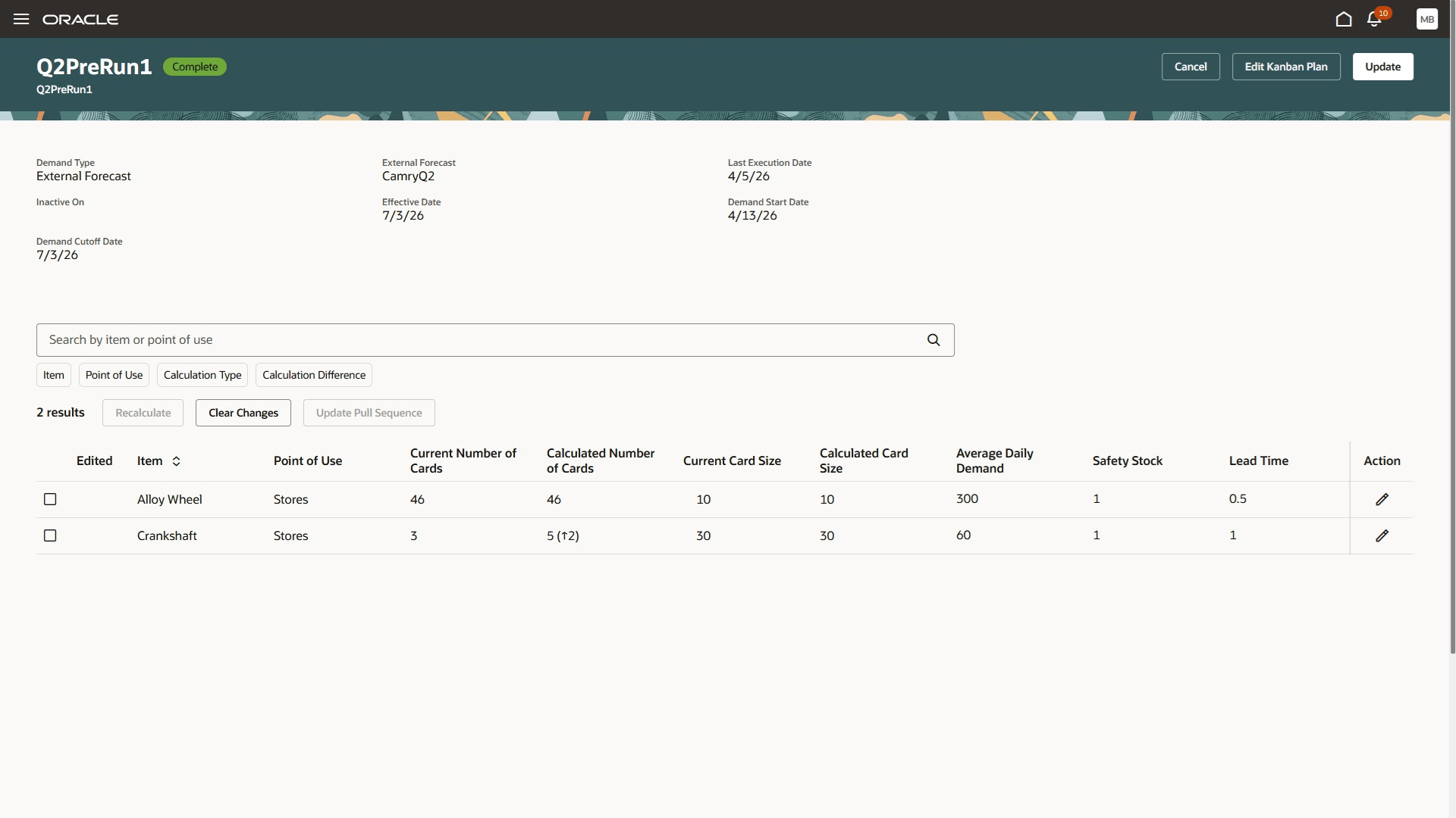

  • Calculate and review the average daily demand and the recommended number of cards or Kanban size per pull sequence, then recalculate after changes. The background scheduled process performs demand explosion through the work definition and applies order modifiers to calculate the Kanban size.
  • Mass load the average daily demand via the Oracle Visual Builder add-in for Excel and calculate the number of Kanban cards and their size.
  • Implement the calculated Kanban recommendations in the corresponding pull sequences using the "Update Pull Sequence" action in Kanban Plans.

Kanban plan summary page
Kanban Plan Summary Page
Kanban plan definition
Kanban Plan Definition
