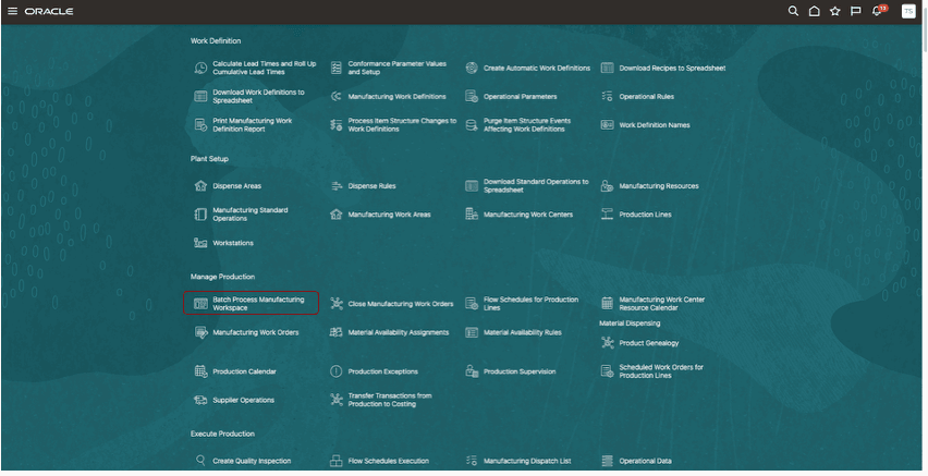

1. Access the Workspace
To access the workspace:
  1. Navigate to Supply Chain Execution.
  2. Under Quick Actions, select Show More to view the complete list of available actions.
  3. Select Batch Process Manufacturing Workspace under Manage Production.
Figure 1 : Quick action from Supply Chain Execution landing page
Quick Action to Access the Workspace

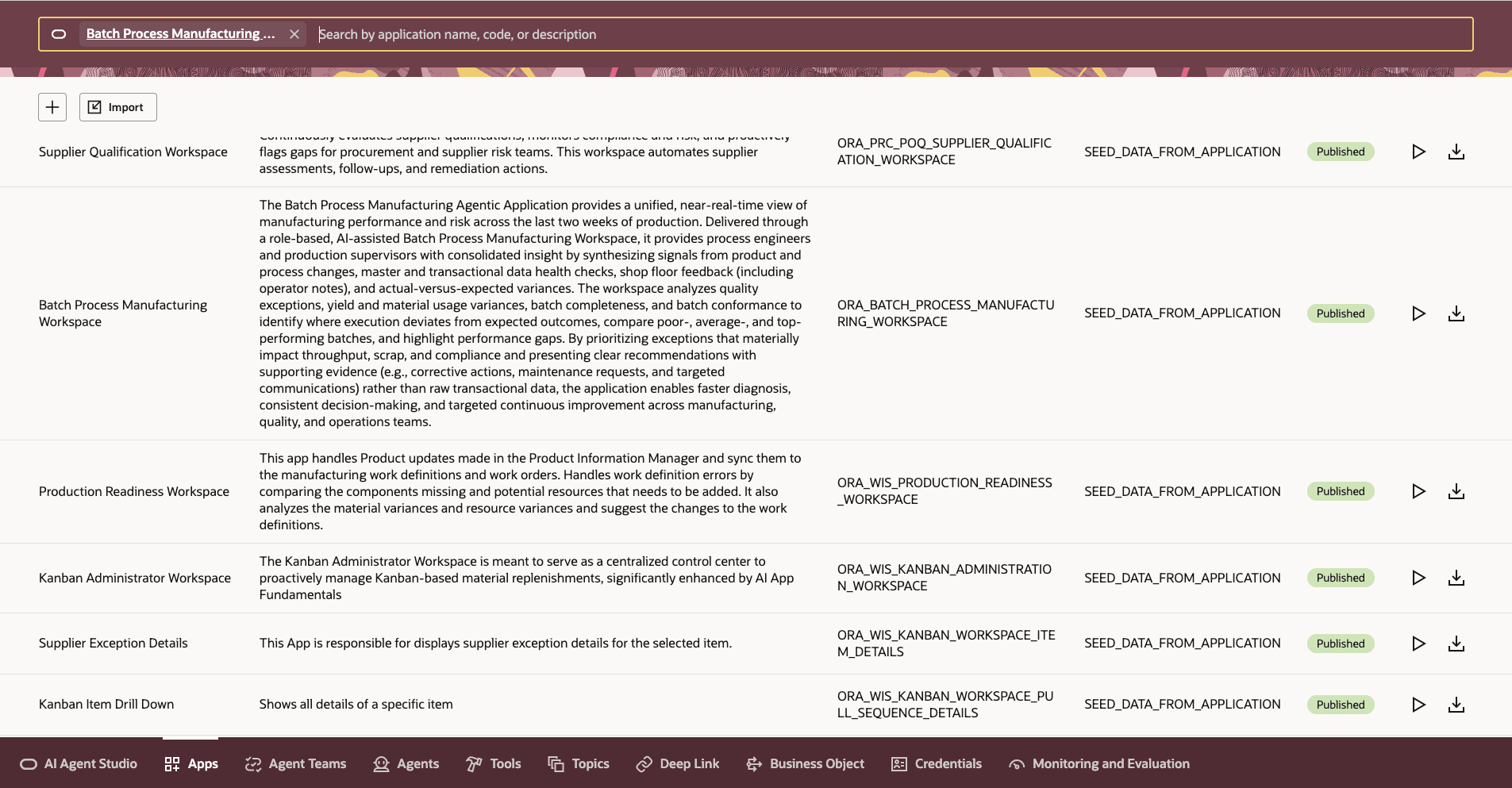

Alternatively, you can also access the workspace from AI Agent Studio:
Navigate to Tools, AI Agent Studio, Applications, and then select Batch Process Manufacturing Workspace.
Navigation Using AI Agent Studio

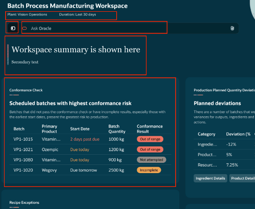

Workspace Structure
The workspace is organized into the following sections:
  1. Workspace Header – Displays the workspace title and navigation controls.
  2. Context Section – Displays the selected plant and analysis duration.
  3. Chat Icon – Opens the conversational assistant experience.
  4. Ask Oracle Bar – Allows you to ask contextual questions and drill deeper into insights.
Workspace Summary – Displays a high-level overview of the recipe, batch, and conformance insights.

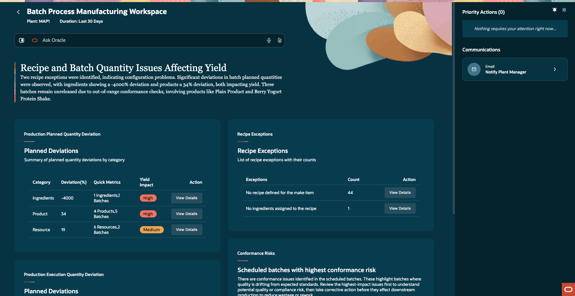

Figure 3 : Workspace structure
Workspace Layout
Figure 4: Insights provided based on the organization and analysis duration
Insights Provided Based on the Organization and Analysis Duration

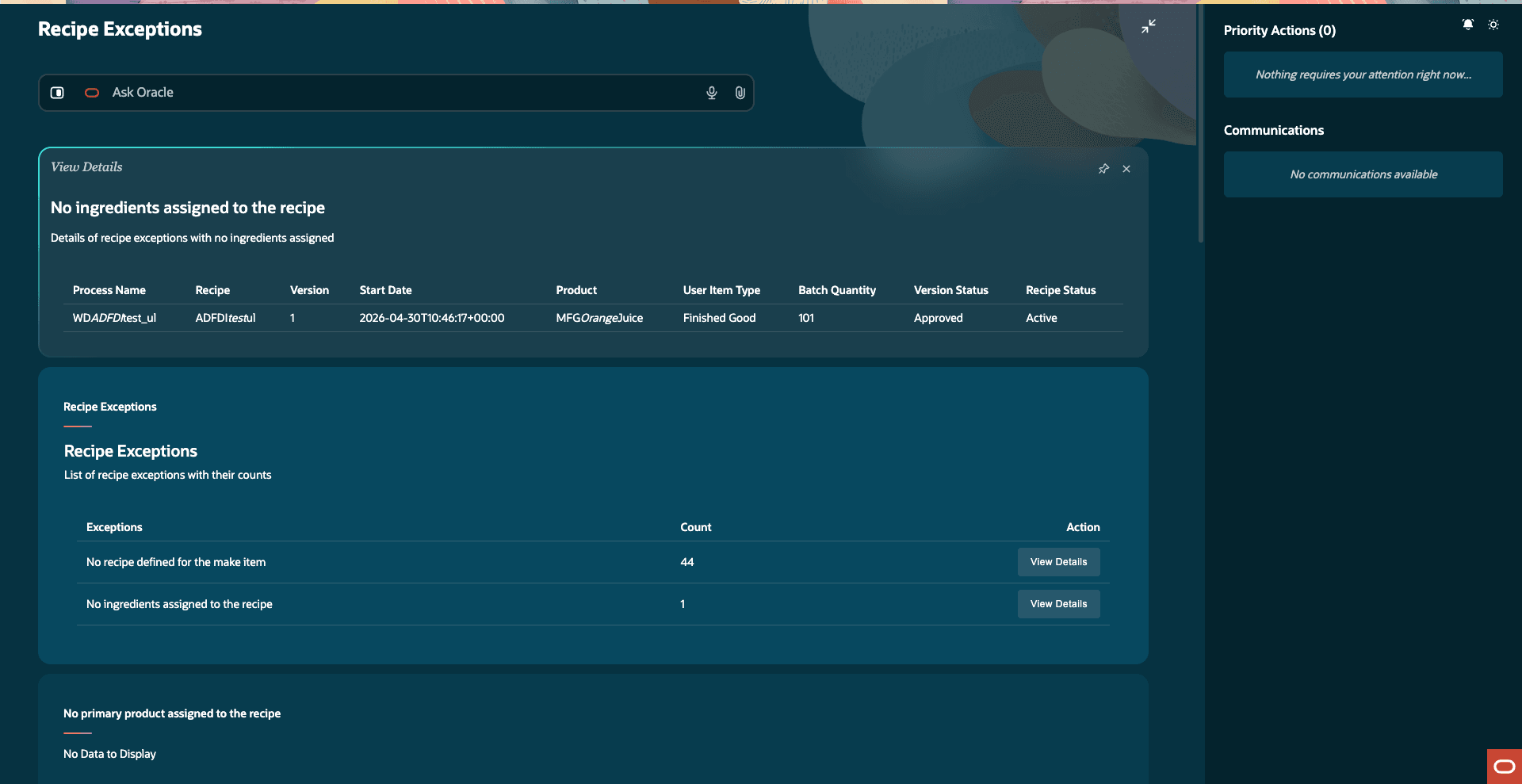

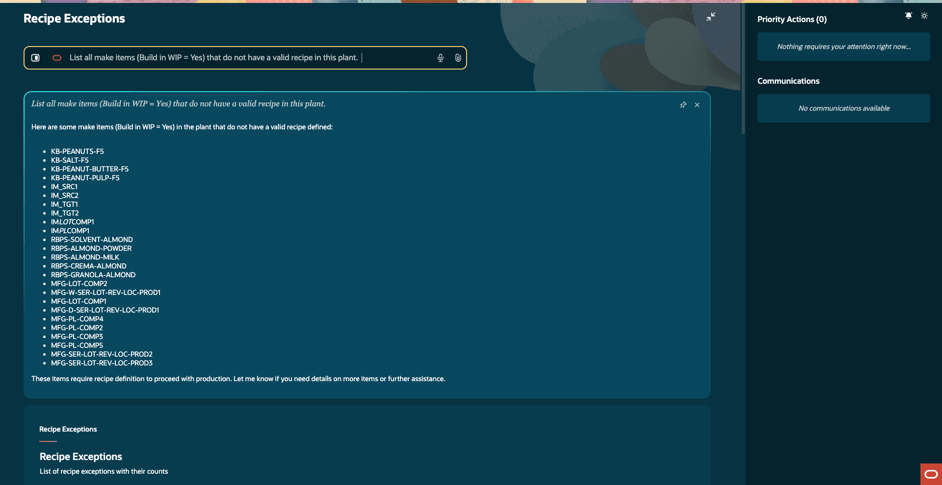

Recipe Exception Advisor
Use the Recipe Exceptions Advisor to ensure that recipes are production-ready before they impact planning, costing, or execution.This advisor continuously reviews the recipe, formula, item, and plant setup data to identify configuration issues and operational risks early.
It helps users identify issues such as the following:
  • No recipe defined for a make item.
  • Missing ingredients or products.
  • Invalid operation dependencies.
  • Inactive or unapproved recipes.
  • Formula or structure mismatches.
  • Other recipe setup gaps that may impact production readiness.
Each exception displays:
  • A summary count.
  • Impacted recipes or items.
  • Detailed insight into the issue.
  • Recommended next steps.
Users can select View Details to drill down into the impacted records, understand the root cause, and review the suggested corrective actions.

Figure 5: Recipe Exceptions Advisor overview
Recipe Exceptions Advisor Overview
Figure 6: Recipe exception drilldown or detail panel
Recipe Exception Drill Down or Detail Panel
Users can also drill down into the insights and ask deeper contextual questions to better understand the issue.

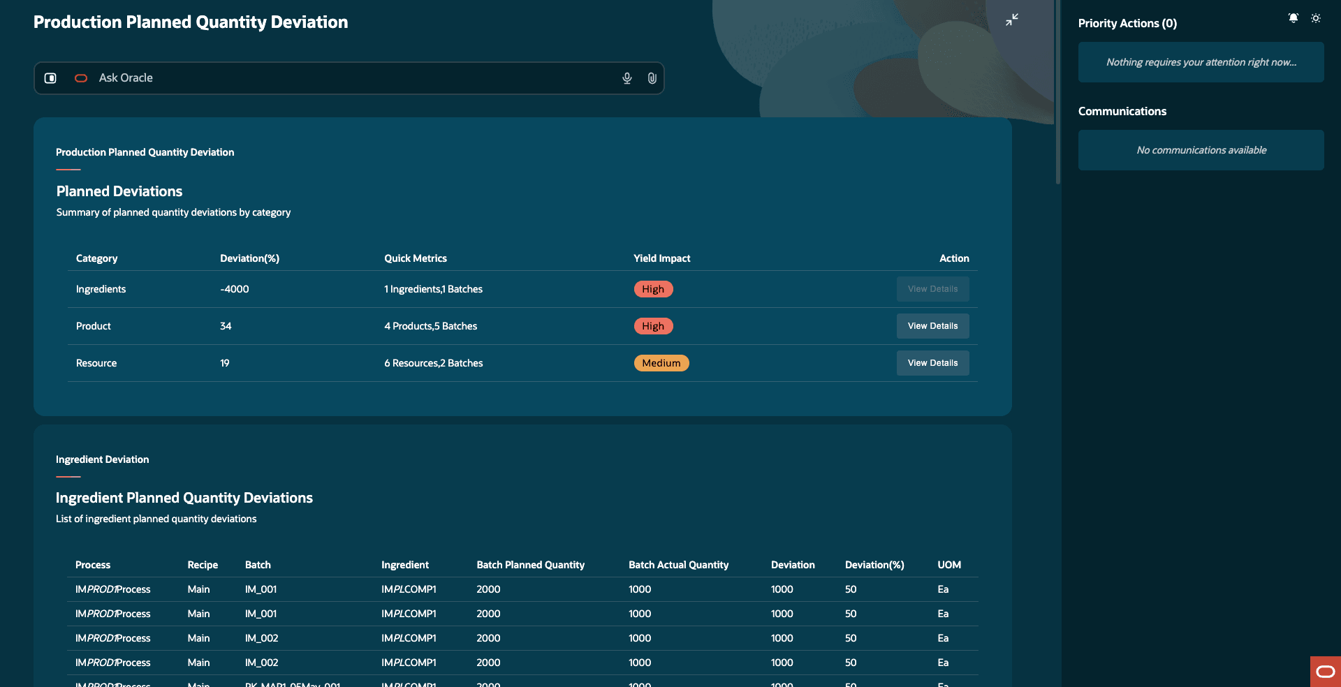

Production Planned Quantity Deviation
Use the Production Planned Quantity Deviation panel to identify planning-related deviations before batch execution begins.
This advisor compares recipe expectations with planned batch quantities and highlights the differences in planned values across:
  • Ingredients
  • Products
  • Resources
The advisor also highlights the impact level, helping users quickly identify the most significant deviations requiring attention.

Figure 7: Production Planned Quantity Deviation overview
Production Planned Quantity Deviation Overview

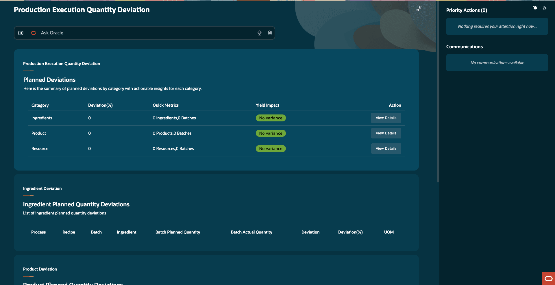

Production Execution Quantity Deviation
This panel helps users analyze what actually happened during production execution.
It shows where actual usage differs from the planned batch quantities for:
  • Ingredients
  • Products
  • Resources
Use this panel to investigate whether the batch performed as expected and identify where actual execution drifted from the plan.
Figure 8: Production Execution Quantity Deviation

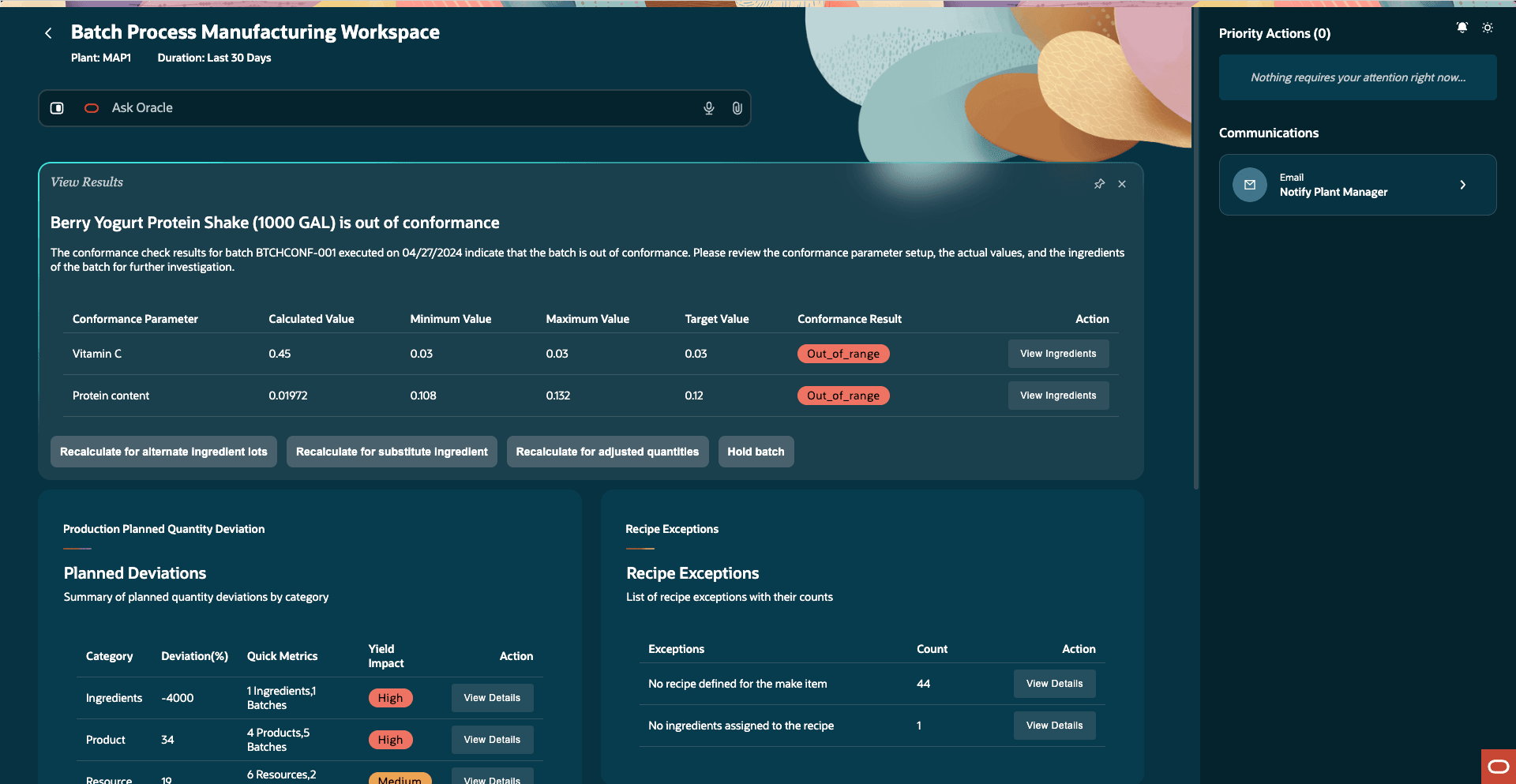

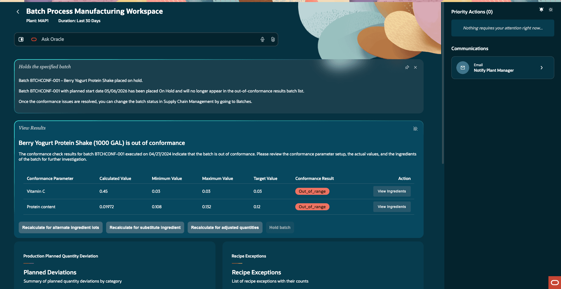

Batch Conformance Agent
Use the Batch Conformance Agent to identify high-risk batches and take preventive action before compliance issues occur.
This panel highlights scheduled or in-progress batches that may not meet target conformance requirements, allowing you to focus on the most critical risks first. By surfacing these issues early, you can reduce scrap, rework, and production delays.
Figure 9: Batch Conformance Agent

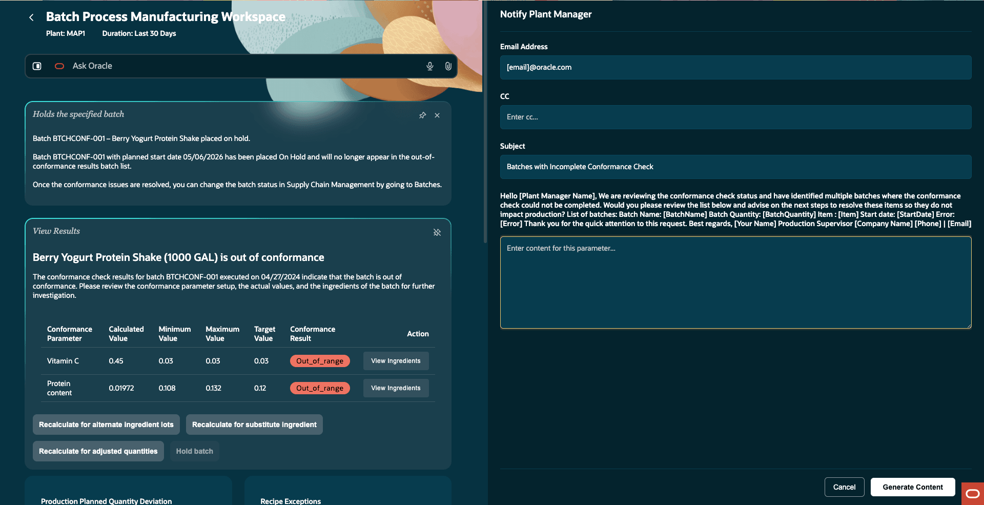

Figure 10: Conformance drilldown or simulation panel
Conformance Drill Down or Simulation Panel
Figure 11: Choose to share an email with the plant manager
Choose to Share an Email with the Plant Manager
Scope and Purpose
The Batch Conformance Agent helps users:
  1. Identify batches with potential conformance risks.
  2. Review conformance calculations and risk indicators.
  3. Analyze actual versus target conformance values.
  4. Perform simulations to evaluate corrective changes before execution.
  5. Review recommended priority actions where applicable.
  6. Analyze additional information related to:
    • Conformance parameters.
    • Actual and target values.
    • Conformance results and details.
    • Production batches.
You can drill down into the batch details to understand the following:
  • Which parameters are contributing to the risk?
  • How much does the batch deviate from target values?
  • What changes may improve the conformance result?
The simulation capability allows you to test changes such as ingredient adjustments or quantity changes before execution continues.
