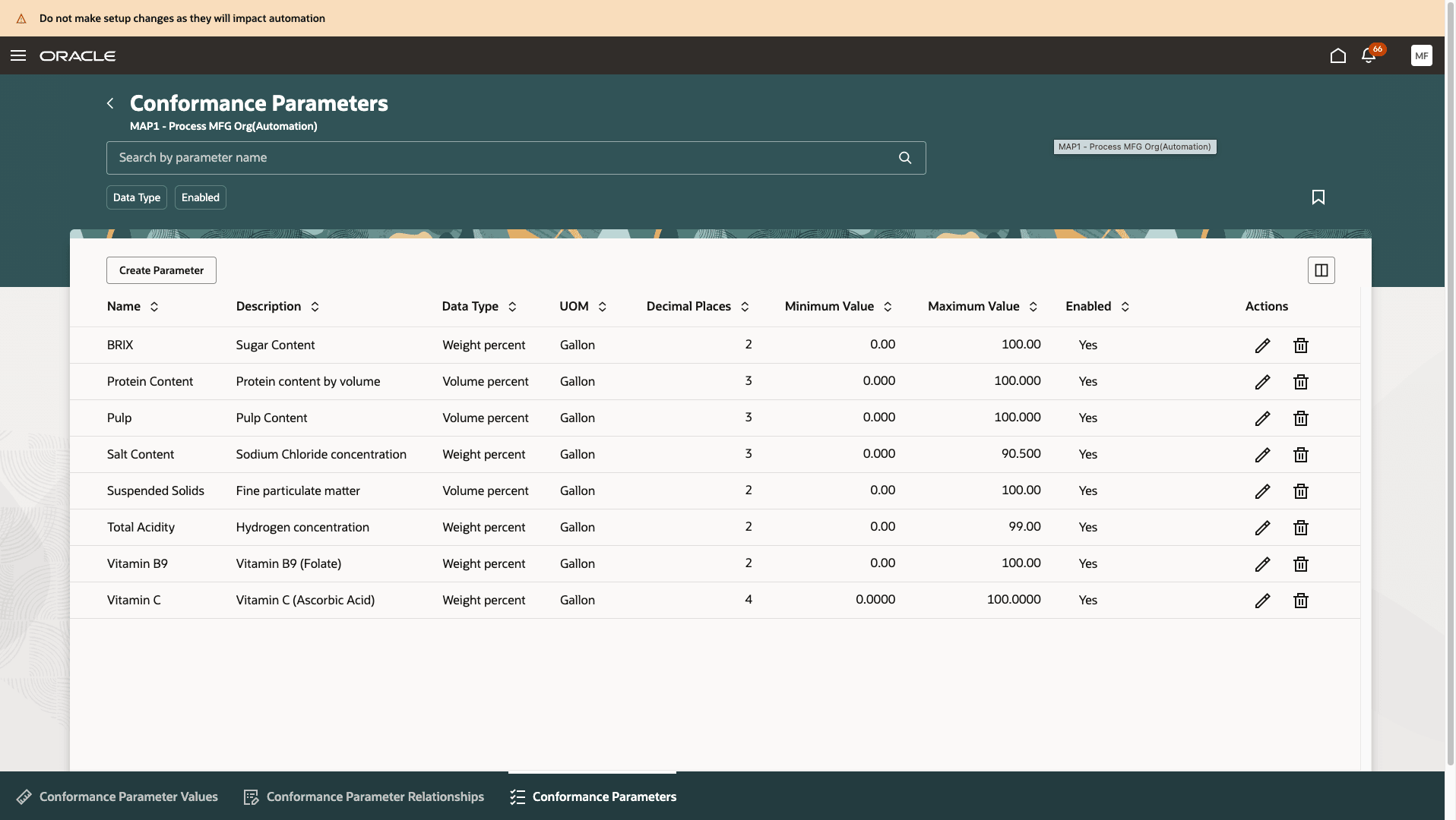

Conformance Parameter Setups
1. Conformance Parameters
Conformance parameters are physical properties that you want to measure and track for your ingredients and products to track quality or compliance issues.
Conformance parameters overview page
Conformance Parameters Overview Page

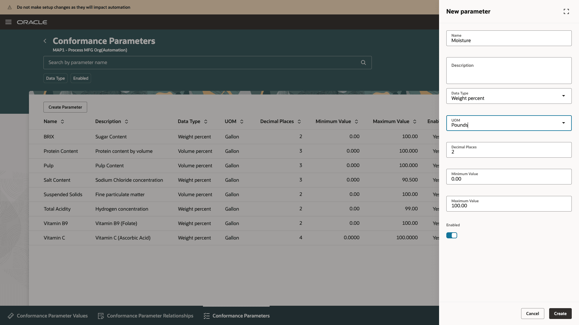

New conformance parameter drawer
New Conformance Parameter Drawer
  • Conformance parameters can be of data type 'Weight percent' or 'Volume percent'.
  • Conformance parameter UOM is the common unit of measure to convert all quantities of ingredients and products to for conformance check calculations.
  • The minimum and maximum values defined for the conformance parameter need to be adhered to when defining the target values for your products.
  • Only enabled conformance parameters can be used to define relationships and values and will be applicable for the conformance check.

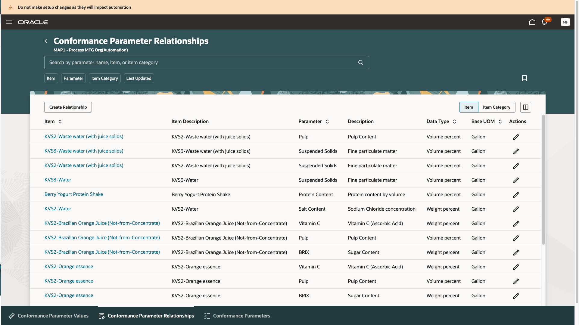

2. Conformance Parameter Relationships
After defining conformance parameters, you can assign these parameters to your ingredients and products so that you can track these values. The assignment can be done for a specific item or for an item category.
Conformance parameter relationships for items
Conformance Parameter Relationships for Items

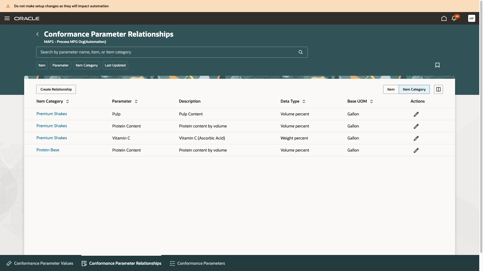

Conformance parameter relationships for item categories
Conformance Parameter Relationships for Item Categories
If relationships are defined both for the item category and the item, the relationship set up at the item level will be applicable.

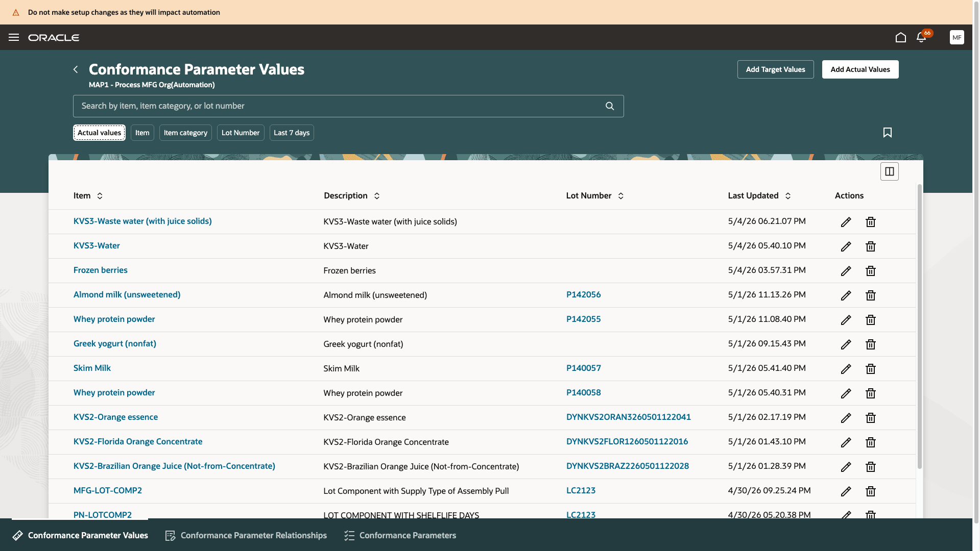

Actual values
You enter the actual values as you receive and inspect raw materials from your suppliers.
Actual values for conformance parameters of ingredients
Actual Values for Conformance Parameters of Ingredients

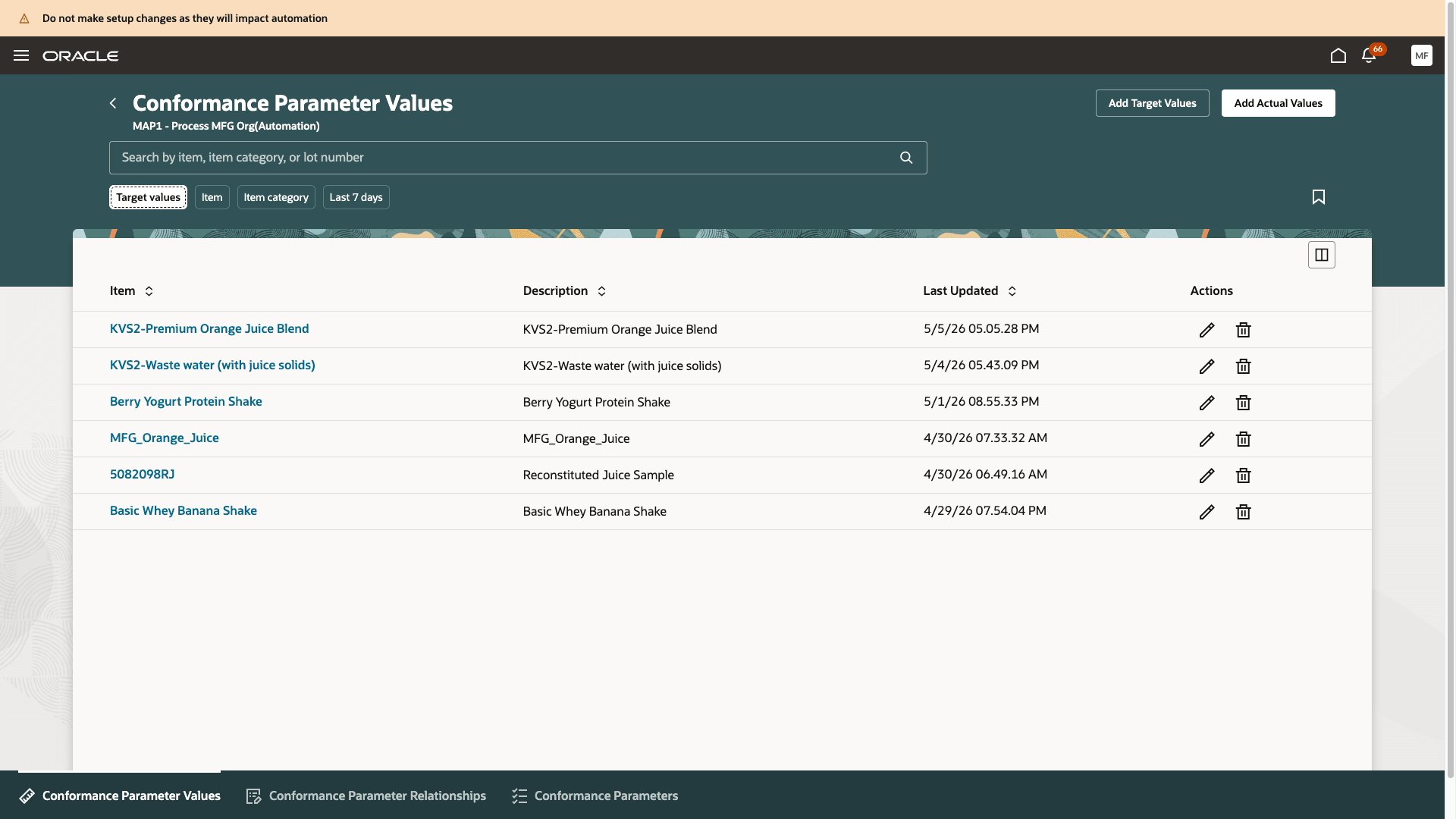

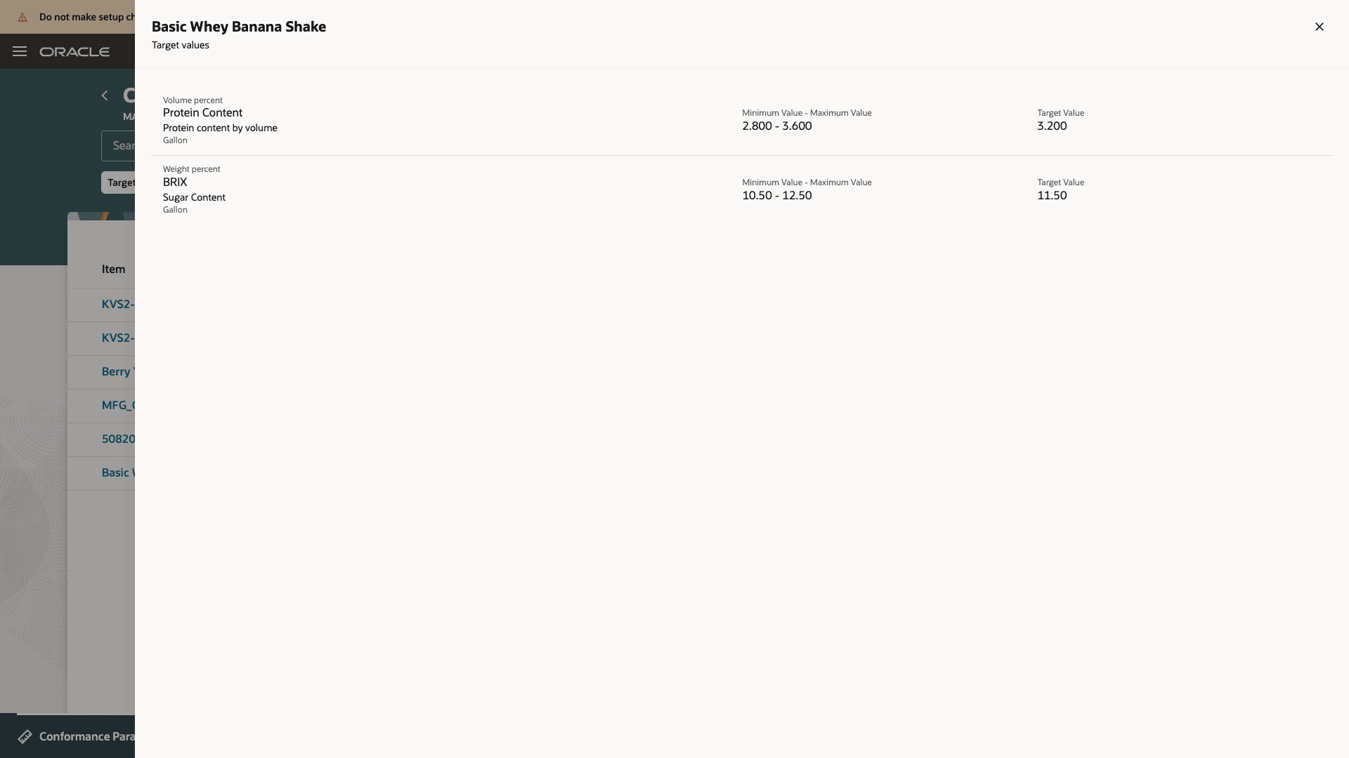

Target values
Target values for conformance parameters of products
Target Values for Conformance Parameters of Products
While entering target values, you can specify the acceptable range for your products. This range is used to determine the conformance result of the batch.
Target values
Target Values

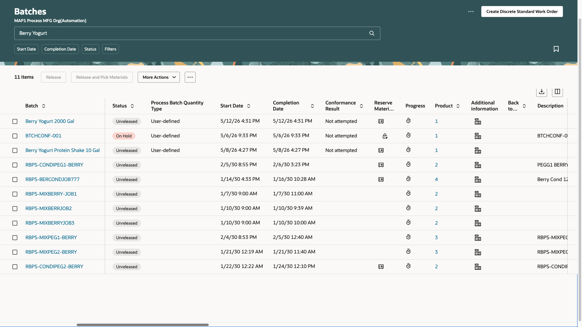

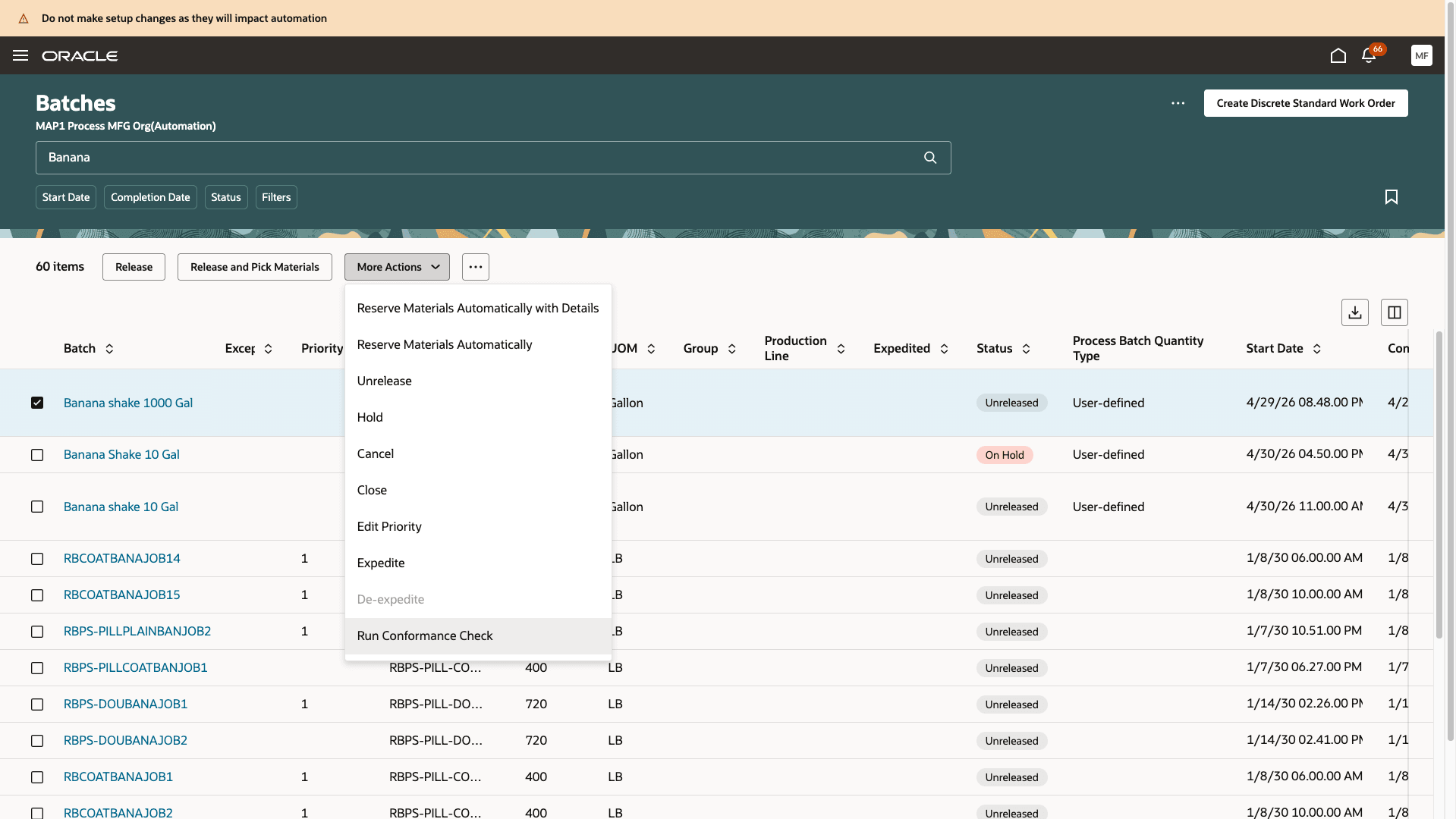

You can trigger the conformance check for an unreleased batch from the Batches page.
Trigger conformance check from the Batches page
Trigger Conformance Check from the Batches Page

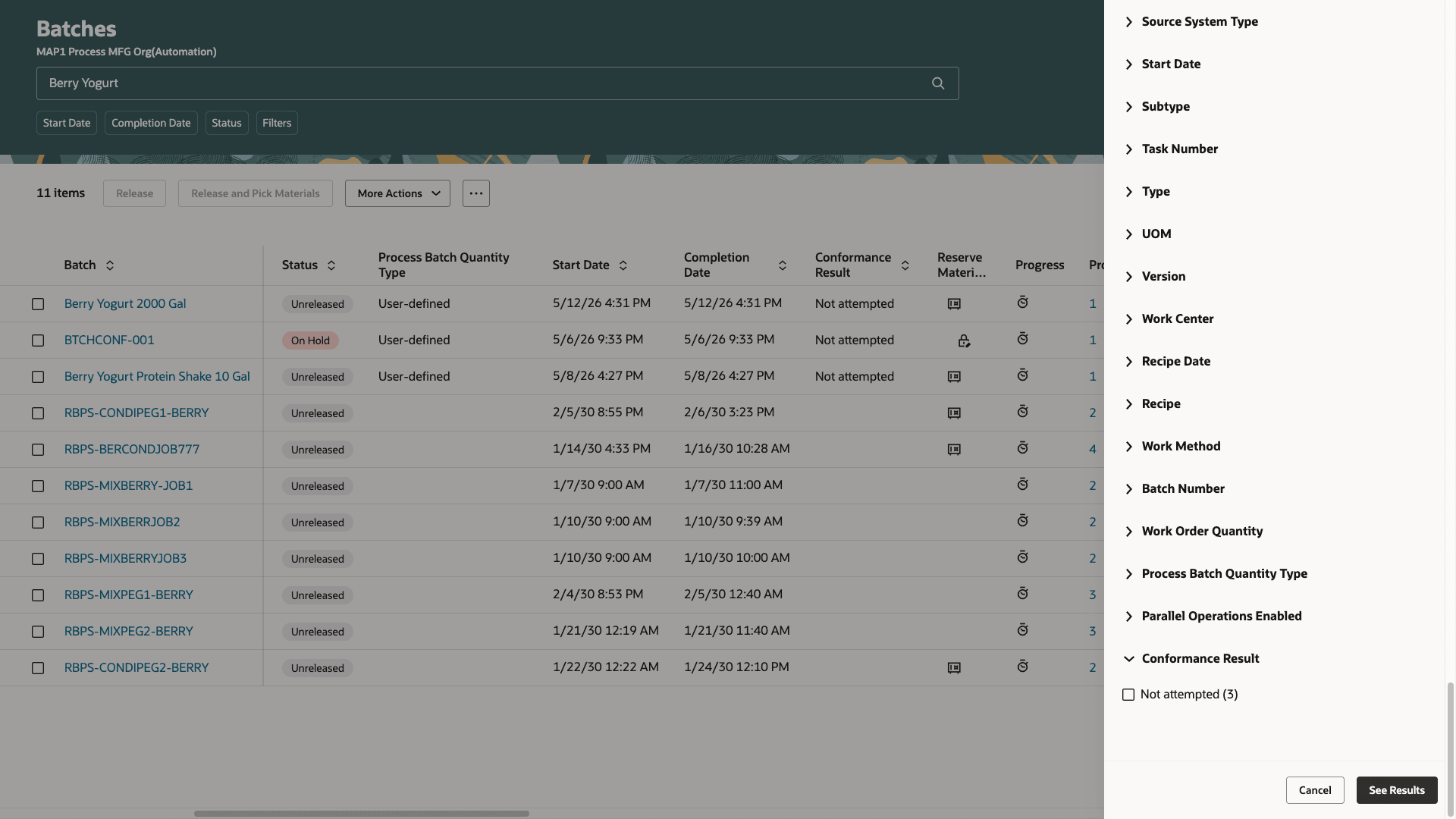

Conformance result in Batches page
Conformance Result in the Batches Page
In the Batches page, you can also see the conformance result of the batch. The different conformance result values are:
  1. Not applicable - The batch is not eligible for conformance check because the feature has not been opted in.
  2. Not attempted - Conformance check has not been triggered for the batch.
  3. Incomplete - Conformance check couldn't be completed due to missing pre-requisite setups.
  4. Out of range - One or more conformance parameters values of the primary product are out of acceptable range.
  5. In range - All conformance parameter values are in range.
You can also search by conformance result to look at batches that have issues or have not gone through the conformance check yet.
Search by conformance result in Batches page
Search By Conformance Result in the Batches Page

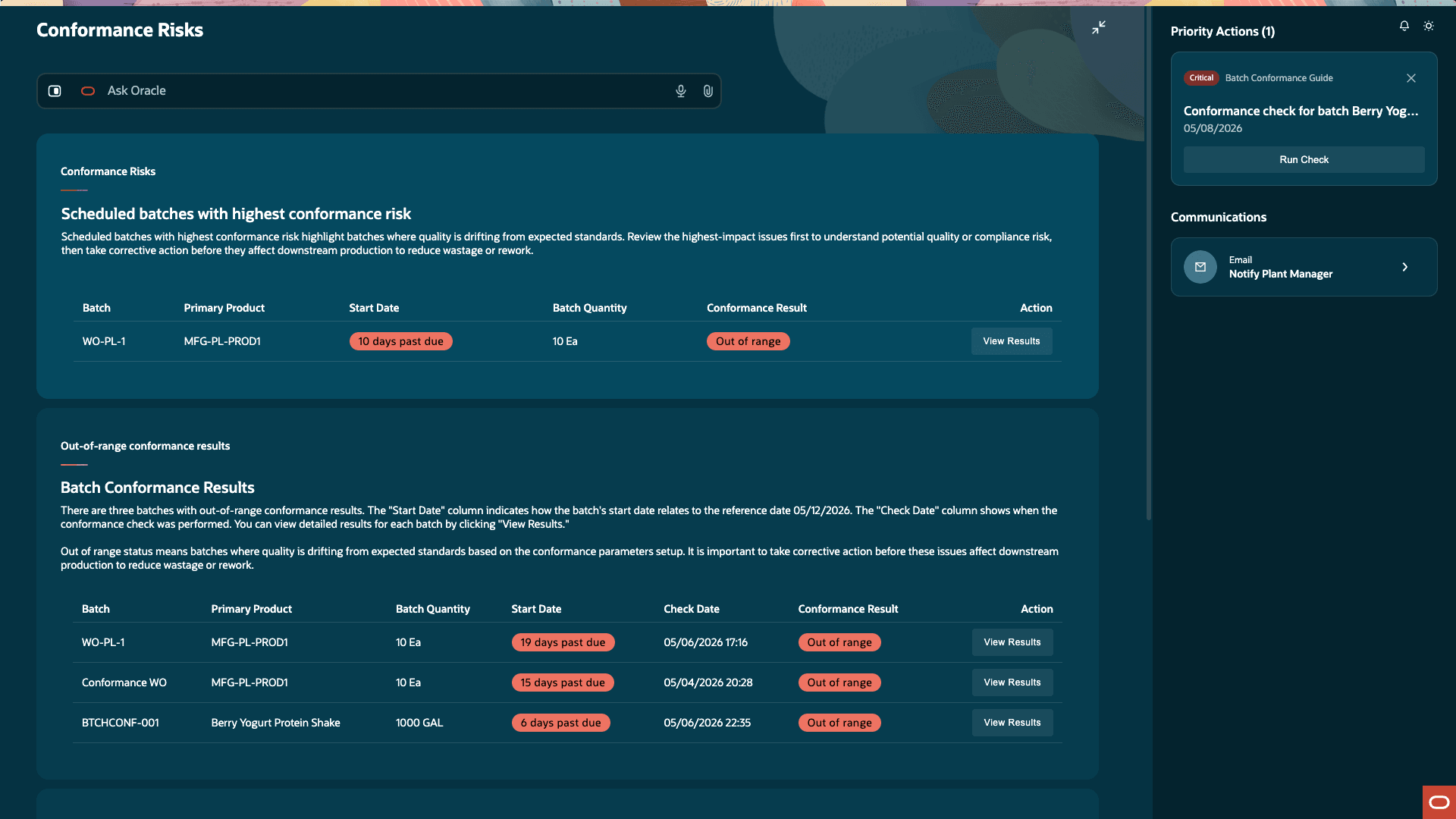

  • Out-of-range conformance results
In this section, you can see all batches with out-of-range conformance results, sorted by start date and batch quantity.
Out of range conformance results section
Out-of-Range Conformance Results Section
Click View Results to see the calculated conformance parameter values of the primary product.

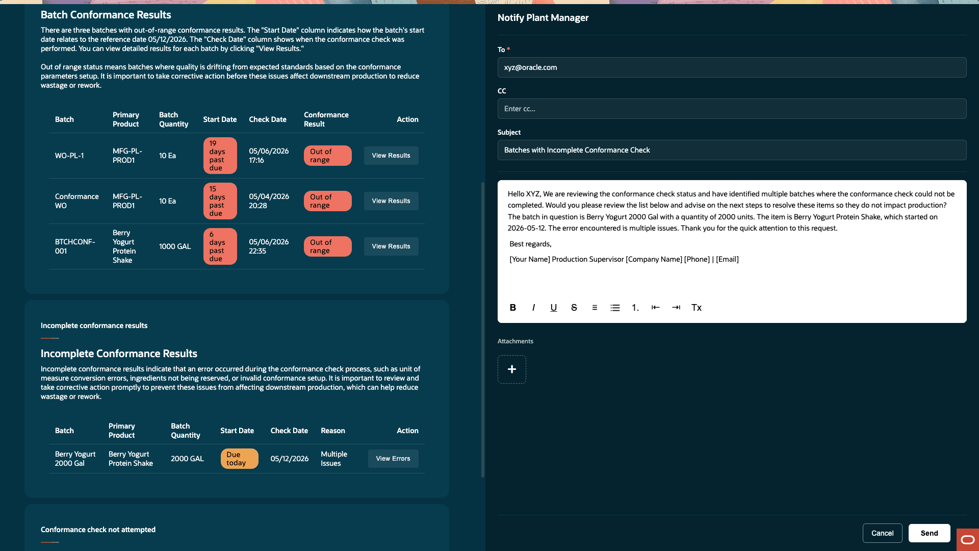

  • Incomplete conformance results
In this section, you can see all batches where the conformance check couldn't be completed due to missing setups.
Incomplete conformance result section
Incomplete Conformance Result Section
You can use the Communications section to send an email to the plant manager notifying them of the missing steps.
Email plant manager through communication
Email Plant Manager

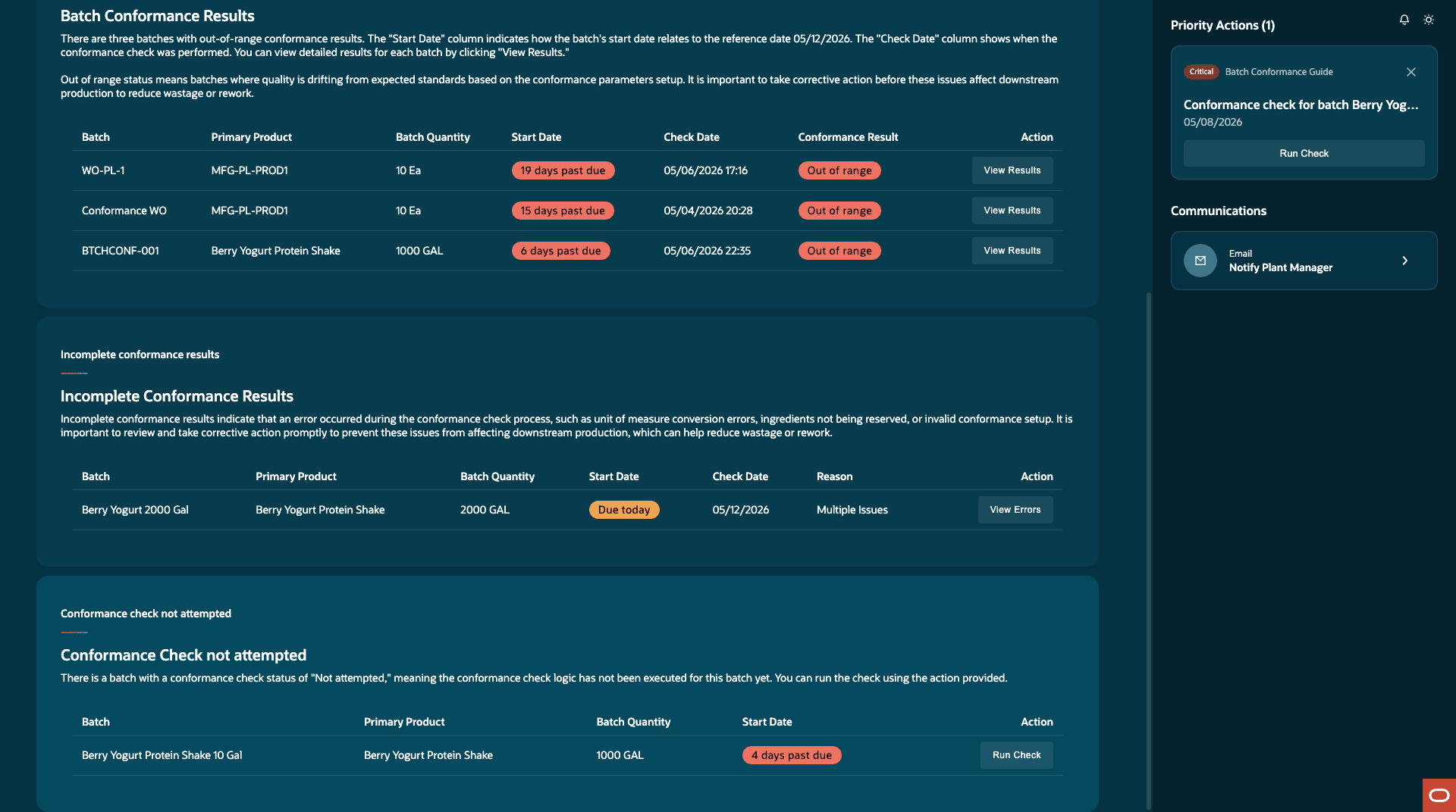

  • Conformance check not attempted
In this section, you can see all batches where conformance check has not been attempted. You can run the check for a batch here.
Conformance check not attempted section
Conformance Check Not Attempted Section
In the Priority Actions section, you can run the conformance check for unreleased batches where conformance check has not been triggered, and with a start date in the past.
