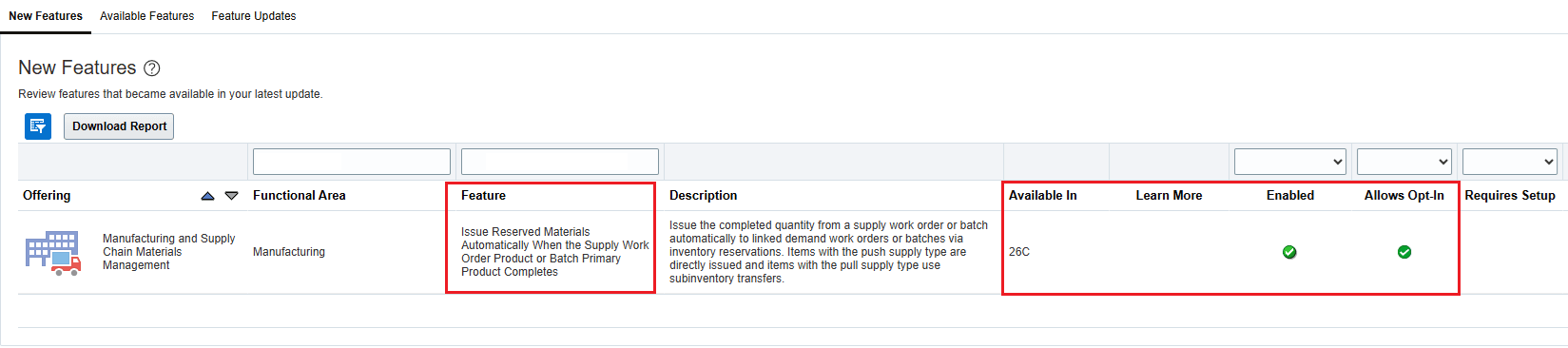

For multi-stage production processes, it is common to model separate, linked work orders to coordinate and track the material flow across stages. For example, the primary output from one stage is accurately supplied as an input to the next stage. These work orders require tight synchronization when managing timing and quantity variations. A reservation created between the work orders ensures that the materials are used exclusively between these stages.
You can now automatically issue reserved materials from a supply work order when the primary product is completed. This automation streamlines the management and execution of related work orders for discrete and process manufacturing based on the physical production process. For discrete work orders the work order product is issued upon completion at the last operation. For process work orders, primary output with a completion type of Automatic is supported.
When a prior reservation exists between a supply work order product and a demand work order operation material, the completed product is automatically issued to the demand work order if both the following conditions are met:
  • The material supply type is Push.
  • The completion subinventory specified on the supply work order matches the supply subinventory specified for the material on the demand work order.
Upon product completion, the system automatically issues the material to the demand work order and relieves the reservation.

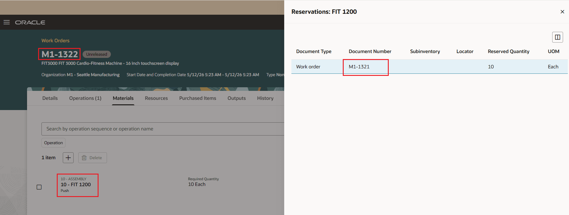

Work Order Material Manual Reservation

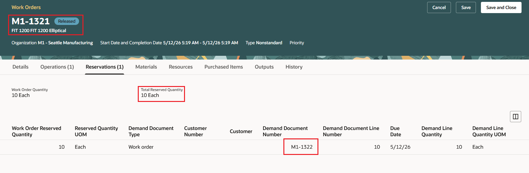

Work Order Product Reserved to Work Order Operation Material

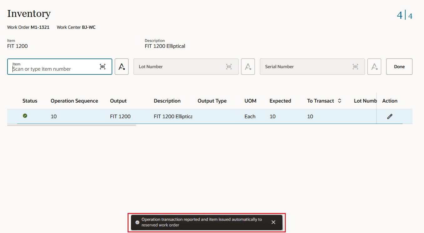

Reserved Material Auto Issued upon Product Completion
