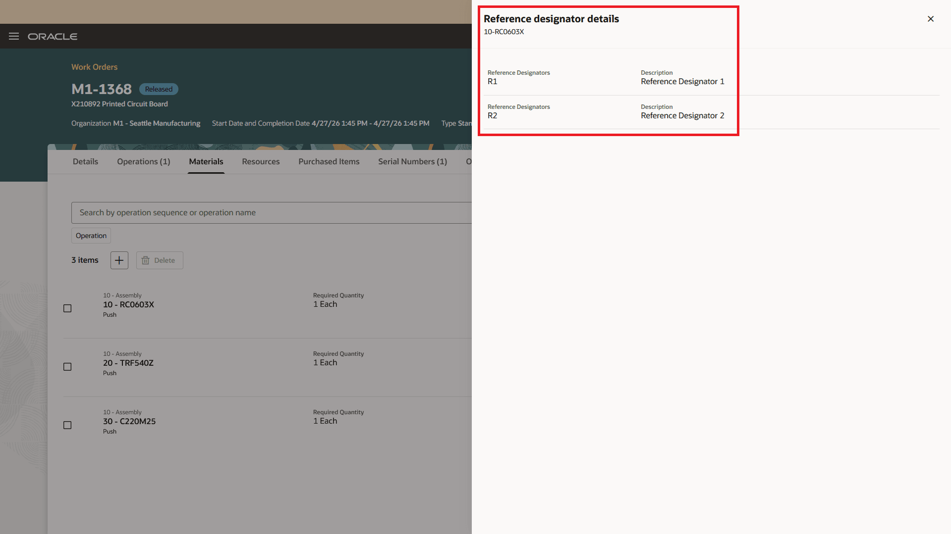

View Reference Designators for a Work Order Operation Material

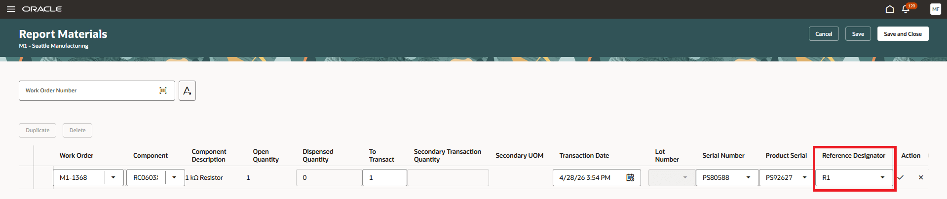

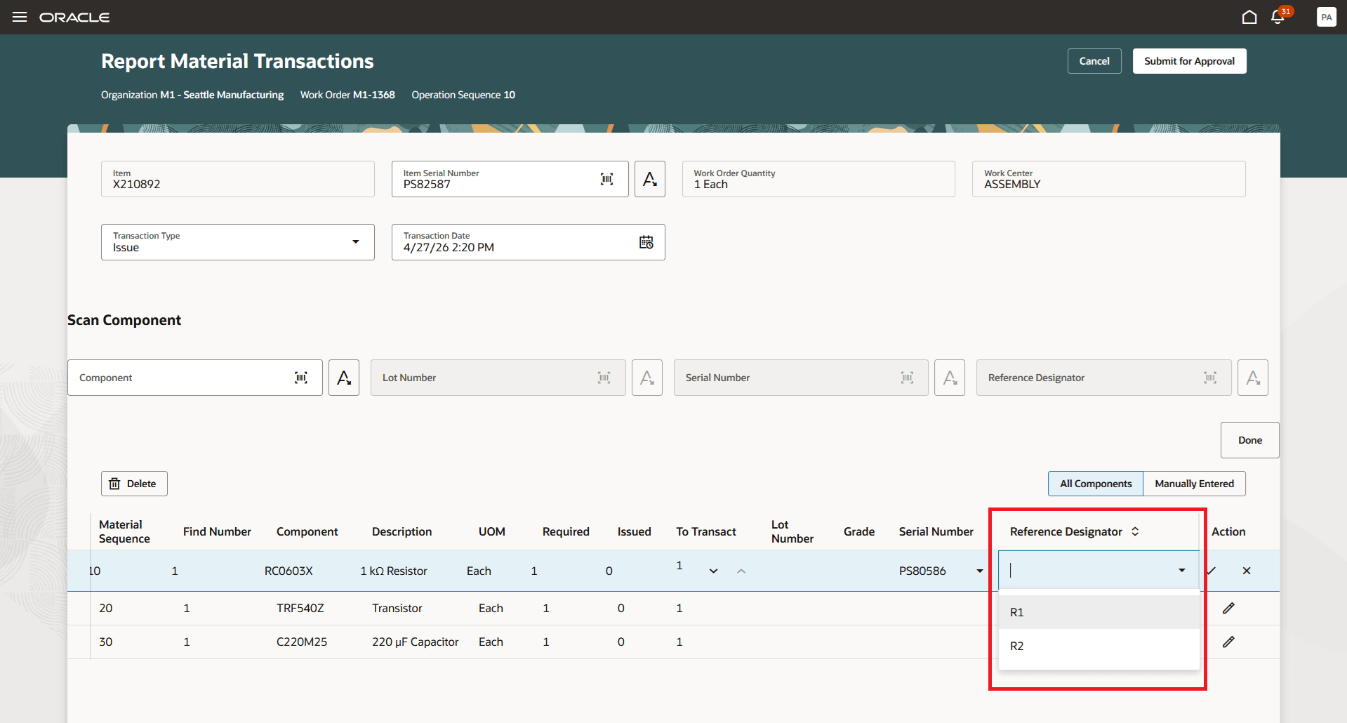

Enter a Reference Designators while Report Material Transactions
Scan or Enter a Reference Designator when Reporting a Material Transaction

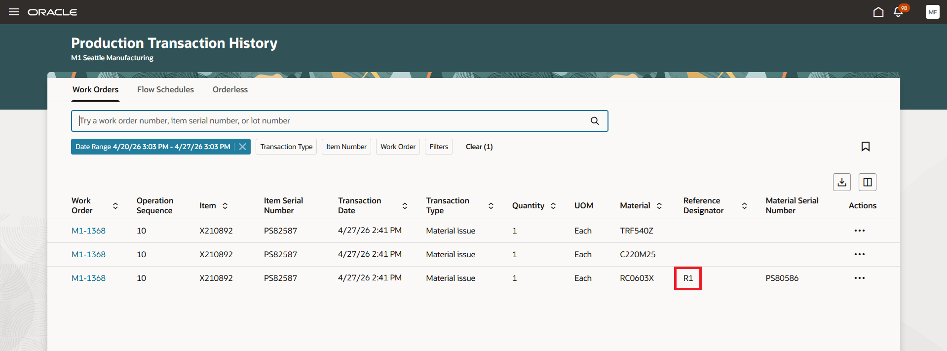

View Reference Designators in Production Transaction History

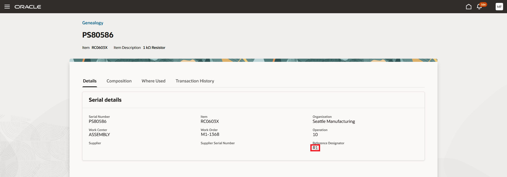

View Reference Designator in Product Genealogy

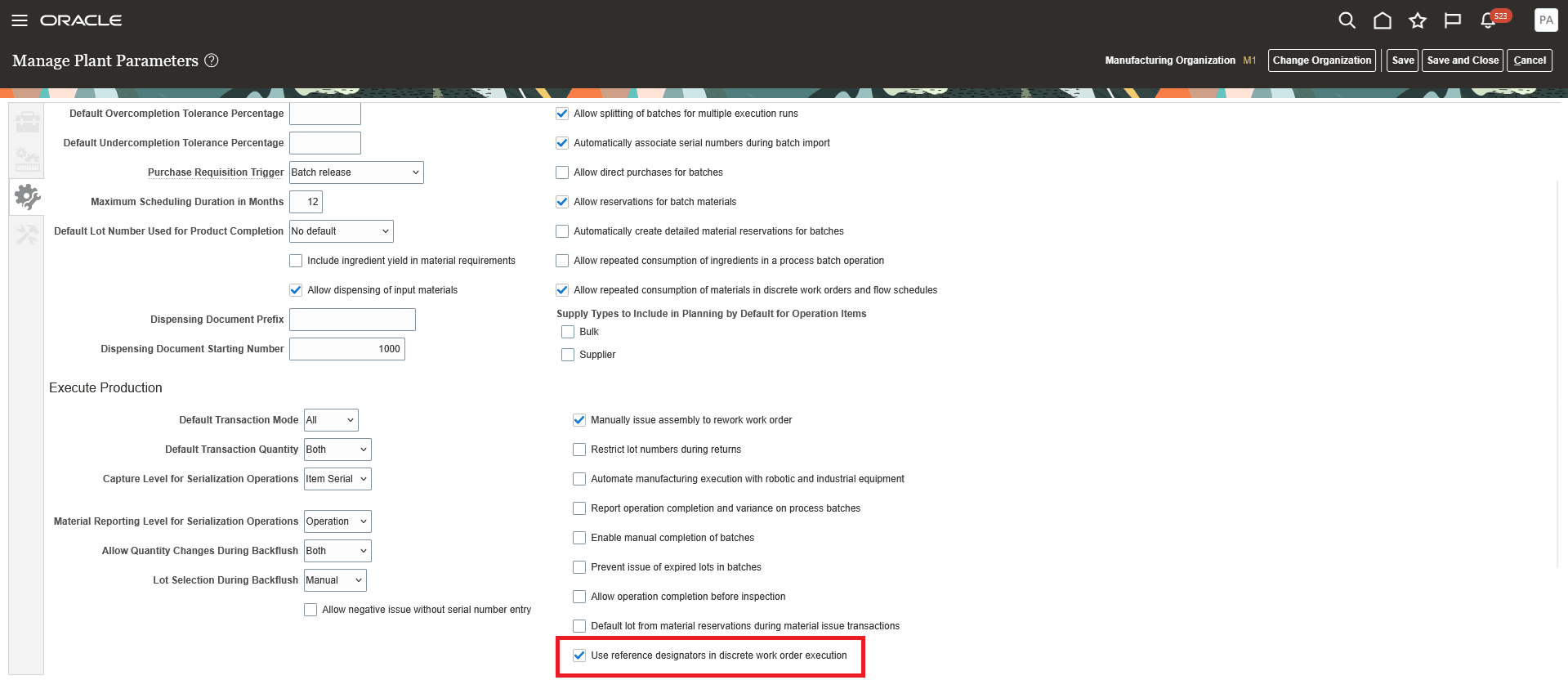

Set up the plant parameter to enable this feature:
  1. In the Setup and Maintenance work area, search for, and select the Manage Plant Parameters task.
  2. On the Manage Plant Parameters page, select the required inventory organization.
  3. In the Work Execution tab, under Execute Production, select the Use reference designators in discrete work order execution checkbox.
Enabling the Plant Parameter
