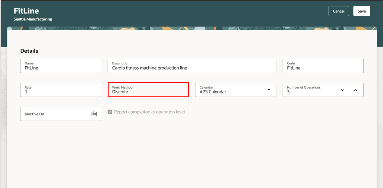

Production Line:
You can define a production line with a discrete work method and enforce discrete-specific rules, including operation-level completion behavior and minimum line operation counts. You can optionally associate the line operations with workstations belonging to the production line. Once work definitions and work orders are created for a discrete production line, its work method can't be updated.
Discrete Production Line

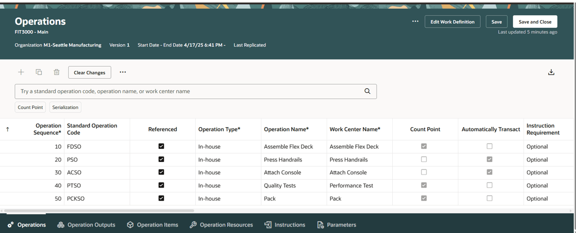

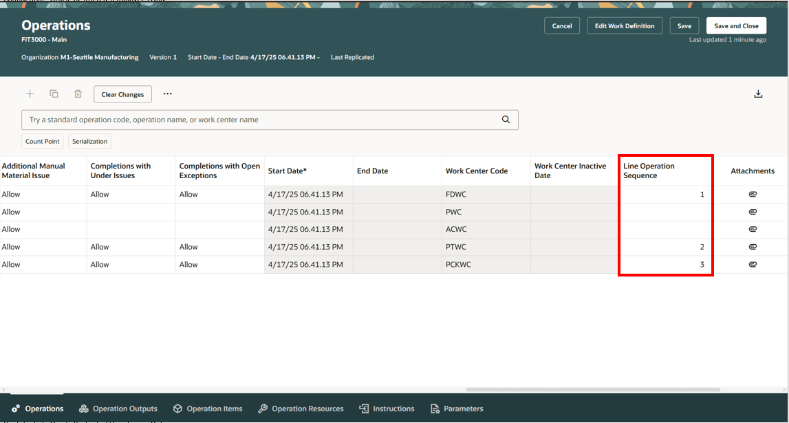

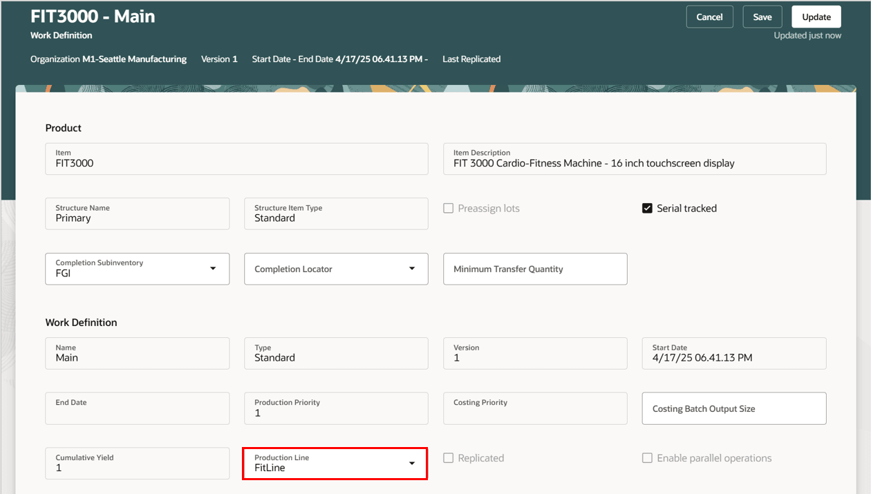

Work Definitions:
Work definitions now support production line association for the discrete manufacturing work method. You can migrate your existing work definitions to a discrete production line with this association. Currently, production line association is supported only for standard discrete work definitions. You can't associate production lines with work definitions defined in contract manufacturing organizations.
Work Definition Header with Production Line
Once a work definition is associated with a discrete production line, you can associate work definition operations with the line operations of the production line.
  • Line operations should be linked only to count-point operations and must follow a sequential order.
  • The line operation sequence can't be associated with:
    • Resequenceable operations
    • Supplier operations
    • Parallel operations
Work Definition Operations tab
Work Definition Operations with Line Operation Sequence

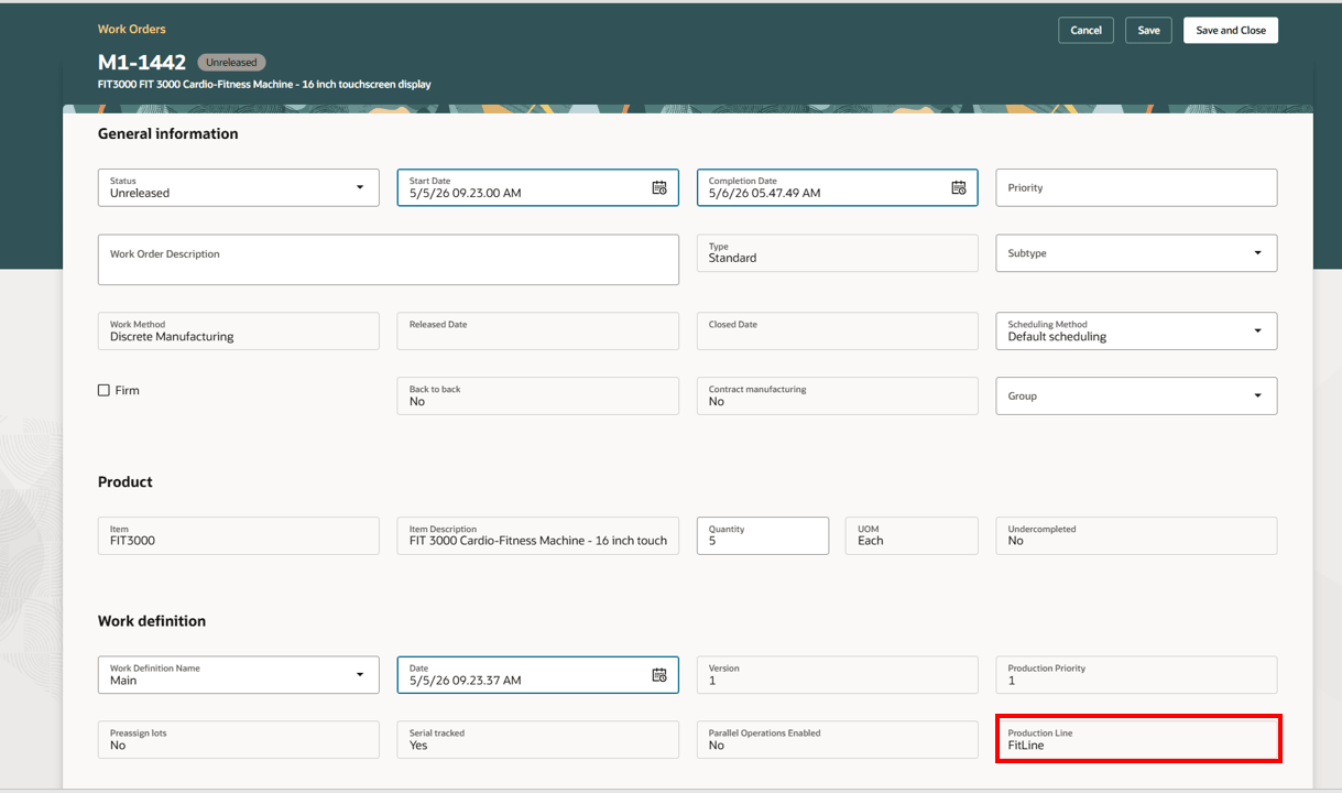

Work Orders:
The context of the production line and the line operation sequence is carried over into downstream work orders created based on the work definitions.
  • A discrete Production line can be referenced only for standard and nonstandard work orders based on work definitions.
  • Rework and transform work orders do not support a discrete production line.
Work Order Header with Production Line

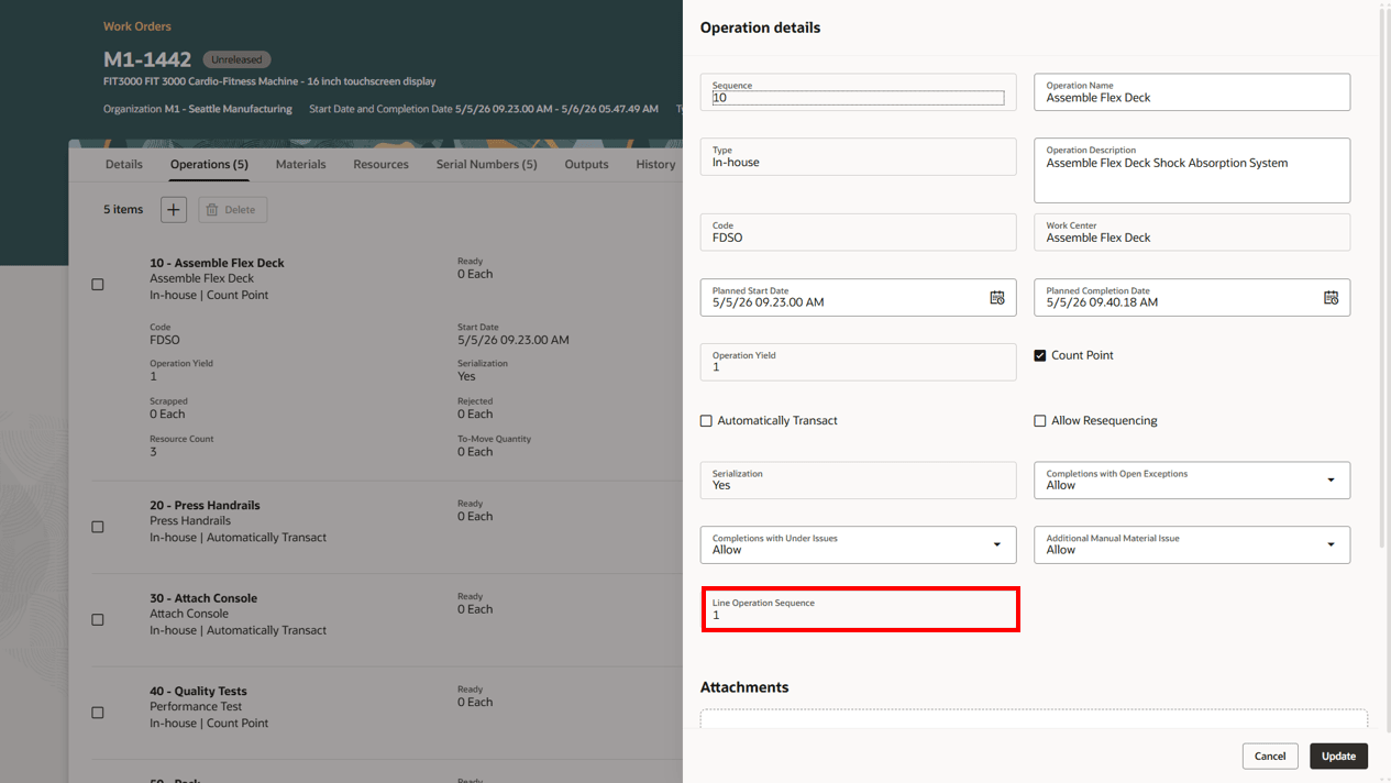

Work Order Operation with Line Operation Sequence

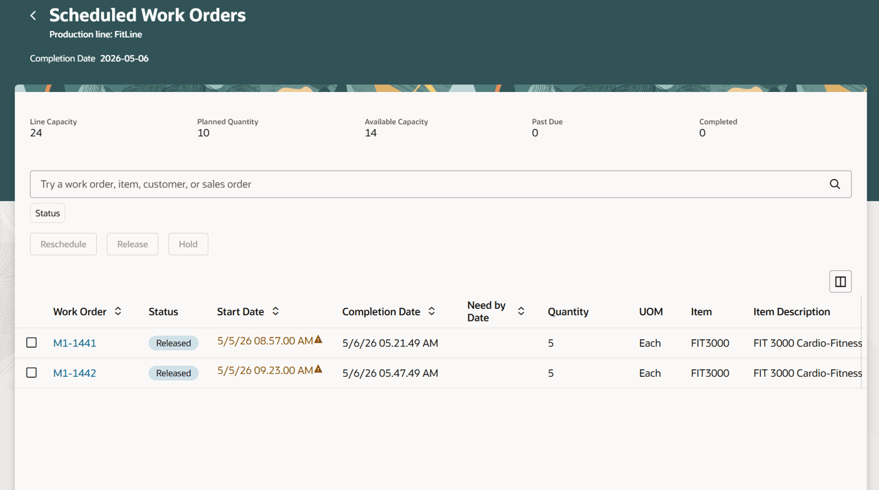

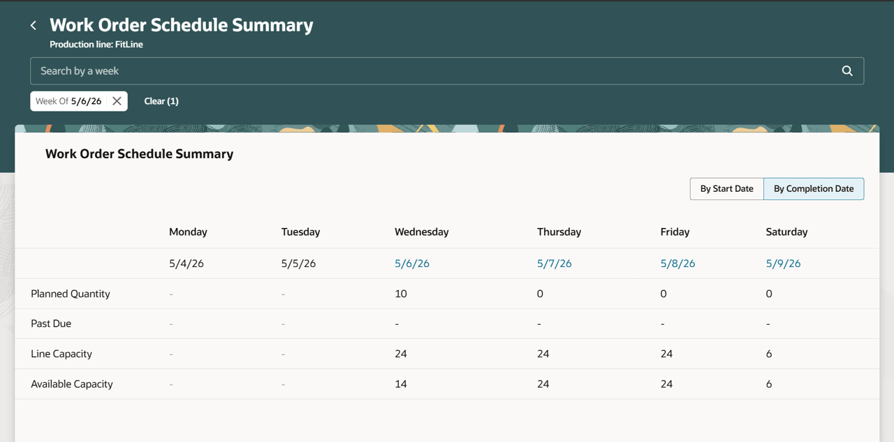

Work Order Schedule Summary
This view provides a weekly snapshot of the production line's capacity utilization.
When work orders are created from Planning or Order Management, the system identifies an appropriate date on which the full work order quantity can be accommodated, either on the requested date or on a prior day. If no suitable day with available capacity is found, then the work order is scheduled on the current date + 1 day, even if this results in an overload. Manually created work orders are always scheduled on the requested date, regardless of the line’s capacity utilization.
You can view the scheduled work orders for the production line by start or completion date. The metrics line capacity, planned quantity, and available capacity are shown in the context of the start date or completion date.
  • Line capacity shows the number of units that can be produced on a given date. It's calculated as the line capacity multiplied by the available shift hours in the day.
  • Planned capacity is the sum of total quantity of work orders on the given start date or completion date. All work order statuses are considered, except cancelled status and user defined statuses that are mapped to the cancelled status.
  • Available capacity is the difference of the line capacity and the planned capacity.
  • Past due quantity shows open work orders whose completion date is before the system date.
Scheduled Work Orders for Production Line
Scheduled Work Orders for the Production Line
You can drill down to the scheduled work orders page for a specific start or completion date by clicking the date. The drill-down page helps users balance the line’s capacity utilization by taking appropriate actions on the scheduled work orders. You can review quantity metrics in the header, filter work orders by status, and perform actions such as rescheduling, releasing, or placing work orders on hold.

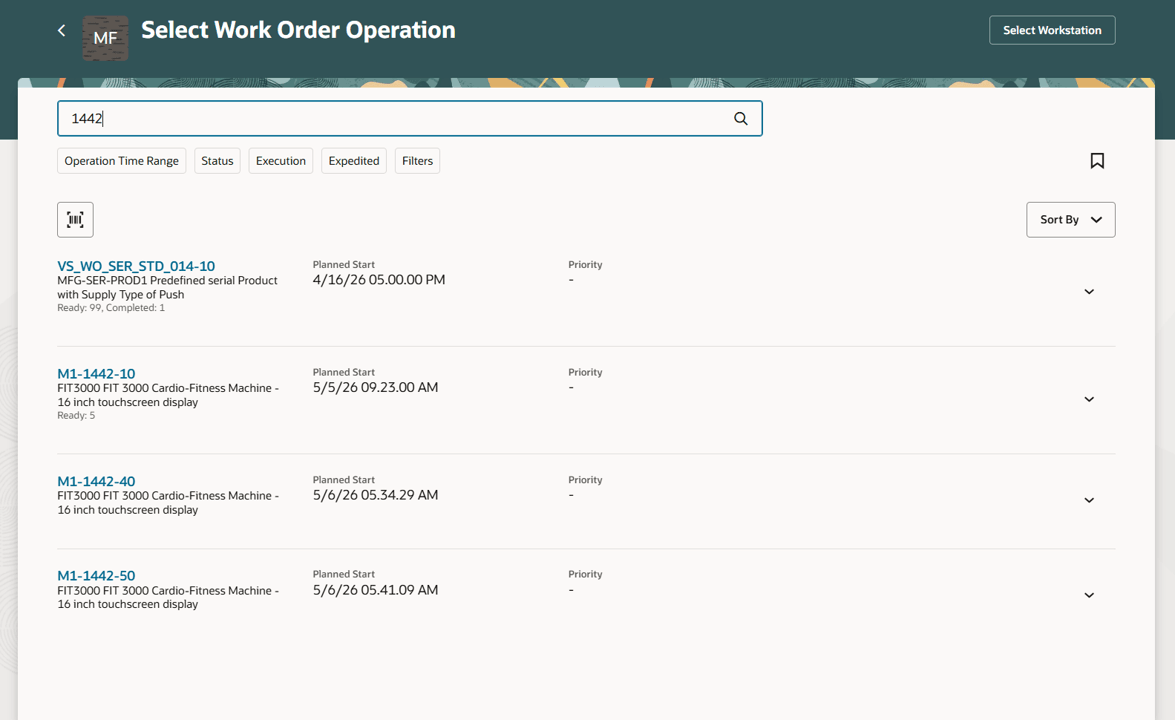

Production Execution
You can perform real-time execution at workstations associated with the line operations of a production line using the Production Execution task.
The Production Execution user interface has been enhanced to report work order transactions in the context of the production line and the line operation sequence.
The next scheduled work order operation is determined based on the contextual line operation sequence. It must have a ready quantity greater than zero and belong to a work order that meets the following criteria:
  • Has the earliest start date.
  • Is not in Canceled or On Hold status.
  • Is associated with the contextual production line.
All scheduled work order operations display the pending operations scheduled on the selected production line and associated with the contextual line operation.
Workstation based reporting in Production Execution
Workstation Based Reporting in Production Execution

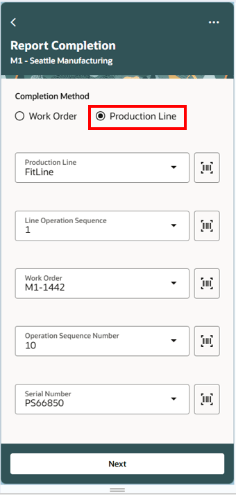

Mobile Reporting
Mobile reporting enables users to execute transactions either in the work order context or in the production line plus line operation sequence context. The option to select a production line appears only when discrete production lines have been defined in the organization.
 Mobile Reporting in context of Production Line
Mobile Reporting in Context of a Production Line

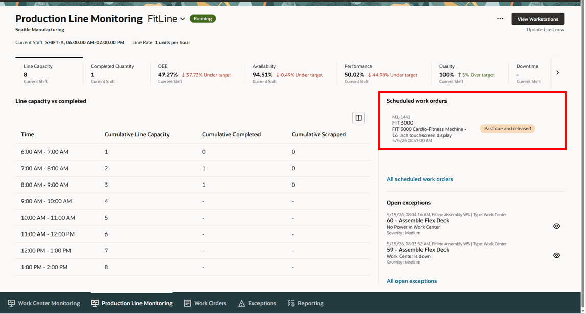

Production Supervision:
Discrete production line based work orders can be monitored using the Production Line Monitoring tab in the Production Supervision task.
Production supervisors can monitor production line performance, including OEE and its components. The following metrics are available for the production line during the current shift:
  • Line capacity
  • Completed quantity
  • OEE
  • Availability
  • Performance
  • Quality
  • Downtime
  • Open exceptions
In addition, supervisors can monitor completed and scrapped quantities in hourly buckets of the shift against the theoretical line capacity.
You can also view the scheduled work orders on the production line.
  • The scheduled work orders list includes work orders in unreleased and released status, associated with the discrete production line in the context.
  • The work orders are sorted by start date, in ascending order.
  • A badge displays the appropriate status for past due, released, and unreleased work orders.
Scheduled work orders on production line
Scheduled Work Orders on a Production Line

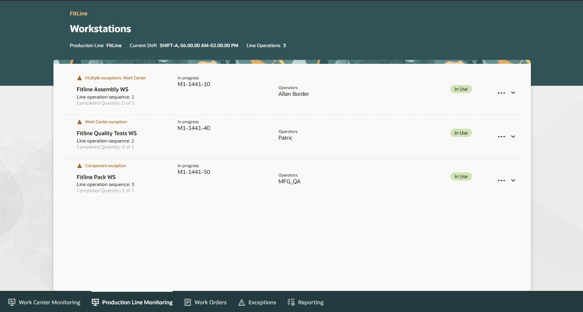

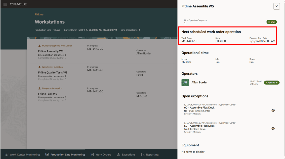

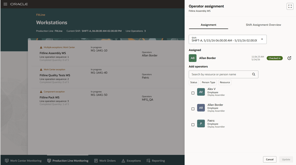

You can view all the workstations associated with the production line. You can also view the operation in progress, operation quantities, and operators checked in on each workstation.
Workstations on production line
Workstations on a Production Line
Operator assignments on workstation
Operator Assignments for a Workstation

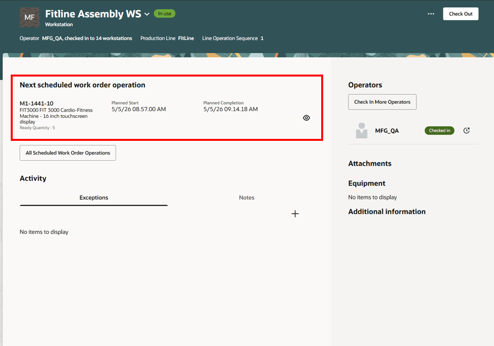

You can also view the next scheduled work order operation on the workstation of the production line.
The next scheduled operation is an operation from the pending scheduled work order list, having the earliest start date and a ready quantity greater than zero.
For the next scheduled operation, the item and planned start date are shown.
Next scheduled operation on workstation
Next Scheduled Operation on a Workstation

  1. Enable and configure production lines:
    1. This feature is enabled via Opt-in.
    2. Create a discrete production line with the work method set to discrete.
    3. Ensure that the line rate provides a line capacity of at least one unit per day (for example, line rate greater than 0.125 units per hour for an 8-hour shift).
    4. For discrete production lines, Report Completion at Operation Level is always set to Yes.
    5. For discrete production lines, the number of operations should be at least 1.
    6. Save the production line; the work method field becomes read-only once work definitions or work orders reference the production line.
