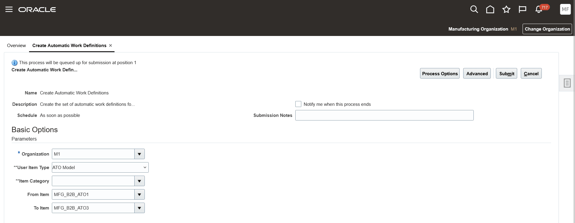

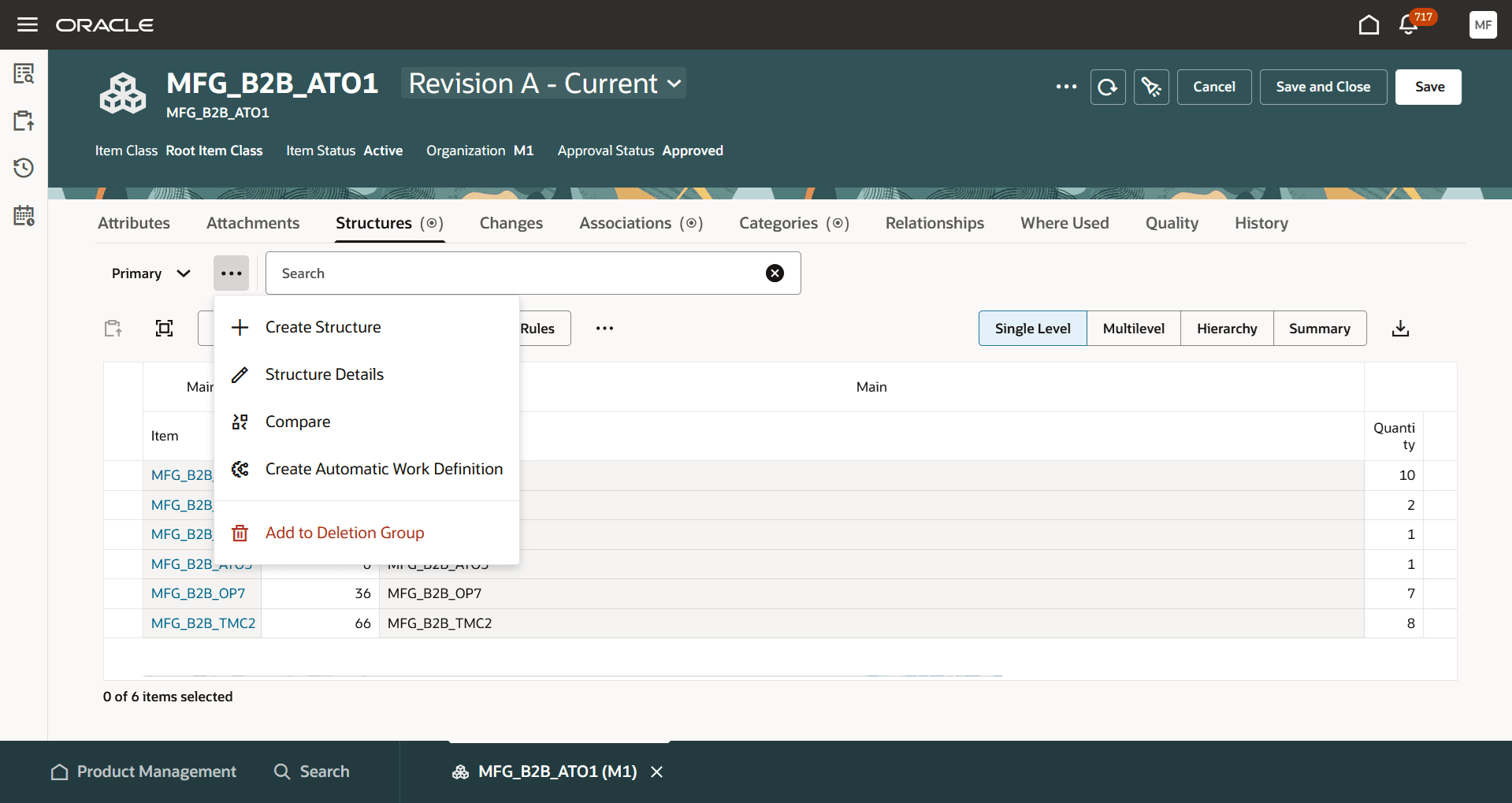

You can create an automatic work definition for an ATO model from the Redwood Item Structure user interface. You can also mass create automatic work definitions for ATO models using the Create Automatic Work Definitions scheduled process. An automatic work definition is created with the internal name ORA_MAIN and a production priority of 1. You can't view or update the details of an automatic work definition except for the production priority and costing priority. You can create configured item work orders by referencing an ATO model automatic work definition.
Create Automatic Work Definition action in Redwood Item Structures UI
Create Automatic Work Definition Action in the Redwood Item Structures UI
Create Automatic Work Definitions Schedued Process
Create Automatic Work Definitions Scheduled Process
