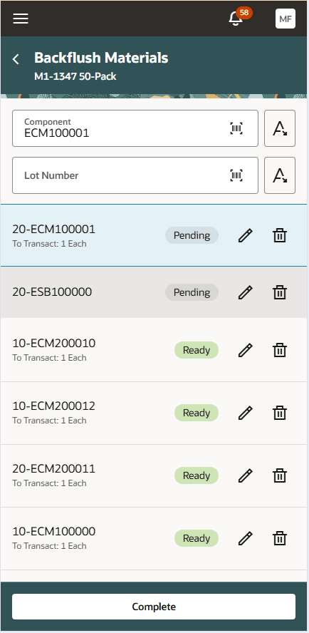

You can now enter the lot and serial details for backflush components or ingredients during Mobile Manufacturing operation completion transactions. If lot or serial enabled components are to be backflushed, then the Backflush Materials UI appears as part of operation completion. All pull components or ingredients for the operation are displayed, and operators can add ad hoc components for issue. User can enter lot and serial details for backflush components or ingredients during Mobile Manufacturing operation completion transactions.
Backflush Materials - Scan Lot
Backflush Materials - Scan Item Lot
This enhancement enables production operators to remain in the mobile operation completion flow when backflush components require lot or serial tracking. It reduces the need for separate follow-up transactions for tracked materials, improves shop floor efficiency, and supports more accurate capture of inventory-controlled material during operation reporting.
