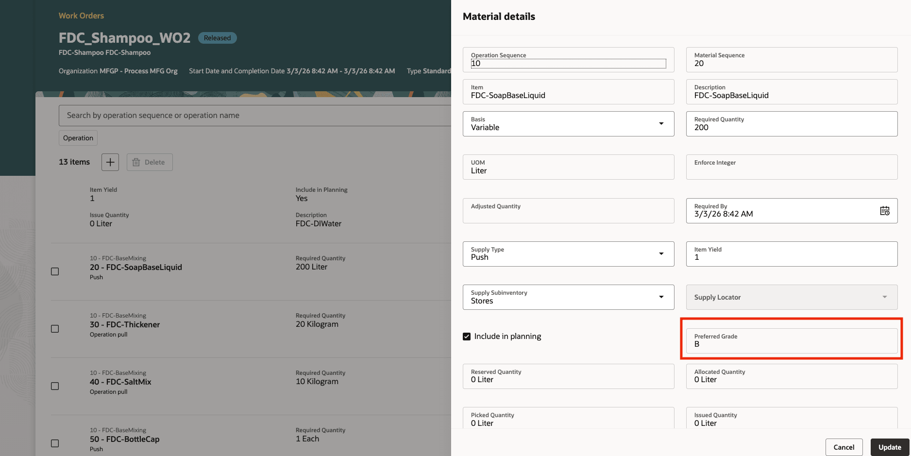

Operators need clear guidance on which material or product grade should be used during production. Now you can specify the preferred grade for grade-controlled materials and products in manufacturing work definitions or recipes. The preferred grade flows to the downstream work orders, batches, flow schedules, and production transaction pages, so that operators see the preferred grade when issuing materials, completing products, or working with preassigned lots.

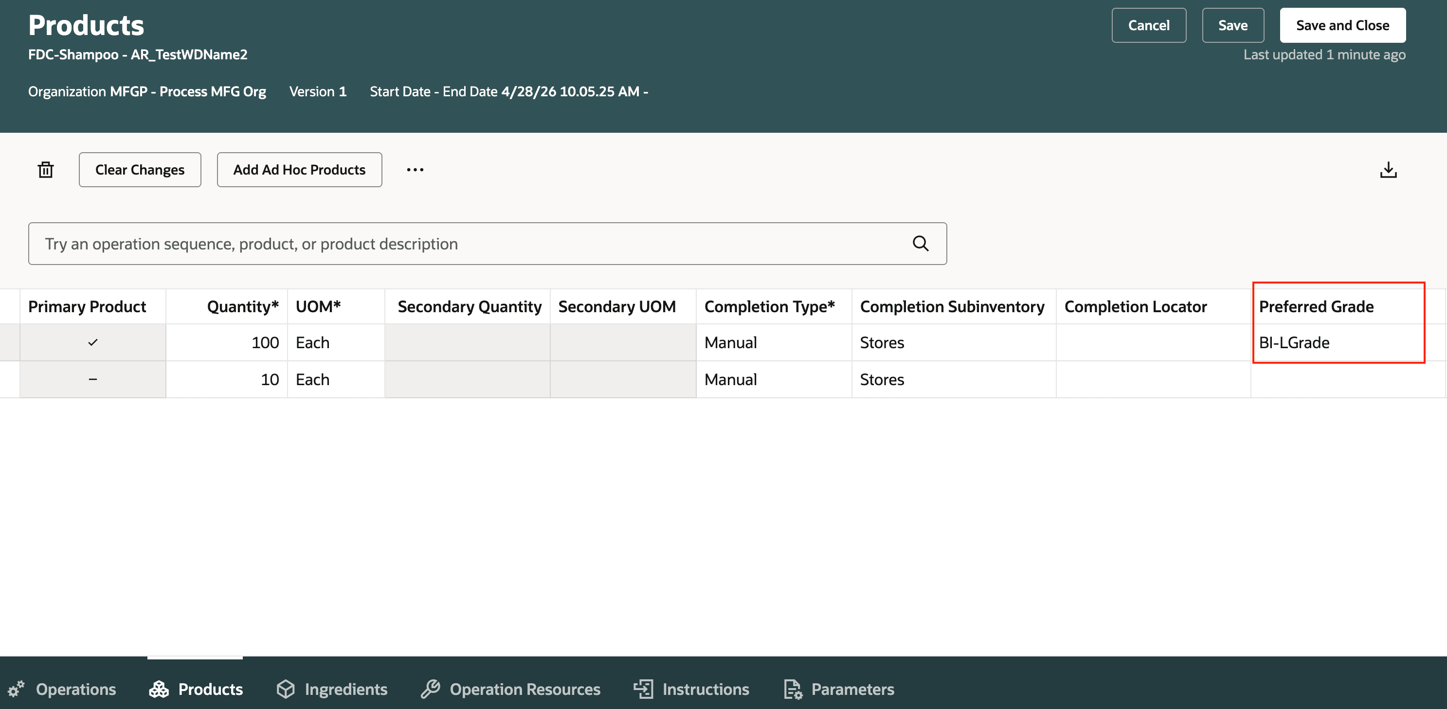

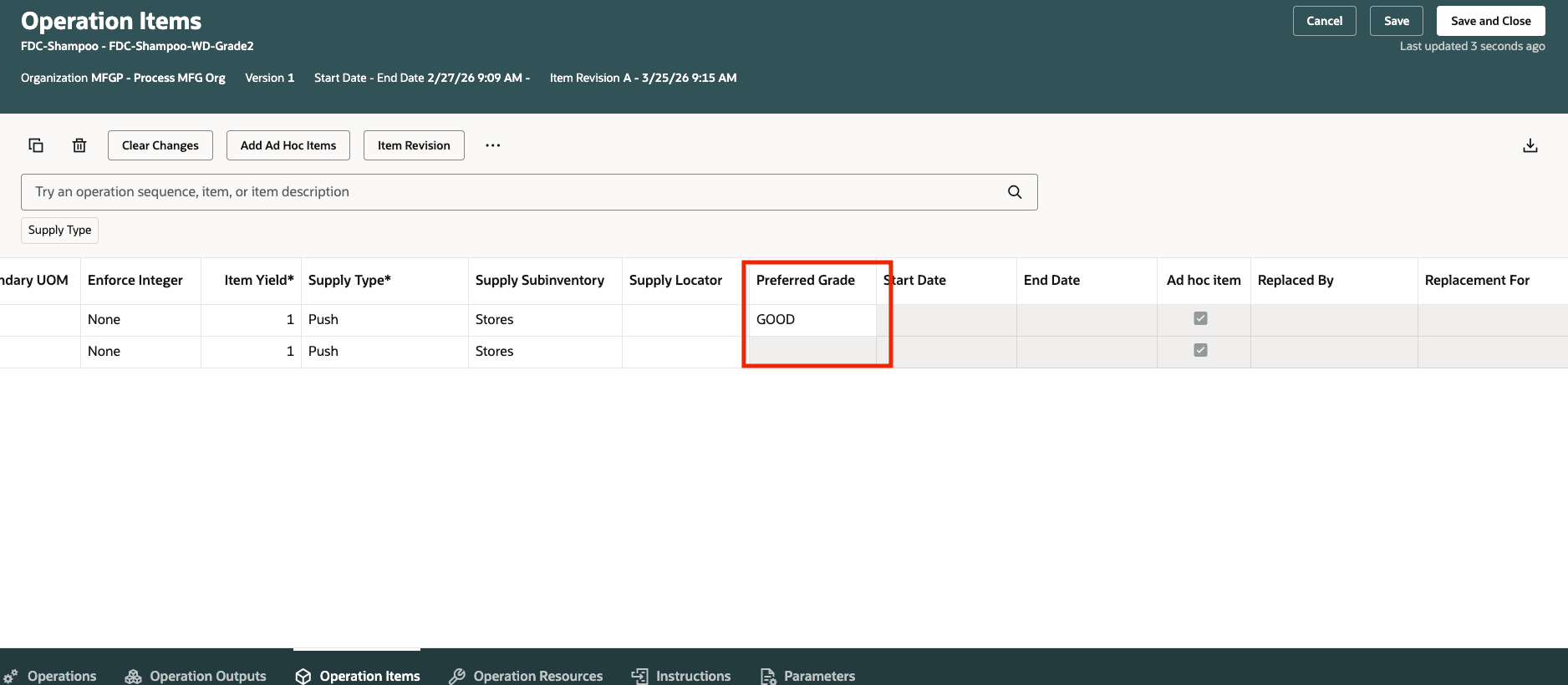

The preferred grade applies to operation inputs and outputs, including primary products, co-products, and by-products. You can leave the value blank when a preferred grade isn't required.
You can use preferred grades to:

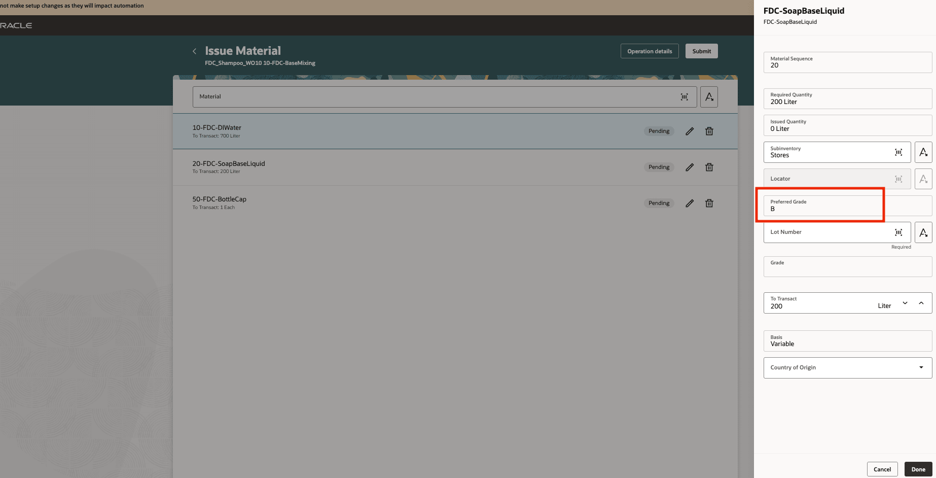

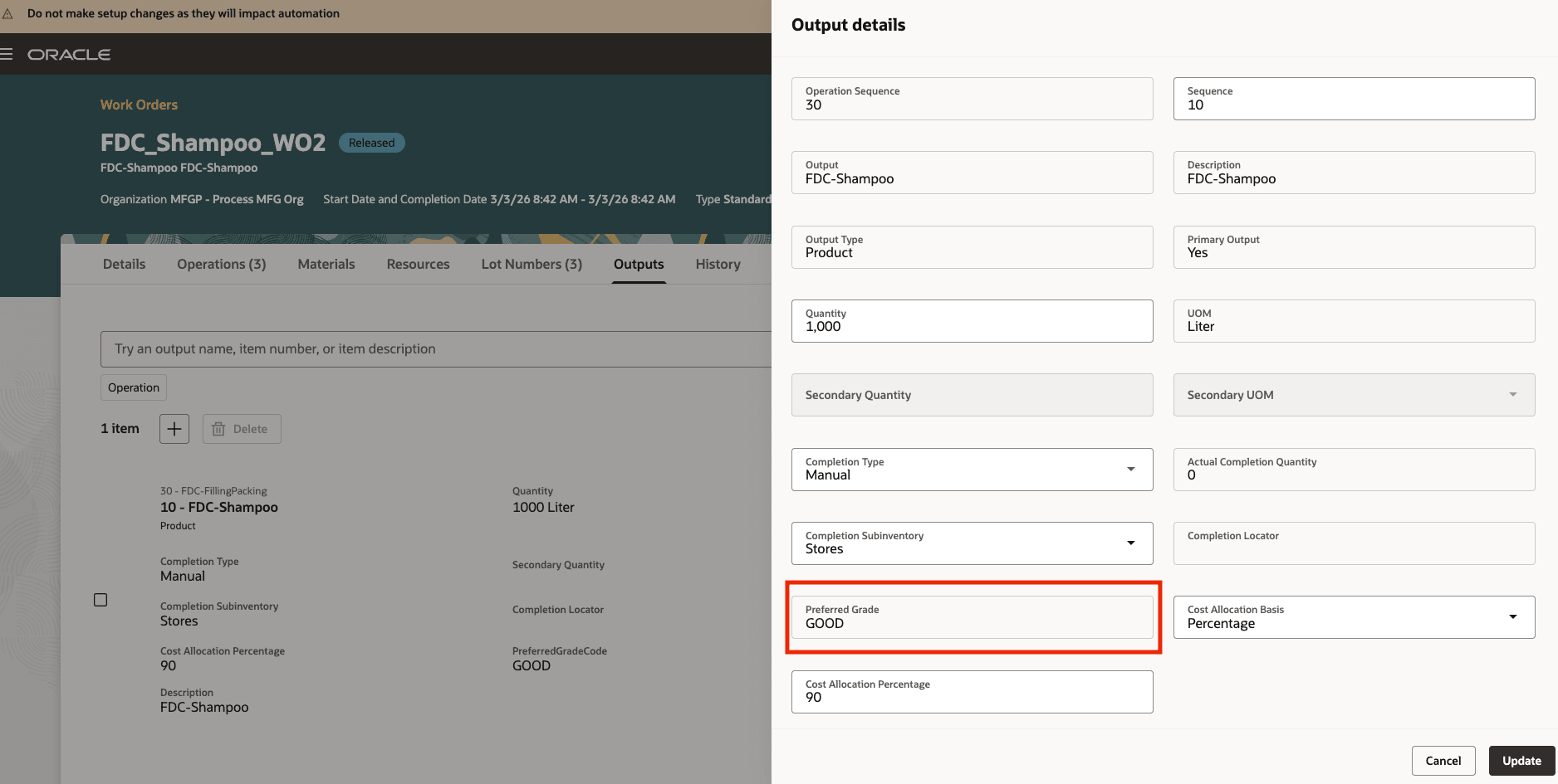

  • Set guidance for your recipes and batches: Use the Recipes page to set the preferred grade for operation outputs and operation inputs. Review the preferred grade details when you create a batch.

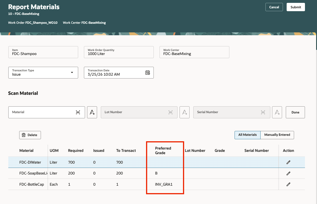

  • Select an applicable lot with a preferred grade for material issue or backflush transactions: Preferred grade guidance is available in Production Execution, Orderless Transactions, Material Transactions, Flow Schedule Completions, Post Production Reporting, and the transaction actions under Production Reporting when using an industrial handheld device.

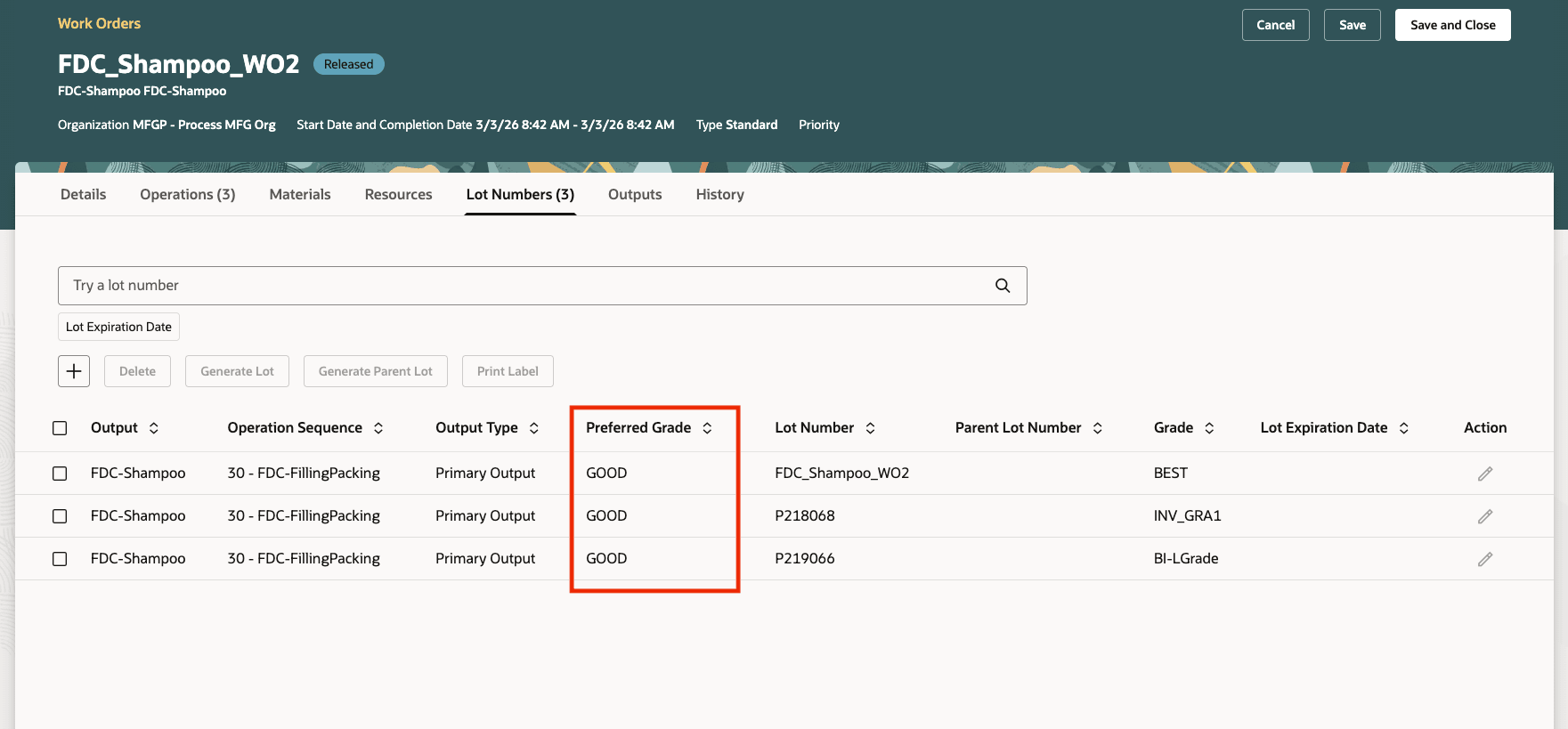

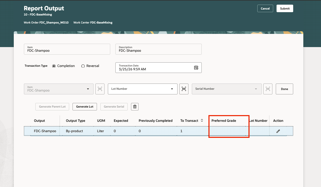

  • Set the preferred grade for a new lot completed into inventory: Preferred grade guidance is available in Production Execution, Orderless Transactions, Material Transactions, Flow Schedule Completions, Post Production Reporting, and the transaction actions under Production Reporting when using an industrial handheld device.
Setting Up Preferred Grade Guidance for Recipe Operation Outputs

Use Preferred Grade Guidance When Reporting Output In Production Execution
Use Preferred Grade Guidance When Reporting Output in Production Execution

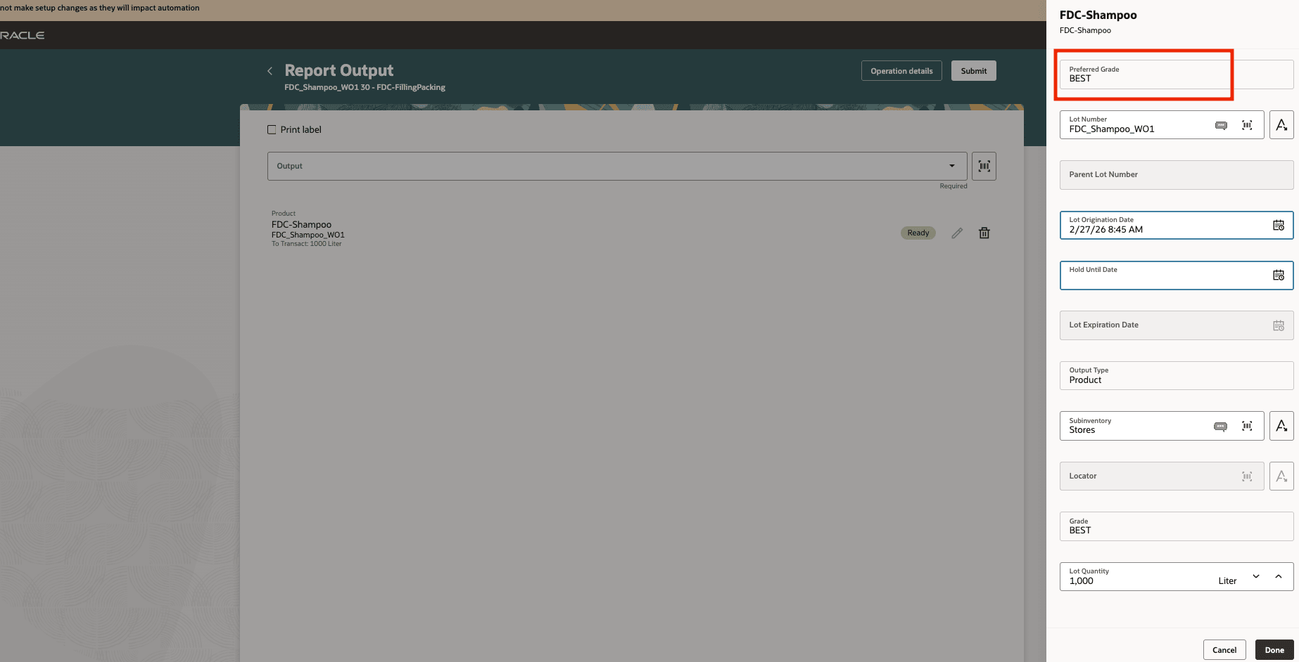

Use Preferred Grade Guidance When Reporting Output Transactions on Mobile Devices
