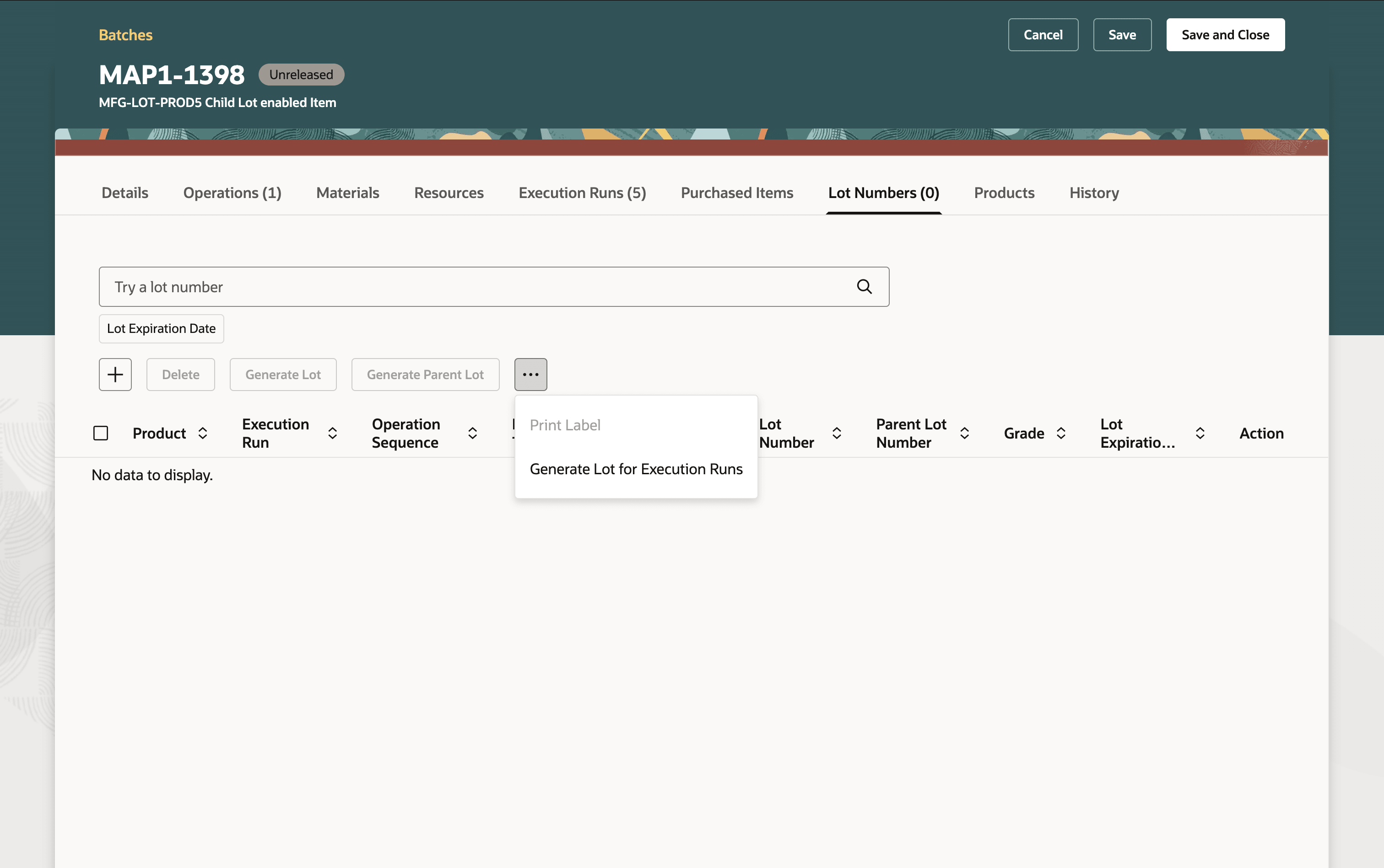

If your batch is split into execution runs, you can now generate unique lot numbers for each execution run using the Generate Lot for Execution Runs option.

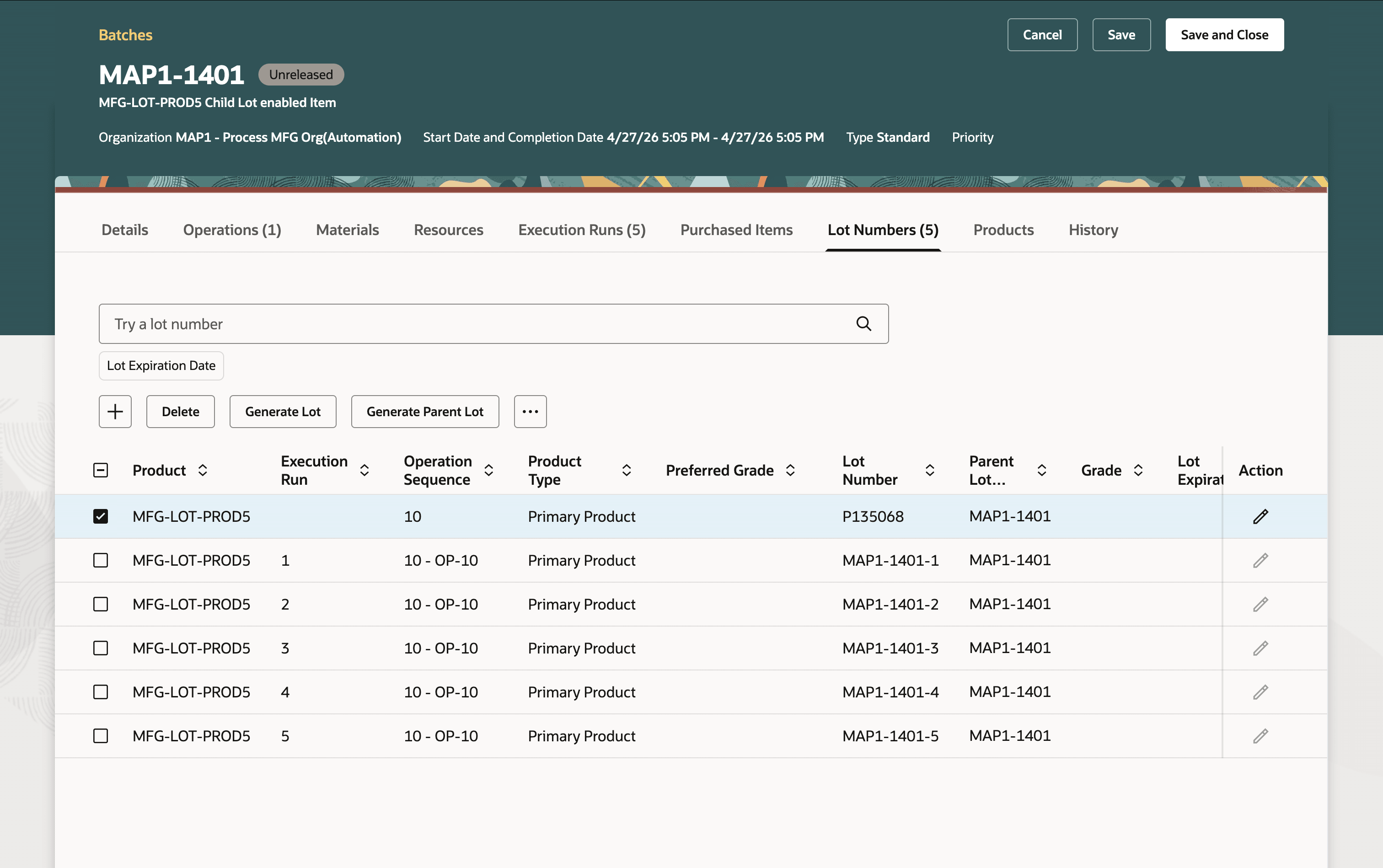

If you have chosen to use the work order number as the Default Lot Number for Product Completion option in the Plant Parameters page, then this option defaults the batch number as the parent lot and appends the execution run number to the batch number for the lot number. You can also add lot numbers that are applicable for all execution runs by leaving the execution run number field blank.
Lot Numbers Generated

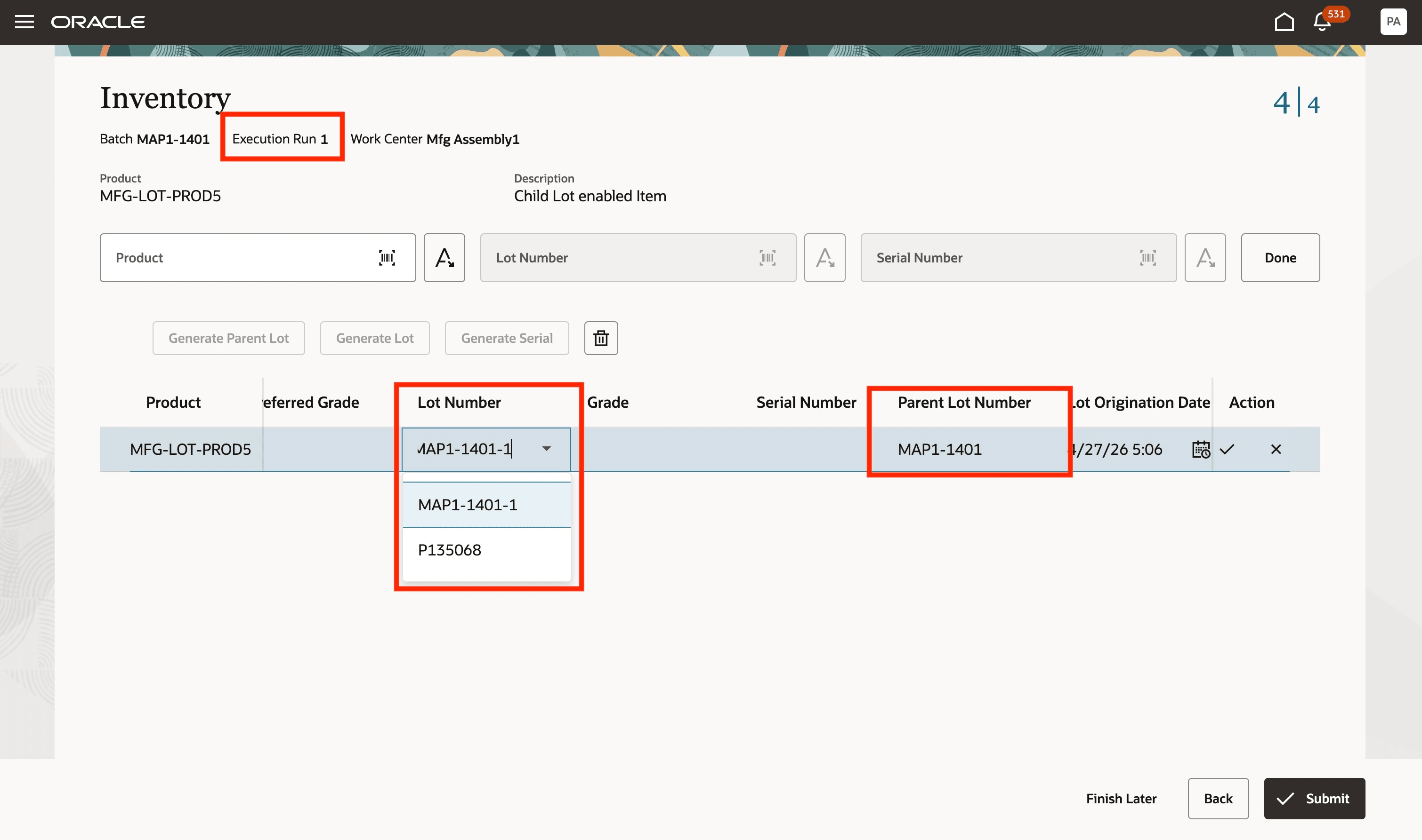

When reporting product completions for a batch with execution runs, you'd see the lot numbers that are associated with that specific execution run and lot numbers that are assigned to the work order without an execution run reference.
Lot Numbers Shown During Product Completions

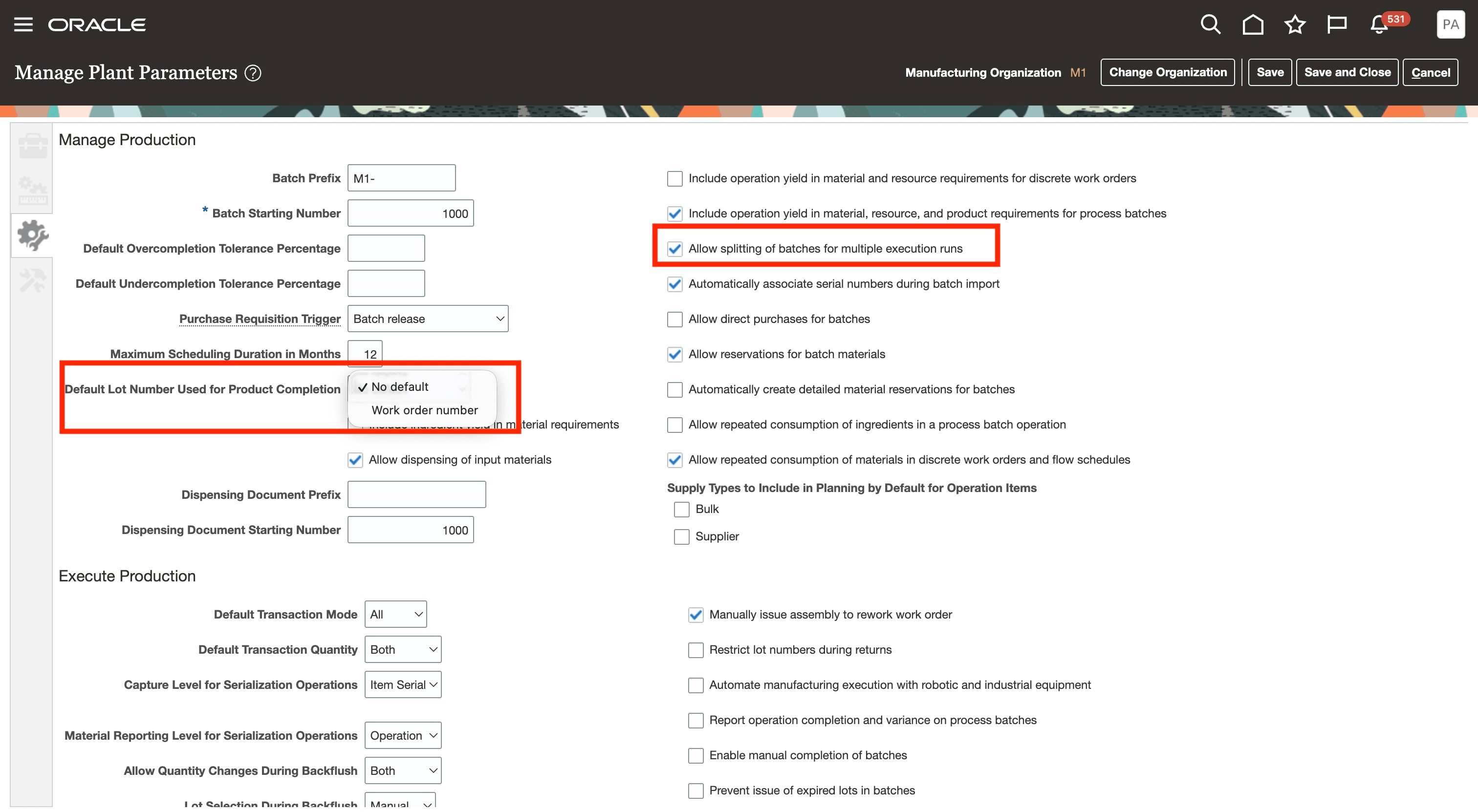

Set up the plant parameters to enable this feature:
- In the Setup and Maintenance work area, search for, and select the Manage Plant Parameters task.
- On the Manage Plant Parameters page, select the required inventory organization.
- In the Work Execution tab, under Manage Production, enable the Allow splitting of work orders for multiple execution runs checkbox.
- If you would like to use the batch number (work order number) as the lot number, ensure that Default Lot Number for Product Completion is set to Work Order Number.
Plant Parameters to Enable the Feature
