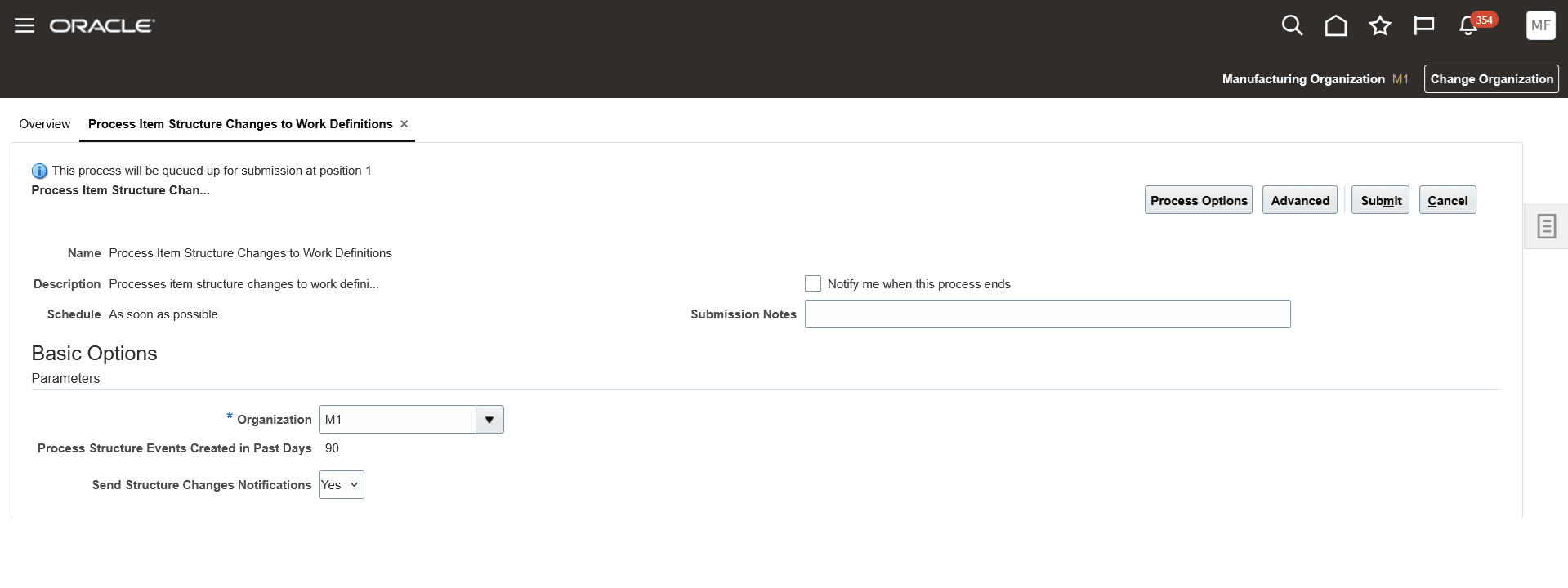

Today, you can optionally run the Process Item Structure Changes to Work Definitions scheduled process to synchronize item structure component changes in the impacted work definitions. Depending on the change, the scheduled process can either directly synchronize the change in existing versions of the impacted work definitions, or send a notification for the user to review and take action.
Before this update, the scheduled process only used the Organization parameter to filter the item structure changes to process. When you ran the scheduled process for the first time, it could slow down system performance.
This update adds the following parameters that provide additional guardrails against scenarios where historical structure changes are also processed:
- Process Structure Events Created in Past Days: Set to 90. Prevents item structure events older than 90 days from being processed.
- Structure Change Notifications: You can choose if you want structure change notifications to be sent for changes that can’t be automatically synchronized.
Additional Parameters for Process Item Structure Changes to Work Definitions

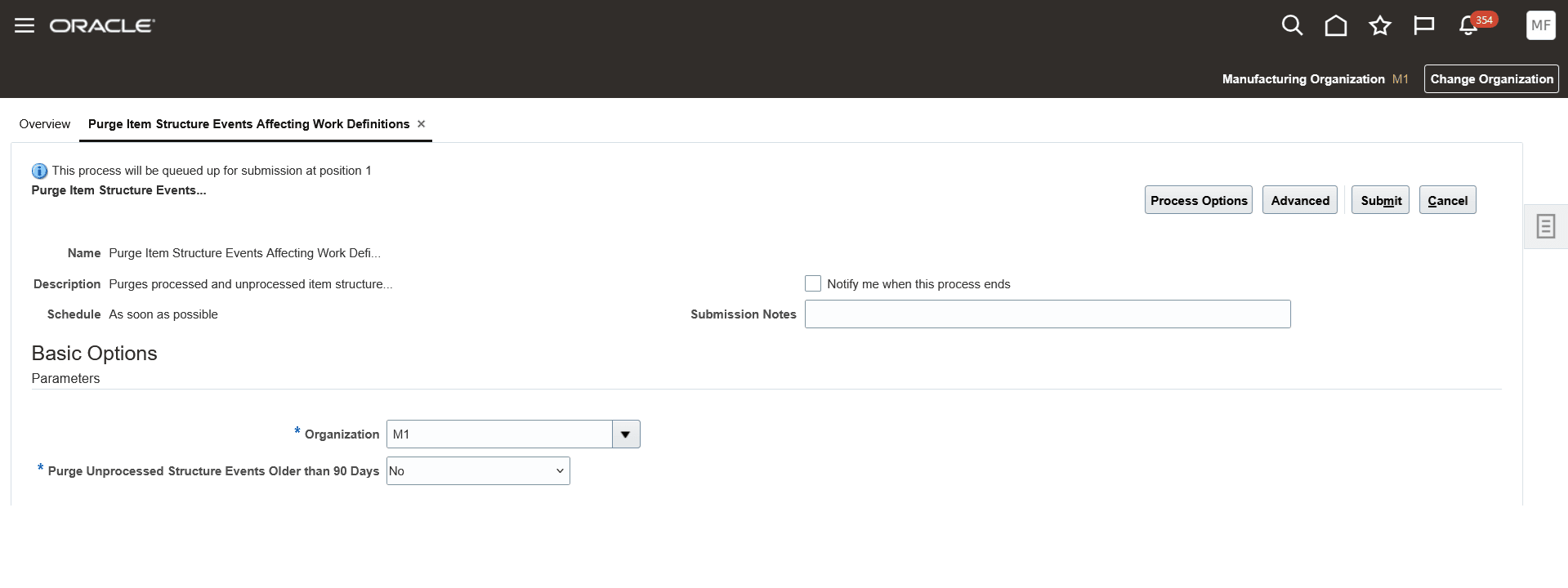

Additionally, this update also introduces a purge mechanism to delete item structure events. You can use the new scheduled process Purge Item Structure Events Affecting Work Definitions to delete item structure events.
- By default, the scheduled process only purges item structure events that were processed.
- You have the option to purge unprocessed item structure events with a creation date older than 90 days.
- Unprocessed item structure events created in the past 90 days can't be purged.
This behavior aligns with the updated Process Item Structure Changes to Work Definitions scheduled process, which only processes item structure events for the past 90 days.
Purge Item Structure Events Affecting Work Definitions Scheduled Process
The additional parameters in the Process Item Structure Changes to Work Definitions scheduled process and the new Purge Item Structure Events Affecting Work Definitions scheduled process significantly reduce the likelihood of excessive historical data processing and prevent uncontrolled data growth.
