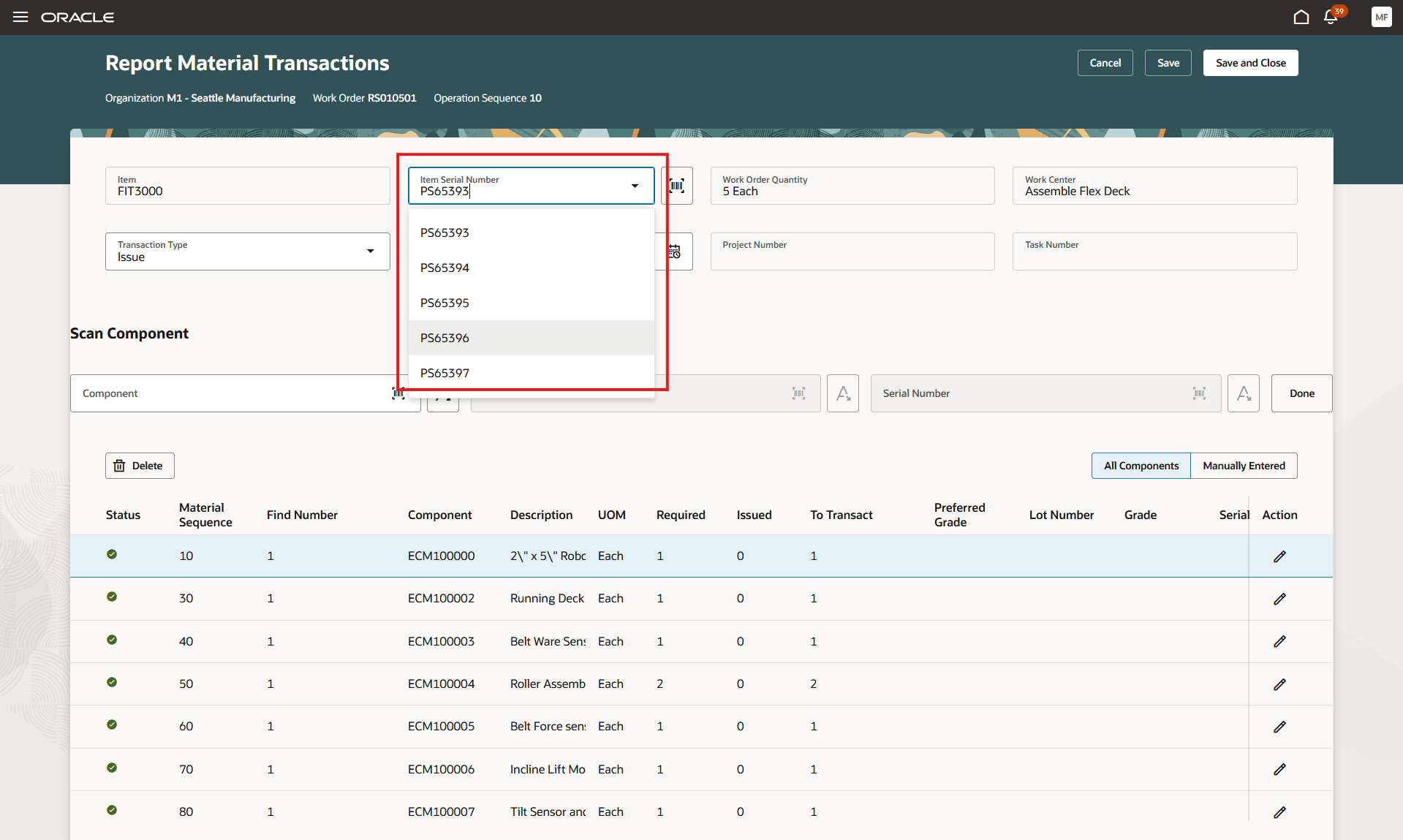

In high-volume serialized manufacturing, operators need to efficiently report material transactions for multiple assembly serial numbers tied to the same work order. Previously, after completing each transaction, they had to query again for the work order, operation, and serial number—adding repetitive steps and slowing down execution tasks.
In the Redwood Report Material Transaction flow, users can now remain in the same transaction context after submitting a transaction for one product serial. After the transaction is completed, the page retains the same work order, operation, and transaction type context so that users can select another product serial and continue reporting material transactions. Users can select a product serial, enter component details, and save the transaction all while staying on the same page.
This enhances the Redwood experience for serialized manufacturing work orders where multiple top-level assembly serial numbers are associated with the same work order. Users no longer need to repeatedly query the work order, operation, and serial number after saving each transaction.
For nonserialized operations, the item serial number isn’t displayed, and the remaining transaction behavior remains the same.

  • Users can select another product serial and save another transaction from the same context.
  • If a transaction was already reported for a product serial, users can still report an ad hoc component issue from the same page.
  • Users can submit a transaction and close the page, similar to the Save and Close behavior in the classic ADF page.
  • Users can choose to cancel to leave the transaction page.
