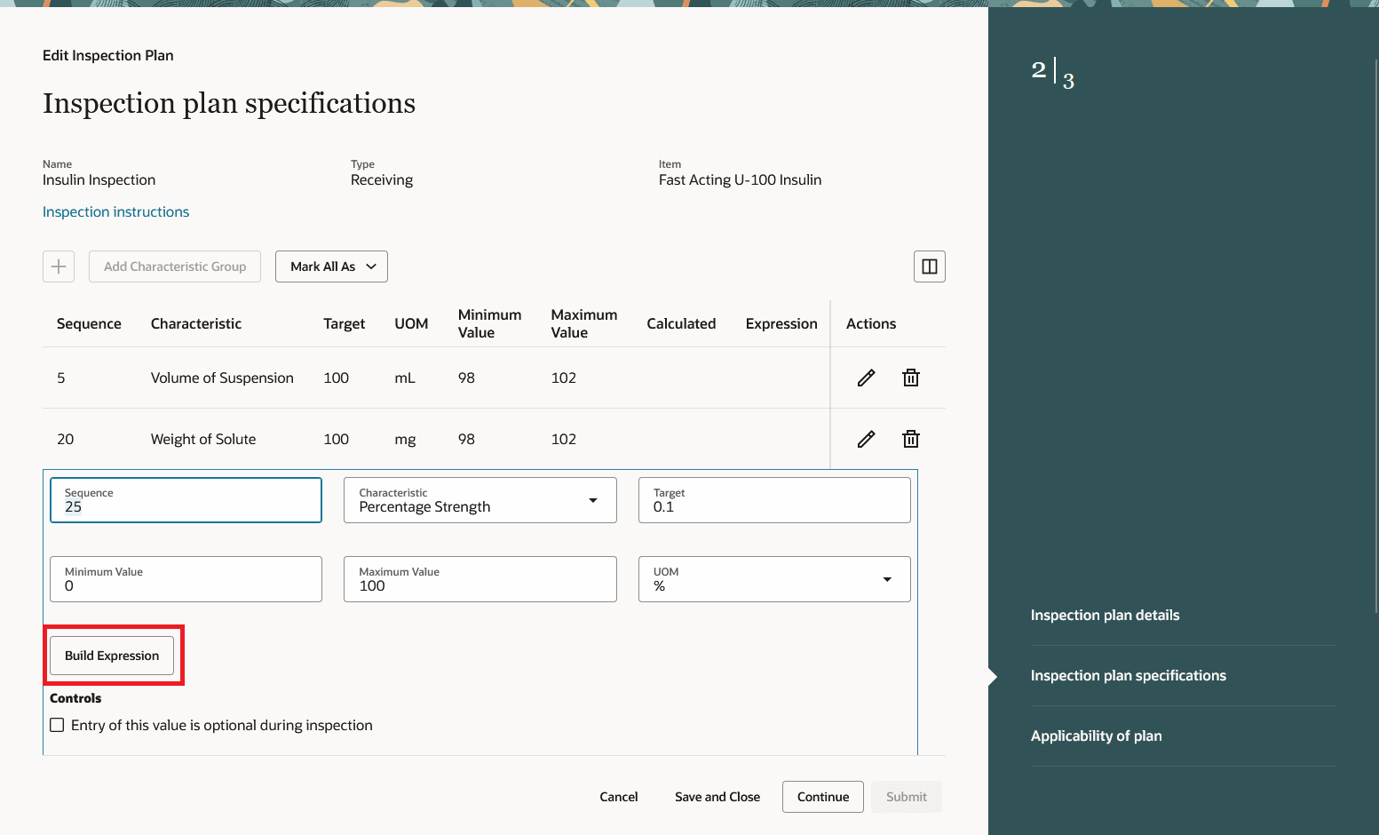

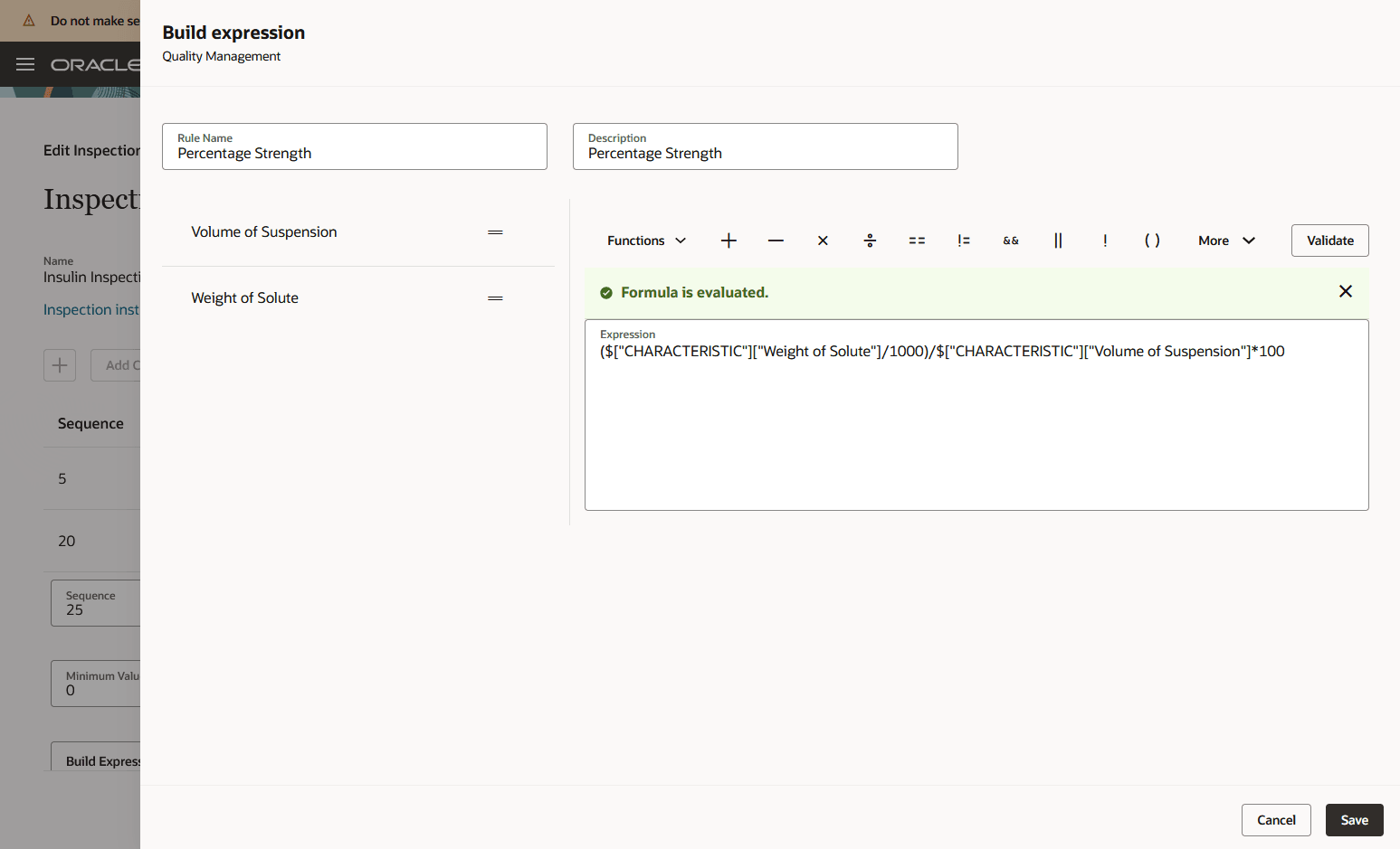

Use the Build Expression action on a characteristic to configure the calculation logic. The defined expression is then used to compute the result value based on other numeric characteristics in the inspection plan.
Choose to Build an Expression to Calculate a Result Value
Use the Expression Builder to define calculations for result values based on other numeric characteristics in the inspection plan.
Once the expression is defined, click Validate to ensure it’s correctly formed.
Expression Builder
Expression Builder

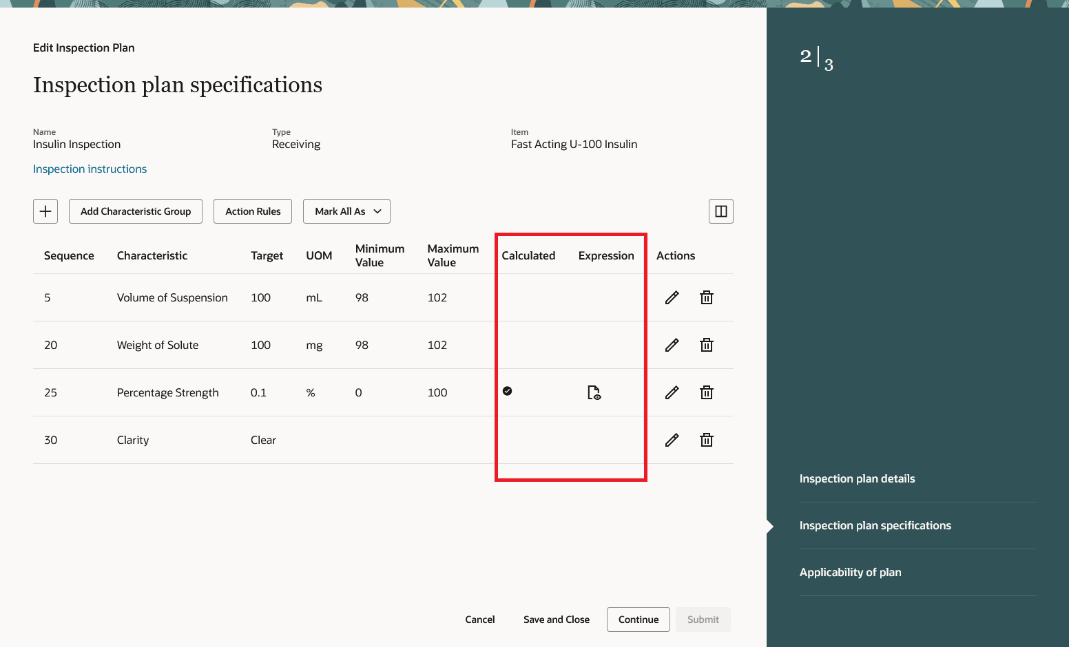

Save the expression and save the specification line.
You’ll see an indicator showing the value is calculated. Click on the icon in the Expression column to view the defined expression.

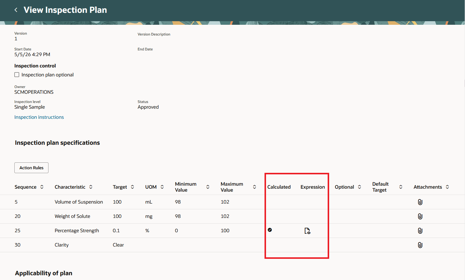

You will see the same indicators and icons when you view the inspection plan.

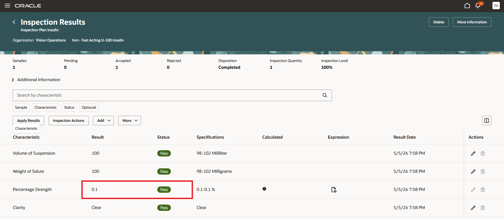

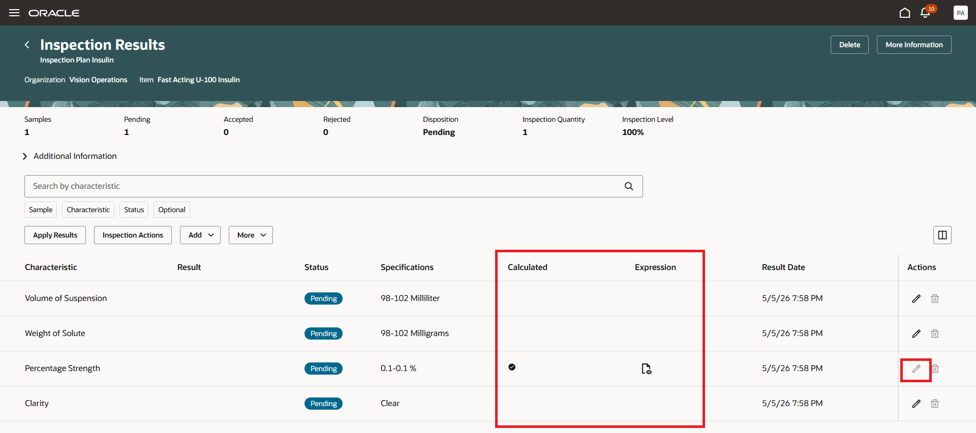

After defining and approving the inspection plan, you can perform inspections where calculated characteristics are automatically derived during execution.
During inspection:
  • An indicator identifies characteristics with calculated results
  • An icon allows you to view the underlying expression
  • Calculated values are read-only and cannot be entered manually
Results Entry
Results Entry
When all inspection results referenced in the expression are entered, the application automatically calculates, displays, and evaluates the derived result value for the characteristic.
Results Entry with Calculated Value

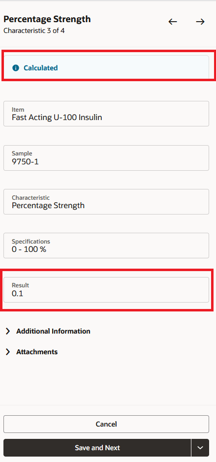

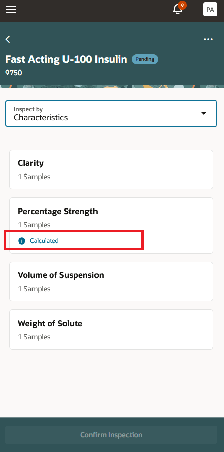

When entering inspection results using the Inspect Goods mobile transaction in Receiving, calculated characteristics are clearly identified with indicators showing that values are automatically derived.
For these characteristics, manual entry of result values is not allowed, ensuring that calculated results are consistently applied during inspection execution.
