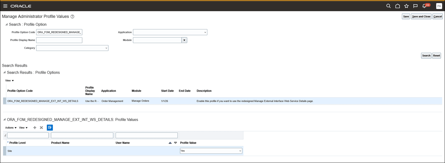

  1. Open Setup and Maintenance and navigate to Manage Administrator Profile Values.
  2. Search for the profile option code ORA_FOM_REDESIGNED_MANAGE_EXT_INT_WS_DETAILS and enable it at the site-level by setting the profile value to Yes
  3. Click Save and Close.
This is the Manage Administrator Profile Values page where you search and enable the profile option.
Setting Profile Value

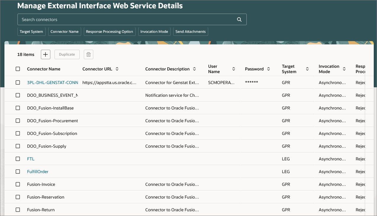

  1. Once the profile is enabled, the new Redwood Manage External Interface Web Service Details page opens where you search for the connector you add a new connector.
Landing Page

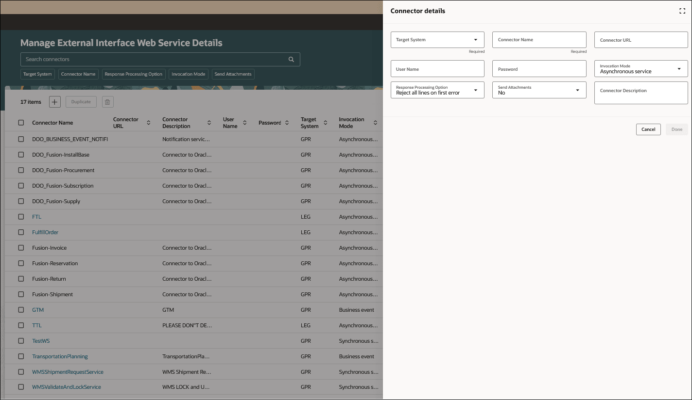

  1. Click the + button and the Connector details drawer opens.
Creating a New Connector
  1. Add your details and click Done.
Enter Connector Details and Click on Done.

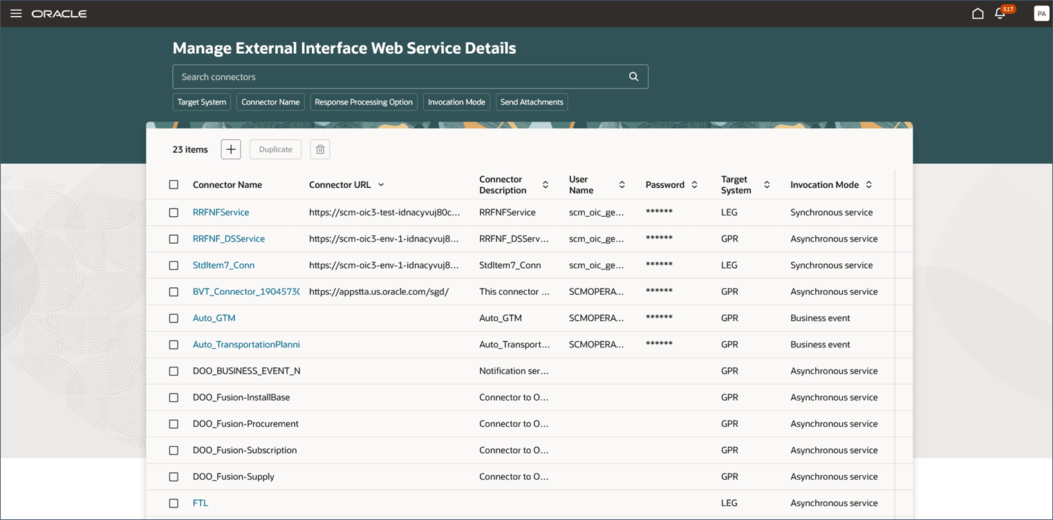

  1. Confirm new connector details back on the manage web service landing page.
Connector information saved and displayed
