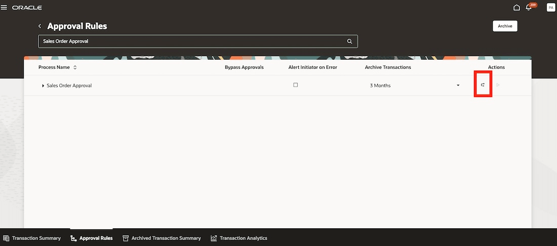

1. From the Home page, go to Tools and select the Transaction Console task.
2. On the Transaction Console Summary page, open the Approval Rules tab.
3. Search for the Sales Order Approval process.
4. Click the Configure Rules action, and then click Configure in the dialog box. You will land on the Manage Participants page.
Approval Rules

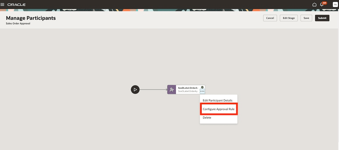

5. Use the Configure Approval Rule action to navigate to the rules page.
Manage Participants

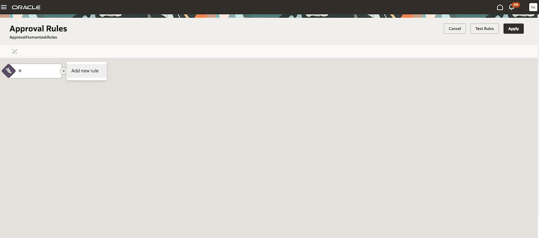

6. Use the Approval Rules page to add a rule and build your rule conditions.
Add new rule

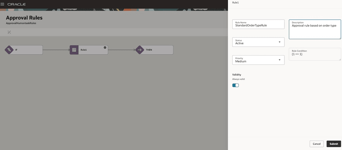

7. Enter basic rule definition information such as rule name, rule description and set the rule status. You can set the rule validity to always valid. If the rule is not set to always valid, from and to dates will appear where you can set the date effectivity for the rule. Click Submit. Note that the rule name does not support spaces or special characters.
Basic rule information

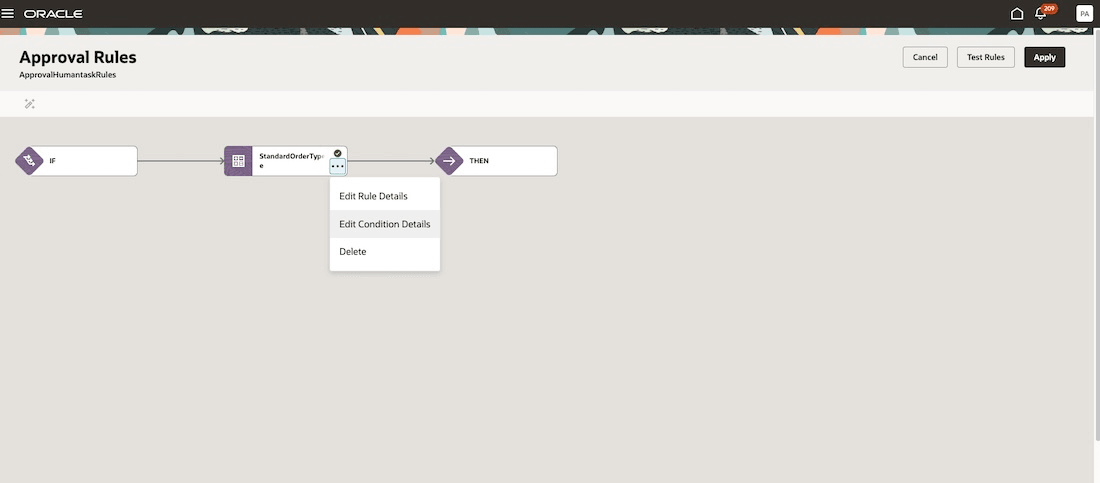

8. Click on the box representing the rule to edit/define rule conditions.
Add rule conditions

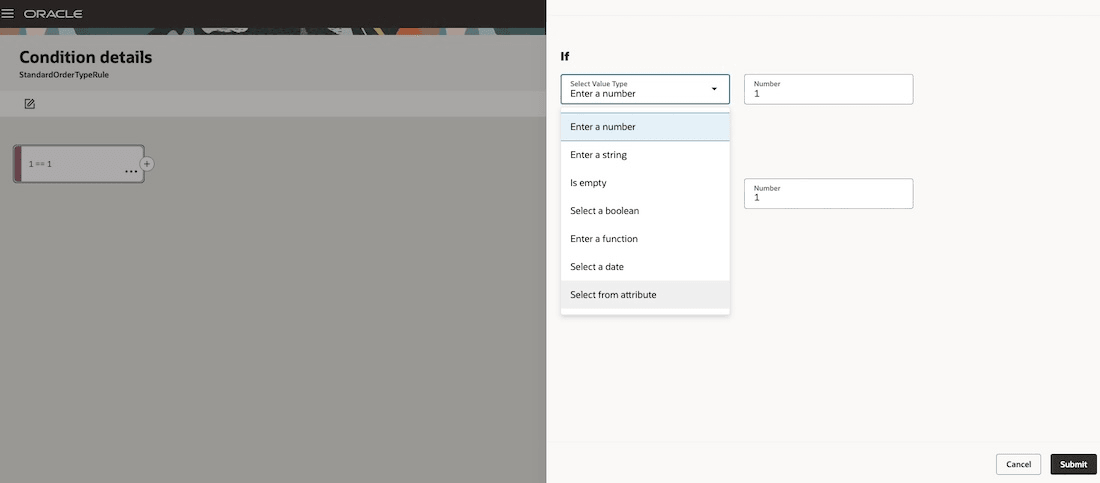

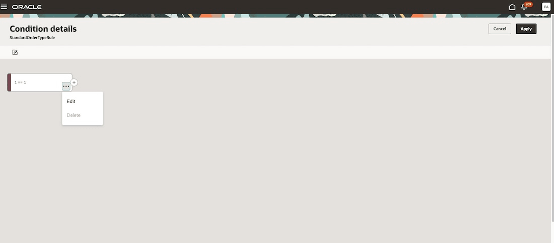

9. In the rule Condition details page click Edit to modify or define rule conditions.
Rule condition details
10. In the If condition builder, you should use the Select from attribute value from the Select Value Type field, to use sales order attributes in your rule conditions.
Rule If condition

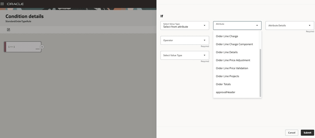

11. The Attribute field displays all the sales order entities such as the Order Header (the order header is called the approvalHeader in the list of values), Order Lines, Order Line Details, Order Charges etc. If you have enabled extensible flexfields, this list also displays all deployed EFF contexts based on which you can define approval rule conditions.
Order entities available for rules

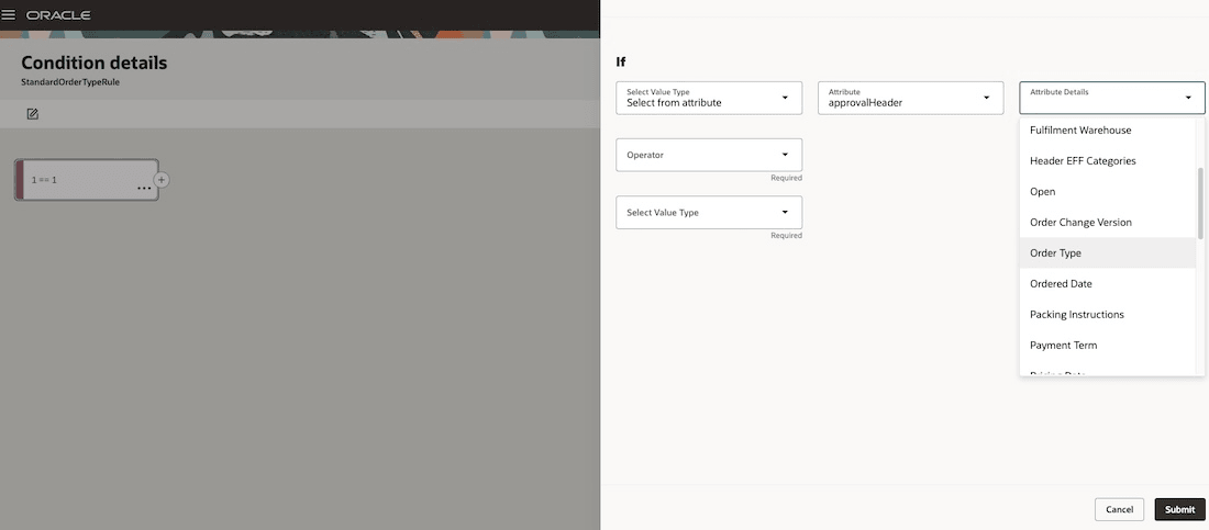

12. Since this example is about creating a rule based on order type which is an order header attribute, select approvalHeader. This displays all order header attributes that you can use in your approval rule conditions. If instead of a standard order entity such as Order Line or Header you had chosen an EFF context in the previous step, you will see the list of EFF segments belonging to the selected contexts.
Attributes available for rules

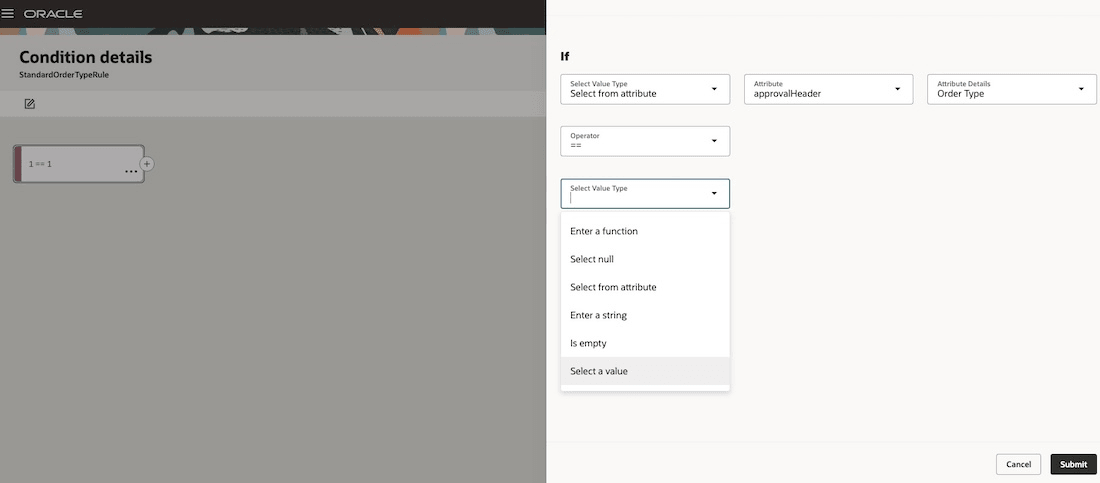

13. In the second Select Value Type field you should choose Select a Value since the condition we are building is based on an order type value.
Rule conditions

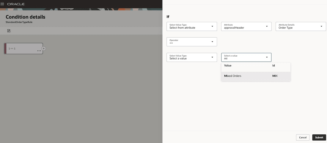

14. Another field opens with a list of all valid order type values. You can enter a few characters of the order type or select from the list.
Attribute list of values

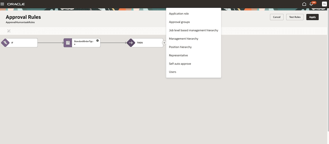

15. Click Submit on the condition builder, and use the Then node to set up how the approval request is to be routed.
Approval assignment
