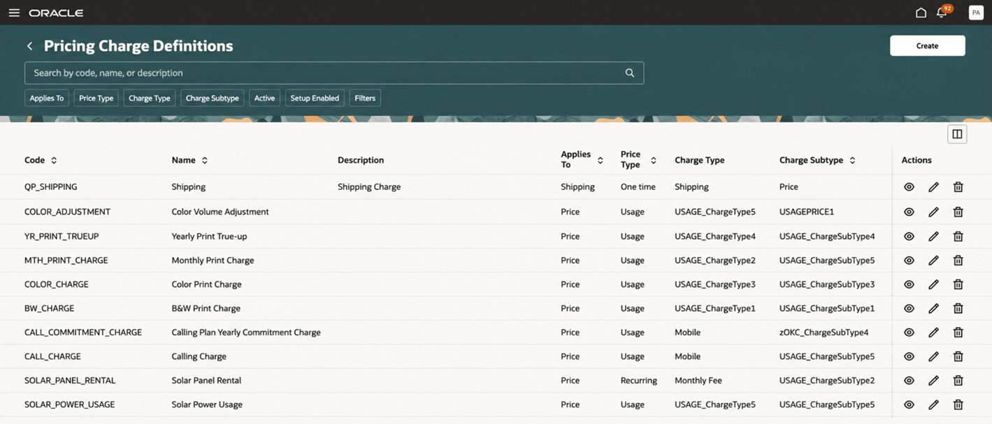

The page introduces a search experience with a single search box for code, name, or description, filter chips for key attributes, and direct actions to create, view, edit, or delete charge definitions.
Start on the redesigned Pricing Charge Definitions page, where you can search for existing definitions, refine the results with filters, or select Create to begin a new definition:

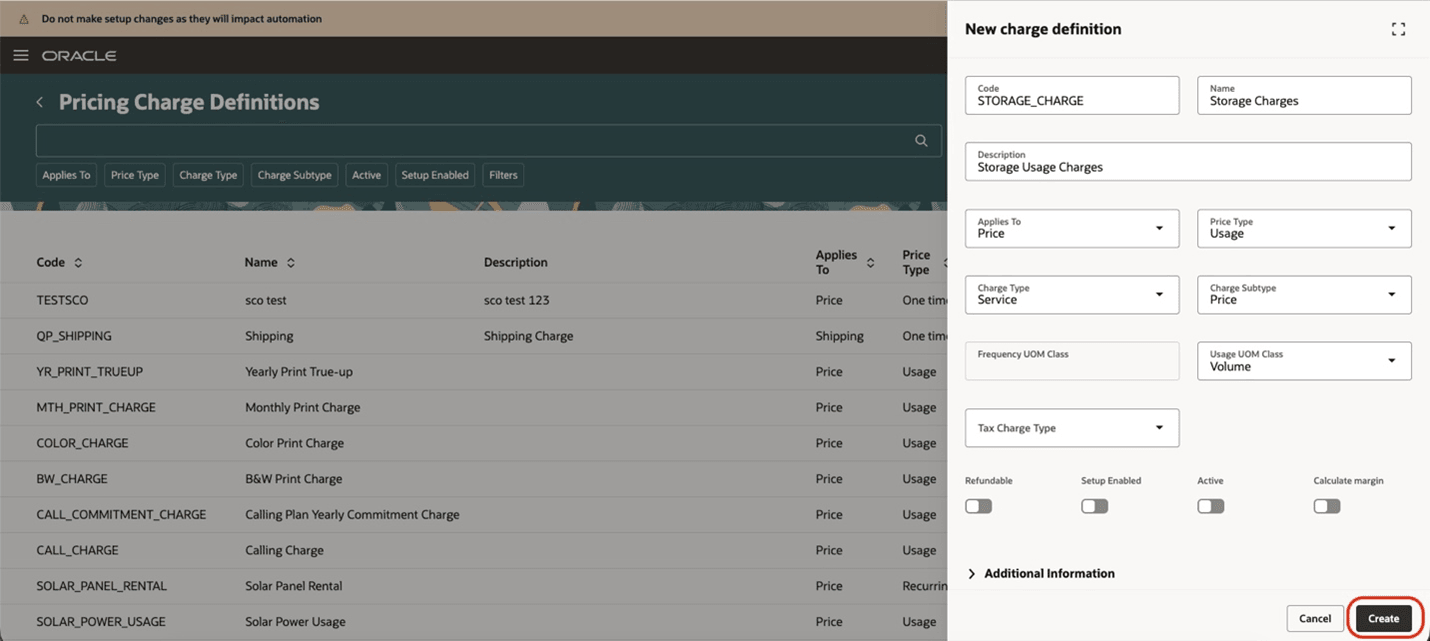

When you click Create Charge Definition, Redwood opens a side panel where you can enter the charge definition details, including code, name, description, applies to, price type, charge type, charge subtype, UOM classes, and related setup options:
New Charge Definition Page Showing All Required Fields

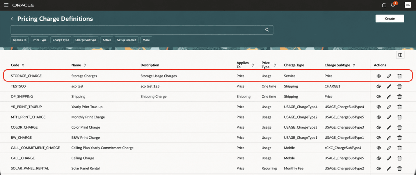

After you enter the required values, click Create to add the charge definition without leaving the Redwood page:
Charge Definitions Page with Newly Created Charge Definition
