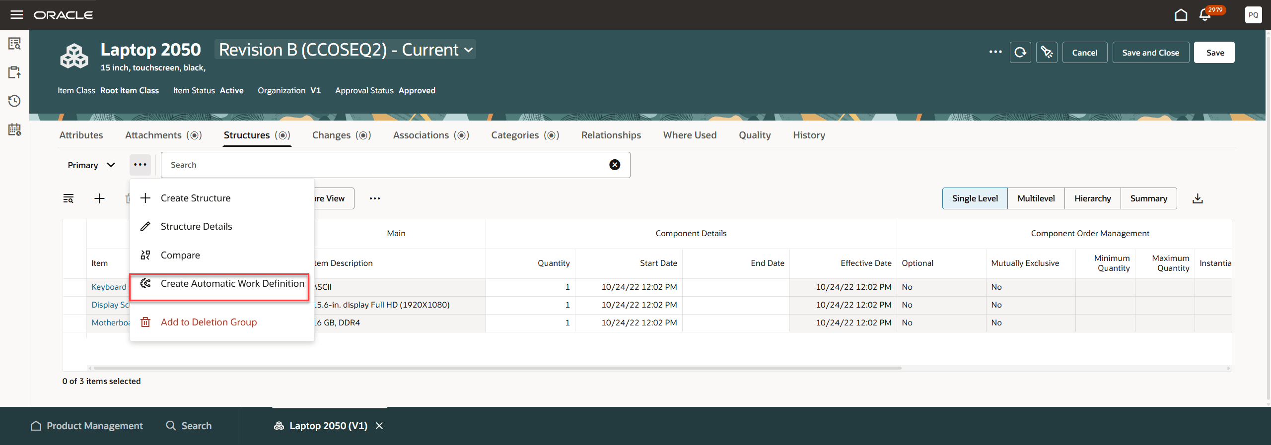

A new Create Automatic Work Definition action on the structure now generates the work definition directly from an item’s primary structure when the eligibility criteria are met.
Here’s the eligibility criteria, including the fields and corresponding values:
Eligibility Criteria to Create Automatic Work Definition

Validation rules are enforced before the action can be taken. If the required criteria aren’t met (for example, the structure isn’t approved, there’s a mismatch in structure type or item type, or Assemble to Order requirements aren’t satisfied), the action is disabled.
When the action is executed, the application generates the work definition. Additionally, the application validates prerequisites such as the existence of a valid work center and valid standard operation, prior to creating the definition.
Create Automatic Work Definition Action on a Structure
