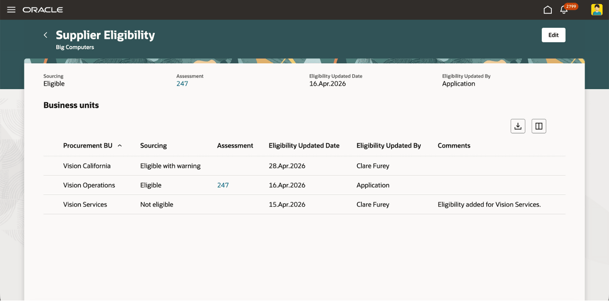

View Supplier Eligibility
The supplier-level sourcing eligibility is displayed in the header along with the associated assessment (when available), and the date when the eligibility was last updated.
The table in the Business units section shows the sourcing eligibility across business units (BUs). If an eligibility exists at the BU level, then it's used first to determine the sourcing eligibility of the supplier, else the header supplier-level eligibility is used. Select the assessment reference to navigate to the Assessment page to view and understand how eligibility was determined.
When an assessment is evaluated for a given supplier within a BU, and the sourcing eligibility is enabled in the associated qualification model, then the supplier's eligibility is determined based on the assessment outcome. If the associated qualification model also has Share eligibility enabled, then the overall supplier-level eligibility is also updated. Otherwise, only the BU-level eligibility is updated.

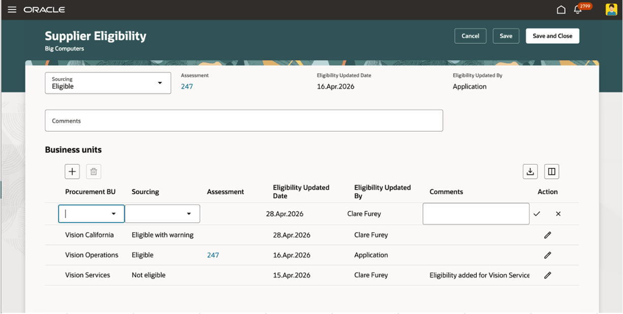

Edit Supplier Eligibility
You can update the overall supplier-level or BU-level eligibility and add comments to explain the change. You can also create a new BU-level sourcing eligibility entry by adding a new row for a BU and supplier's eligibility value in the field 'Sourcing'.
For example, if a supplier's assessment has expired and their eligibility needs to be updated, then you can modify the value and provide supporting comments. Similarly, if a supplier is evaluated for a new BU, then you can manually add the eligibility and use it during the sourcing process.
