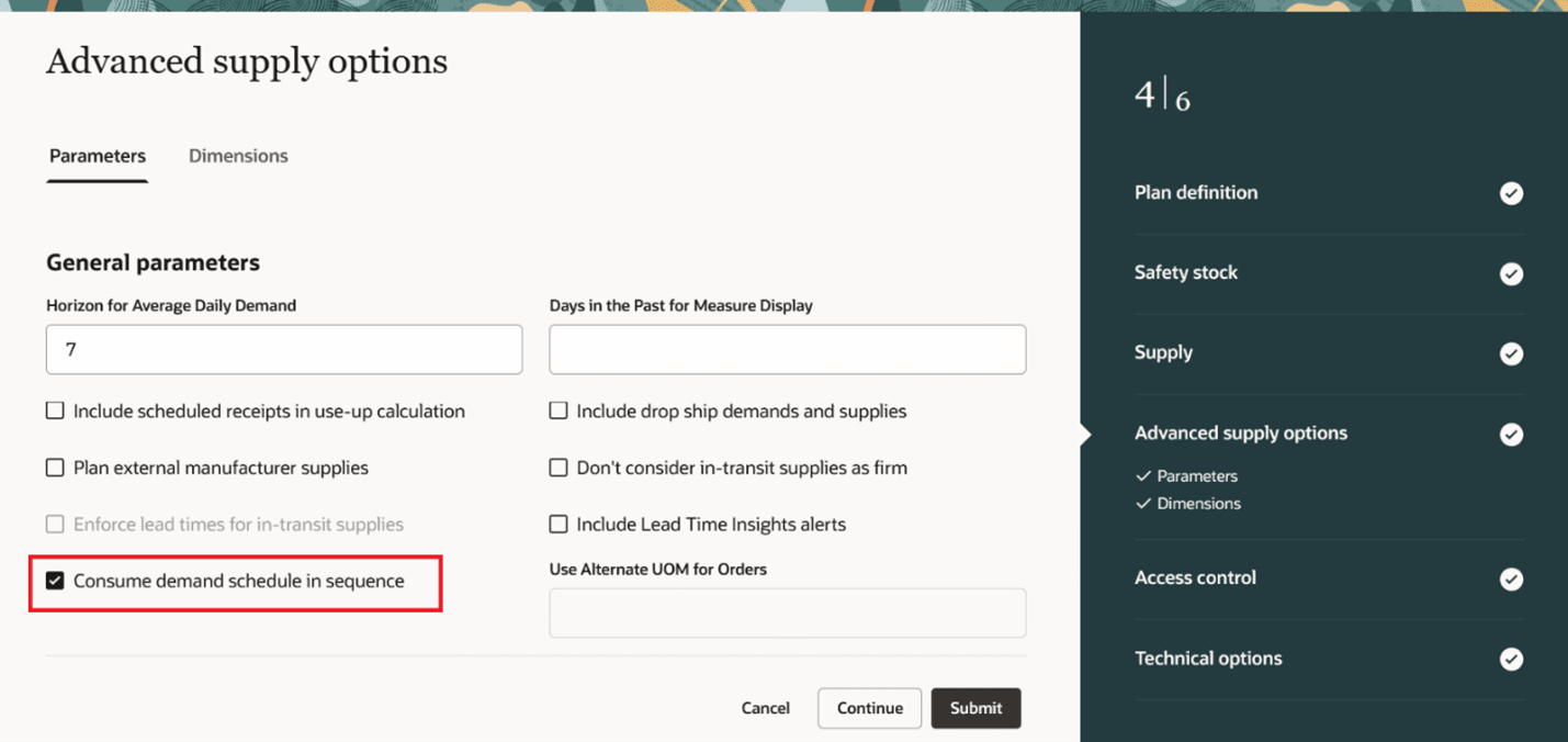

To enable the new behavior, you need to select the advanced plan option Consume demand schedule in sequence. By default, this option isn’t selected. The navigation is, Supply Chain Planning -> Select the plan -> Edit Plan Options -> Advanced supply options.
New Advanced Supply Option: Consume Demand Schedule in Sequence

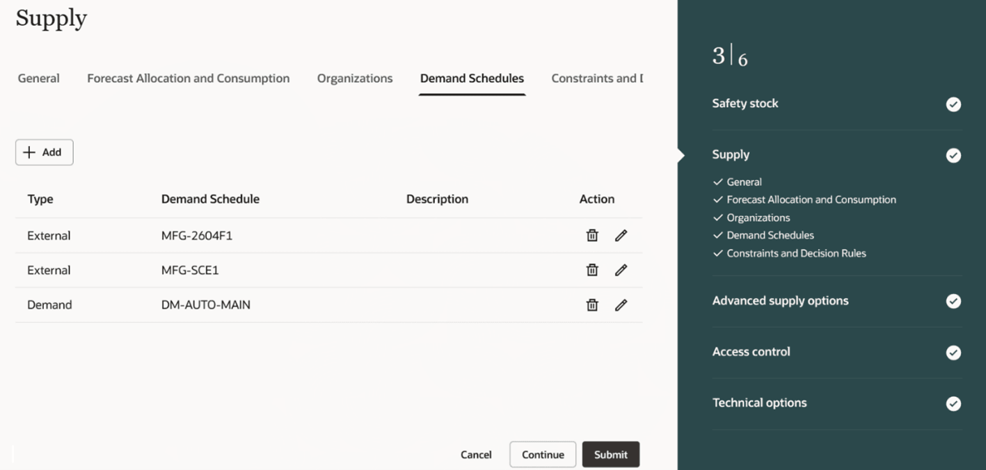

Following are the demand schedules for a supply plan:
Demand Schedules for a Supply Plan
Following are the details of demand schedules in the plan. There is a sales order for item RA_ASSY in the organization M1 of quantity 100.
Demand Schedules

Previously, the sales order consumed the forecast quantities from each demand schedule independently. With this update, the sales order consumes the forecast from the first demand schedule as entered in the plan options. In this case, demand schedule MFG-2604F1 is first in the order, so it is consumed first and the entire forecast quantity of 50 is consumed. There is still more forecast quantity to be consumed as sales order is of quantity 100, so Supply Planning proceeds to consume the next demand schedule in order and consume the remaining forecast from MFG-SCE1. No forecast is consumed from the demand plan DM-AUTO-MAIN as sales order has consumed all the forecast.
Use Case 2
In the same setup as of use case 1, let’s consider that you want to change the sequence of consumption. For example, you want to consume the demand schedule MFG-SCE1 first, then demand plan DM-AUTO-MAIN and then MFG-2604F1. Then, you need to delete the demand schedule MFG-2604F1 from the plan options, save, and add it again. After doing this, the demand schedule sequence becomes:
Changed Demand Schedule Sequence

Steps to enable and configure
Tips and considerations
- This feature is supported for both unconstrained and constrained supply plans.
- This feature is supported for Supply plan and Demand and Supply plan types.
- If the advanced plan option Consume demand schedule in sequence isn’t selected, then the plan will follow the behavior prior to this update.
