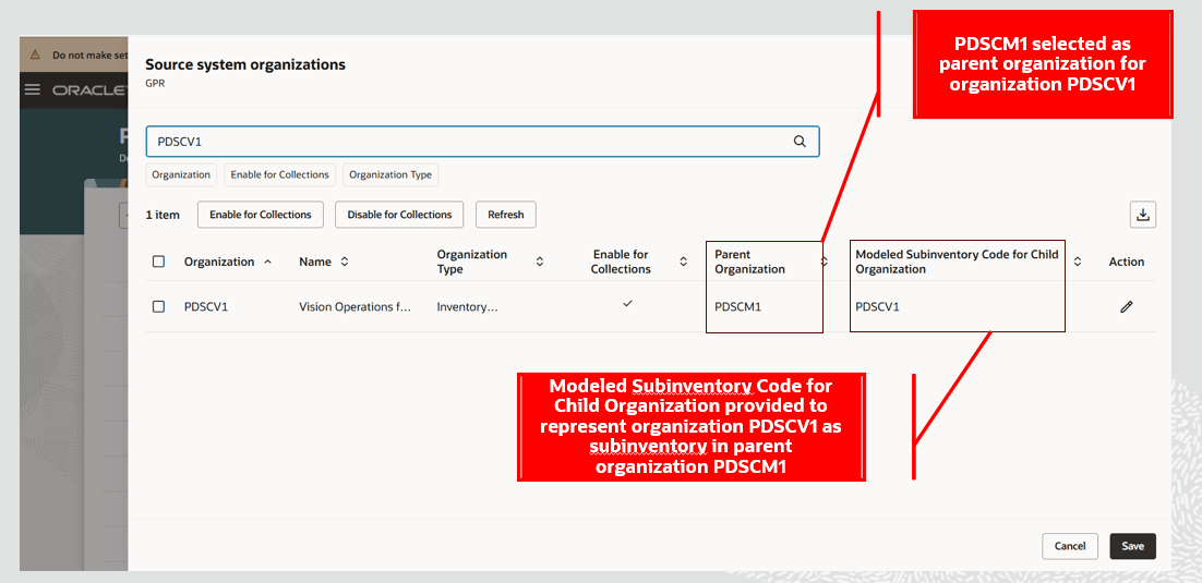

  1. On the Planning Source System page, select the parent organization for ancillary warehouses or child inventory organizations.
  2. Enter the modeled subinventory code for each child organization.
Setup Parent and Modeled Subinventory in Planning Source Systems

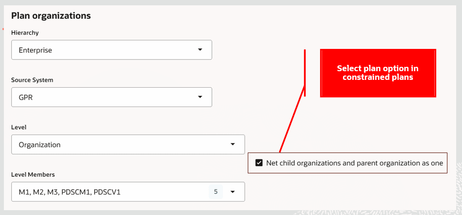

  1. Select the plan option Net child organizations and parent organization as one.
Plan Option Selected in Constrained Supply Plan

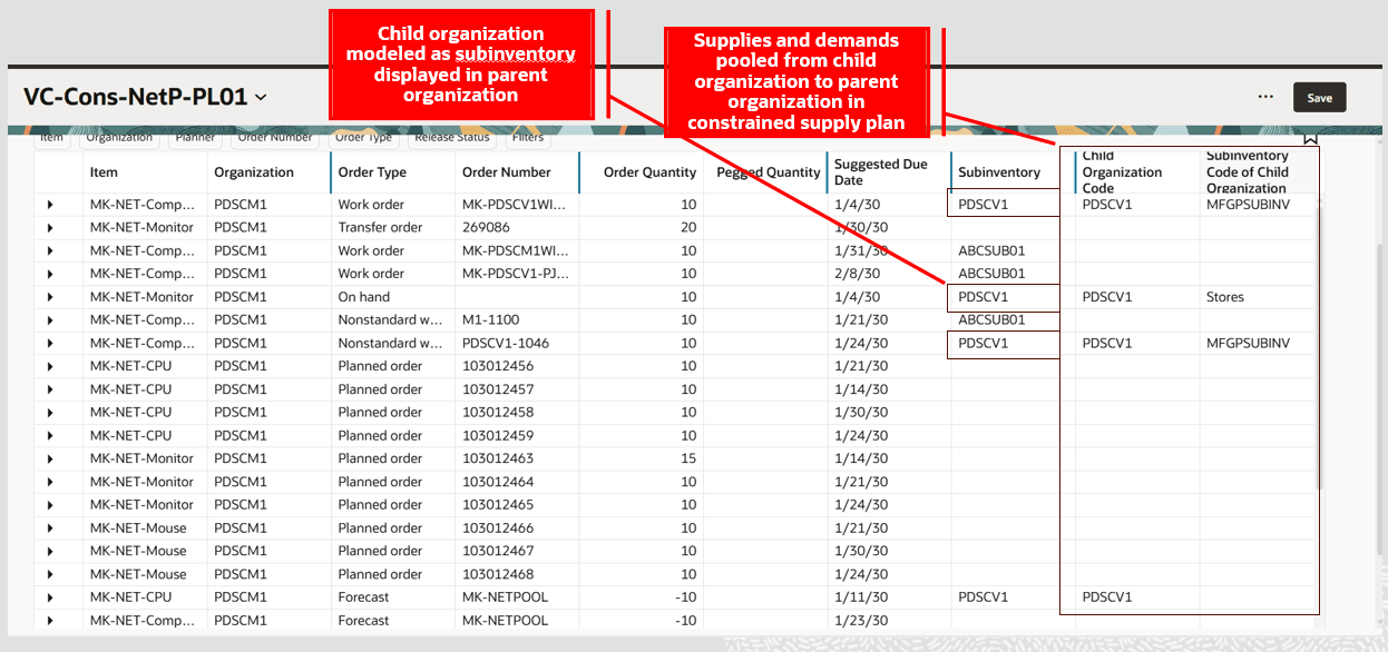

The Supplies and Demands page displays the pooled supplies and demands using the following additional columns:
  • Child Organization Code: Organization code of the child organization from which supplies and demands are recast to the parent organization for pooling and netting.
  • Subinventory Code of Child Organization: Subinventory code of the supplies in the child organization.
Supplies and Demands Pooled from Child Organization to Parent Organization and Planned in Constrained Supply Plan
In the given example, on hand supply at PDSCM1 for 10 units on 1st January 2030 is pooled from child organization PDSCV1 and displayed in modeled subinventory PDSCV1.
Similarly, for forecast MK-NETPOOL, demand on 11th January 2030 from child organization PDSCV1 is recast to parent organization PDSCM1 and planned. Note that the subinventory code of the child organization PDSCV1 is displayed for the forecast.

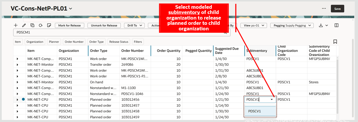

Planned orders are always recommended in the parent organization. In the example, planned orders are recommended in parent organization PDSCM1. You can either release planned orders to SCM in the parent organization or select the subinventory code of a child organization to release planned orders to create supplies in the child organization in SCM.
Select Modeled Subinventory of Child Organization to Release Planned Order to Child Organization
In the above example, select modeled subinventory PDSCV1 or the child organization PDSCV1 in parent organization PDSCM1 for the planned order to release planned order to SCM Cloud to create supply in PDSCV1 organization.
