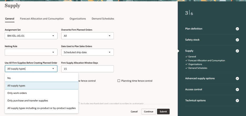

Couple of new plan options Use All Firm Supplies before Creating Planned Order and Firm Supply Allocation Window Days are introduced in Supply Chain Planning -> Plan Options -> Supply -> General tab.
New Plan Options
New Plan Options
If the plan option, Use All Firm Supplies before Creating Planned Order is set to:
  • No: Supply Planning creates planned orders without using the firm supplies in future in order to satisfy the demand on time. This was the behavior prior to this update. This plan option value is the default value.
  • All supply types: Uses all types of firm supplies before creating new planned orders. This includes work orders, non-standard work orders, purchase orders, transfer supplies, and firm planned orders. This option includes all firm supplies except byproduct and co-product supplies.
  • Only work orders: Only future firm work orders are considered before creating new planned orders. This includes all types of work orders including discrete, process and flow. Firm supplies of other order types aren’t considered if this option is selected.
  • Only purchase and transfer supplies: Only firm purchased, and transfer supplies are considered before creating new planned orders.
  • All Supply Types Including Co-product/By-product Supplies: All firm supplies (including byproduct and co-product supplies) are used before creating planned orders. Supply Planning doesn’t reschedule byproduct and co-product supplies. They follow the scheduling of the supply that generates them. This choice allows these supplies to be netted for earlier demands. This may cause late demands but may reduce overall inventory.
You can specify the number of days in which you want to consider the firm supplies in the plan option Firm Supply Allocation Window Days. Supply plan considers the firm supplies starting from plan start date till the number of days specified in this option. If the firm supplies are beyond this window, then Supply Planning can create planned orders to satisfy the demand on time. If you don’t provide any value in the plan option Firm Supply Allocation Window Days, then the firm supplies are considered throughout the planning horizon.

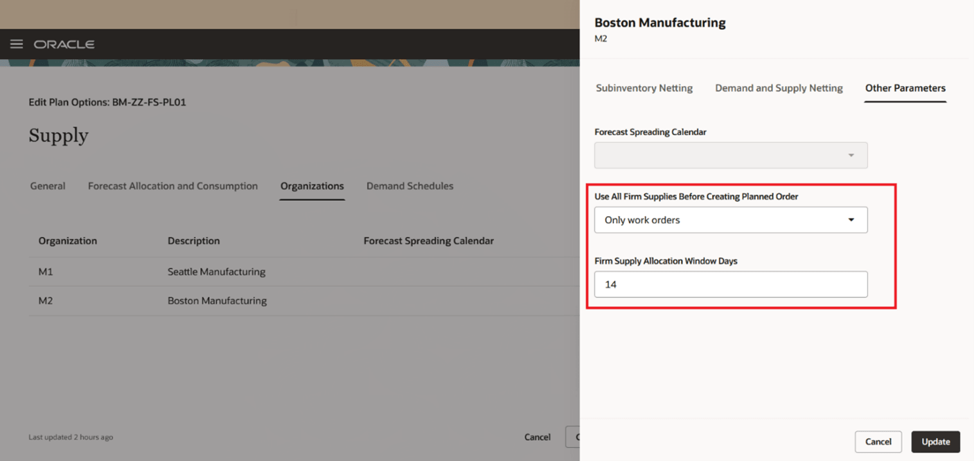

The above two plan options are also provided for each planned organization. The values provided at organization level are more granular and plan will respect the organization level parameters if they are different from the plan level parameters. If there are no value provided at organization level parameters, then plan level value is considered.
New Plan Options for Organizations
For example, consider that the plan level option Use All Firm Supplies before Creating Planned Order is selected as All supply types, and none of the values is selected at Organization parameters for this option. Then, Supply Planning respects the plan level option and all firm supplies in the Firm Supply Allocation Window Days are considered before creating planned orders. Now for organization M2, if you select the option Use All Firm Supplies before Creating Planned Order as Only work orders and Firm Supply Allocation Window Days as 14, then for this organization, only firm work orders within 14 days from plan start date are considered. For organization M2, the plan level options are ignored.

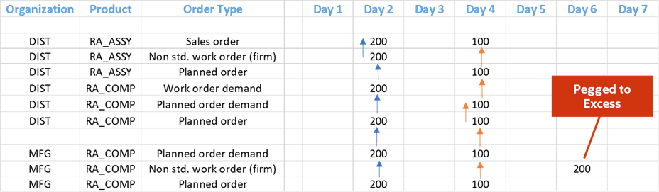

Following is the supply demand picture. In this case, the firm supply for RA_COMP in MFG organization has been moved by the planner from Day 2 to Day 6 to reflect a real delay in the system.
The behavior prior to this update was:
Prior behavior
Prior behavior
Supply Planning has created the planned orders on day 2 and day 4 to satisfy the demand on time. The non-standard work order which was moved out due to real business reasons is pegged to excess as it is firm and later than the demand due dates.

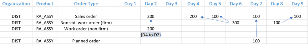

Following is the supply/demand picture of item RA_ASSY in the organization DIST. There are sales order on different days in the planning horizon. There are firm supplies on day 6 and day 8, and there is a non-firm work order on day 4. There are no lead times for this item.
Plan Inputs
Plan Inputs
After this update, following is the result of the supply plan:
The plan option Use All Firm Supplies before Creating Planned Order is set to All supply types and Firm Supply Allocation Window Days is set to 7.
Plan output with new behavior
To satisfy the demand on day 2 on time, the supply plan has rescheduled in the non-firm work order from day 4 to day 2. Supply Planning has satisfied the demands on day 4 and day 5 by using the firm supply on day 6 as it is within the firm supply allocation window. For the demand on day 7, the plan has created the planned order to satisfy the demand on time as it couldn’t use the firm supply on day 8 as it is outside the firm supply allocation window. The firm supply on day 8 is used to satisfy the demand on day 9.
