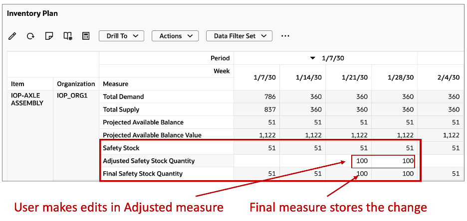

This enhancement enables you to interactively edit, save, and preserve overrides on key inventory planning measures within the inventory optimization plan. You can now modify measure values in specific time buckets, run the plan to evaluate the impact, and retain those edits for future reference, thereby enabling a more iterative and responsive planning experience.
For example, in an Inventory Plan view, you can edit the Adjusted Safety Stock Quantity in specific time buckets to respond to a change in demand, to cover a supply risk, or to override inventory policy-based calculations. After updates, you can save and run the plan to see projected inventory and supply impacts, and you can have those edits preserved across subsequent plan runs.
Illustration of User Adjusted Safety Stock measure

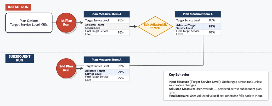

The following illustration depicts the lifecycle of an editable measure across plan runs—showing the initial plan state, how your overridden value is captured in the adjusted measure, and how that edit is preserved and carried forward into subsequent plan runs through the final measure.
Illustration of lifecycle of an editable measure

Each user-adjustable measure is composed of a set of three measures—an input measure, an adjusted measure, and a final measure—that work together to capture the original plan value, the overridden value, and the value ultimately used by the planning engine.
Example of Measure Types
Measure Type Example Behavior
Input Measure Target Service Level This measure displays the original value sourced from plan input data and remains unchanged across plan runs unless the underlying source data is updated.
Editable Measure Adjusted Target Service Level You can enter or overwrite values after a plan run. The entered value is retained and remains visible and editable across subsequent plan runs.
Expression Measure (Final) Final Target Service Level If a value is entered in an adjusted measure, the final measure uses that value; otherwise, it falls back to the original input measure value. The final measure is what the planning engine uses in the next plan run.

Safety Stock Adjusted Safety Stock Quantity Final Safety Stock Quantity This final measure is used by downstream applications (Example: Supply Planning, Sales and Operations Planning) as the final safety stock when this inventory optimization plan is used as a demand schedule.

  • Initial plan run: All adjusted measures are null by default on the first plan run.
  • Subsequent plan runs: Any values entered by the user after the initial plan run are retained and persisted in the plan across subsequent runs when executed with snapshot.
  • The adjusted measures persist in all subsequent plan runs unless you edit them or make them null by deleting the values. You can mass delete these values at a period level or all-plan level to remove your adjustments and revert the plan to the initial state.
