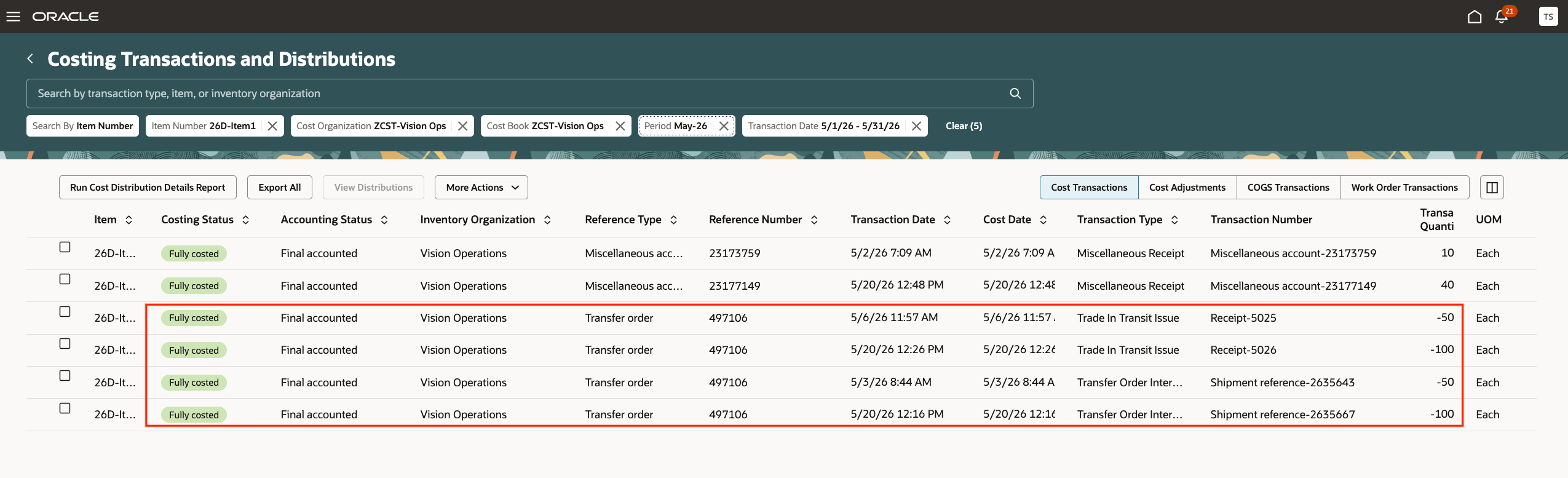

Costing Transactions and Distributions page showing standard-cost item transactions with fully costed status and final accounted status

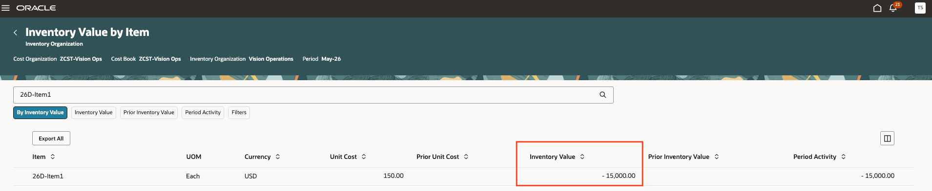

Inventory Value by Item page showing a standard-cost item with negative inventory value and period activity.

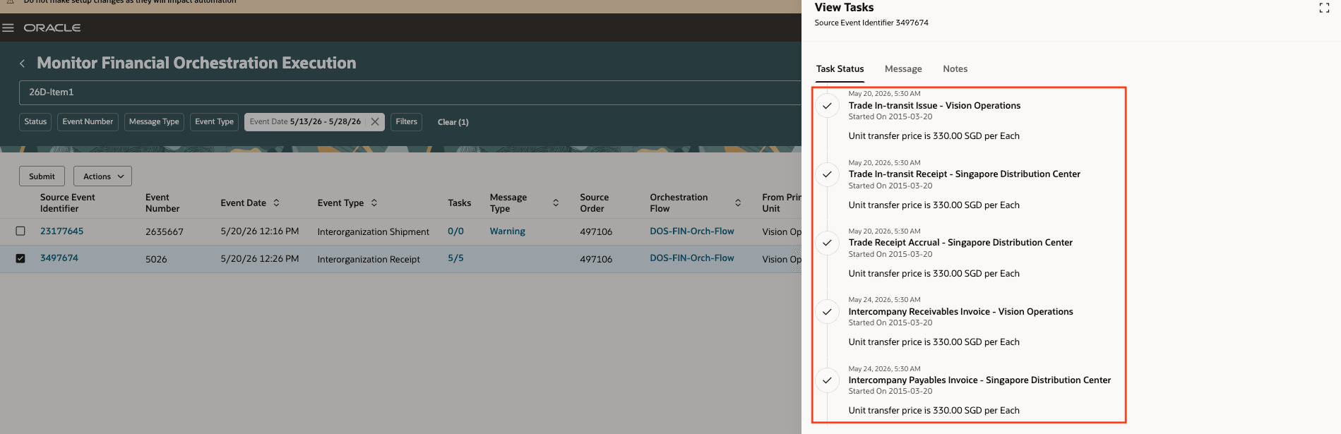

Monitor Financial Orchestration Execution page showing a selected event with completed task status.

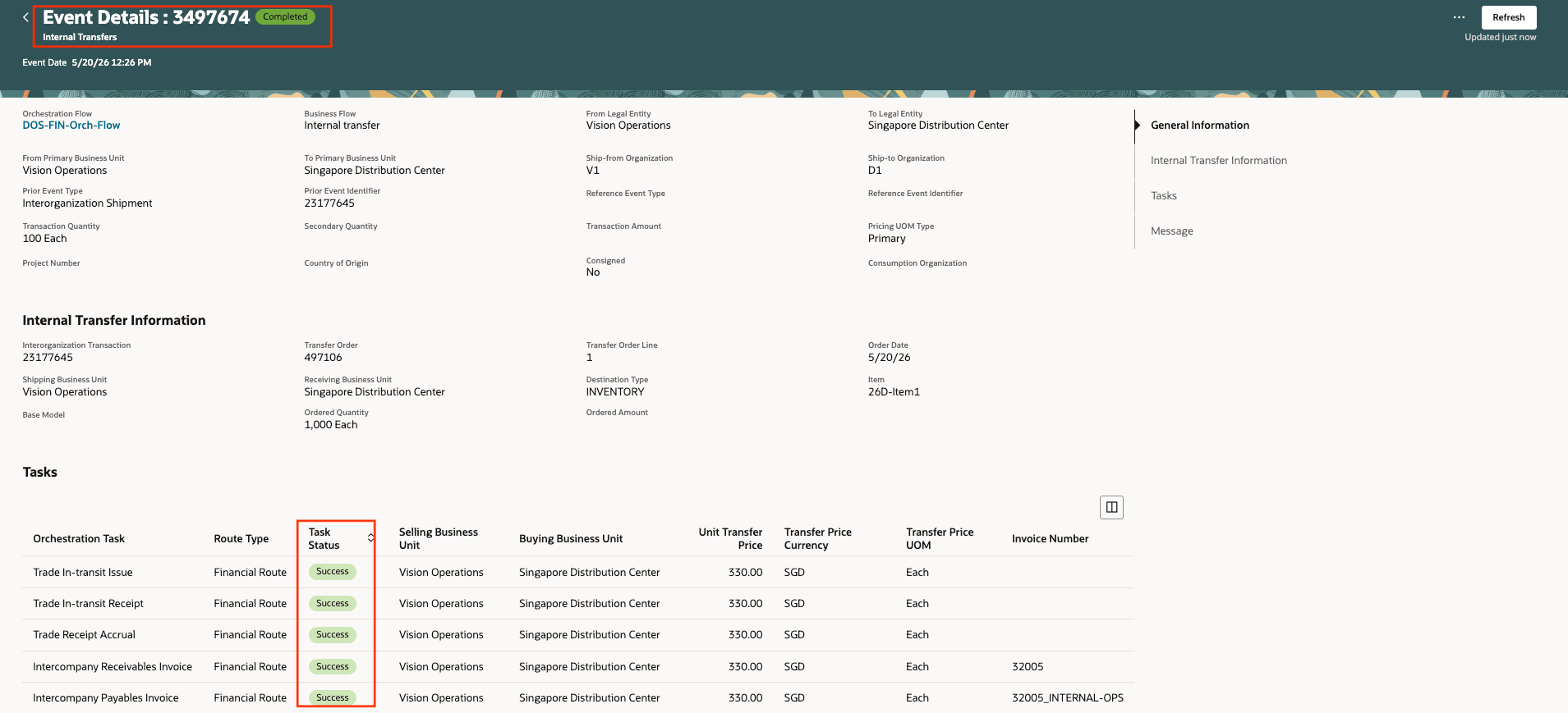

Event Details page showing completed internal transfer tasks for a Financial Orchestration event.
