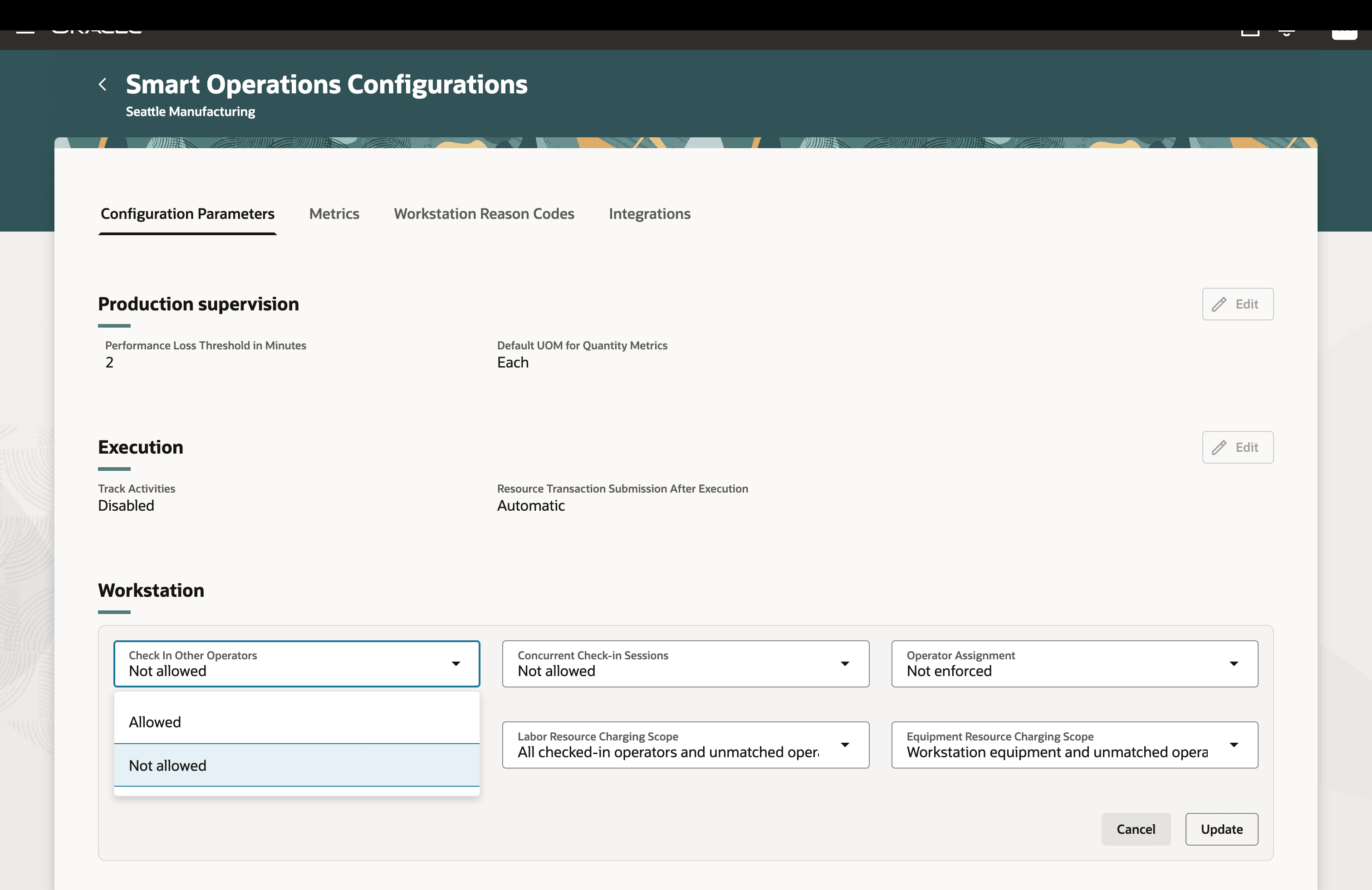

With this feature enhancement, a new Smart Operations configuration, Check-In Other Operators, allows you to control whether operators can manage the participation of other operators. When this parameter is set to Not allowed, operators can manage only their own participation.

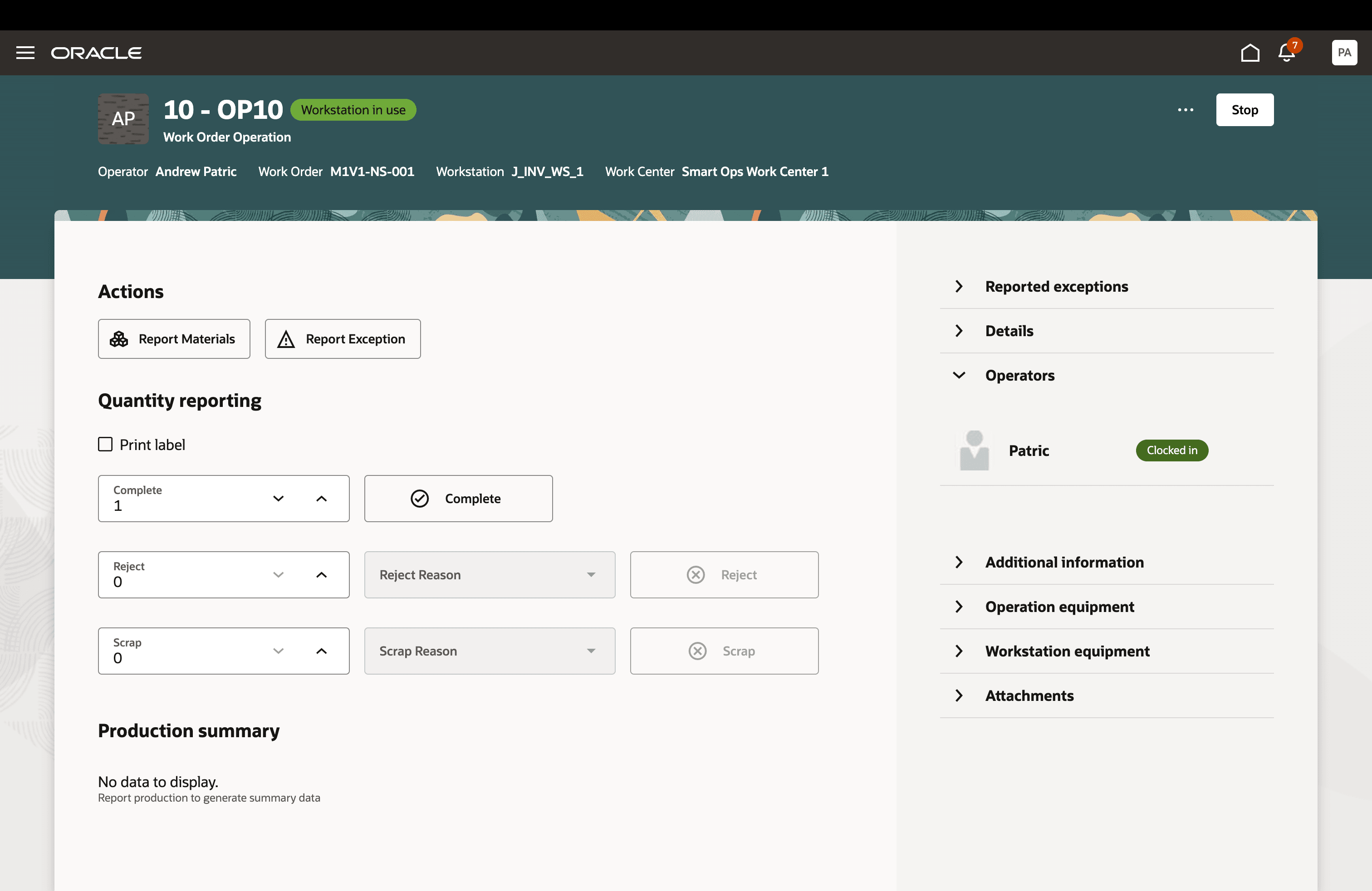

One Operator Working On an Operation
Single operator executing an operation at a workstation, with the option to stop the execution
If an operation is already in progress, operators can't check in without joining the active execution session. They must join the execution individually and can leave the session after completing their work without stopping the execution. The remaining operators can continue the execution uninterrupted.

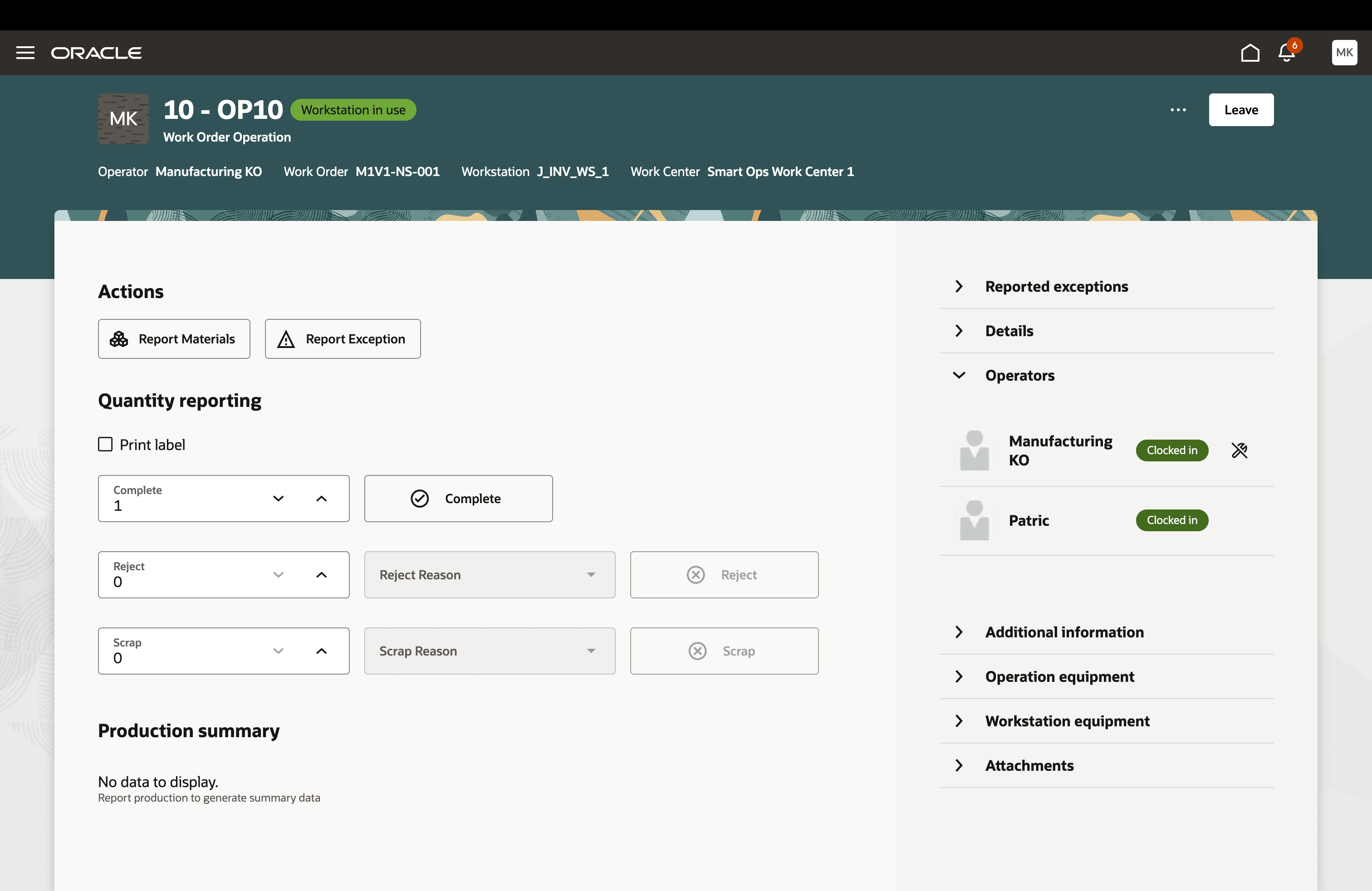

Multiple Operators Working On an Operation
Multiple operators participating in an operation execution at a workstation, with the option to leave the execution without stopping it
Oracle Manufacturing tracks each operator's participation from the time they start or join the operation execution until they leave or stop participating. When the last participating operator stops the execution, the application calculates each operator's execution time based on their individual start or join time and stop or leave time, and charges labor resources accordingly.

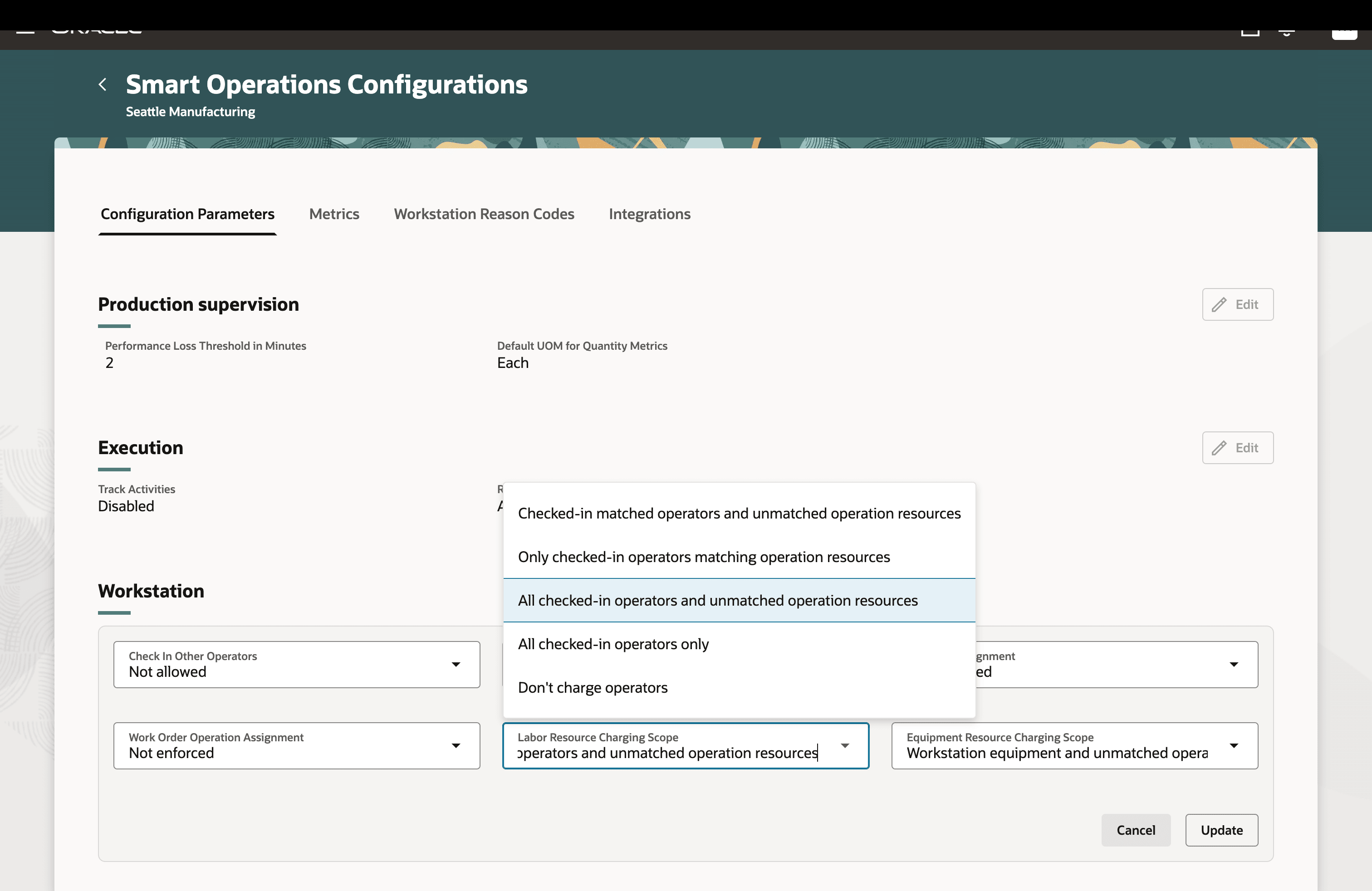

The different options for charging labor resources are as follows:
  • Labor Resource Charging Scope
    • Only checked-in operators matching operation resources: Charge only checked-in operators whose resource type matches a resource defined for the work order operation.
    • Checked-in matched operators and unmatched operation resources: Charge matching checked-in operators and also charge operation resources that do not have a matching checked-in operator.
    • All checked-in operators and unmatched operation resources: Charge every checked-in operator, including those whose resource type is not defined for the operation, and charge unmatched operation resources. This is the default option.
    • All checked-in operators only: Charge every checked-in operator regardless of a matching operation resource, but do not charge operation resources without a matching checked-in operator.
    • Don’t charge operators: Do not create labor resource charges for operators.
Labor resource charging scope

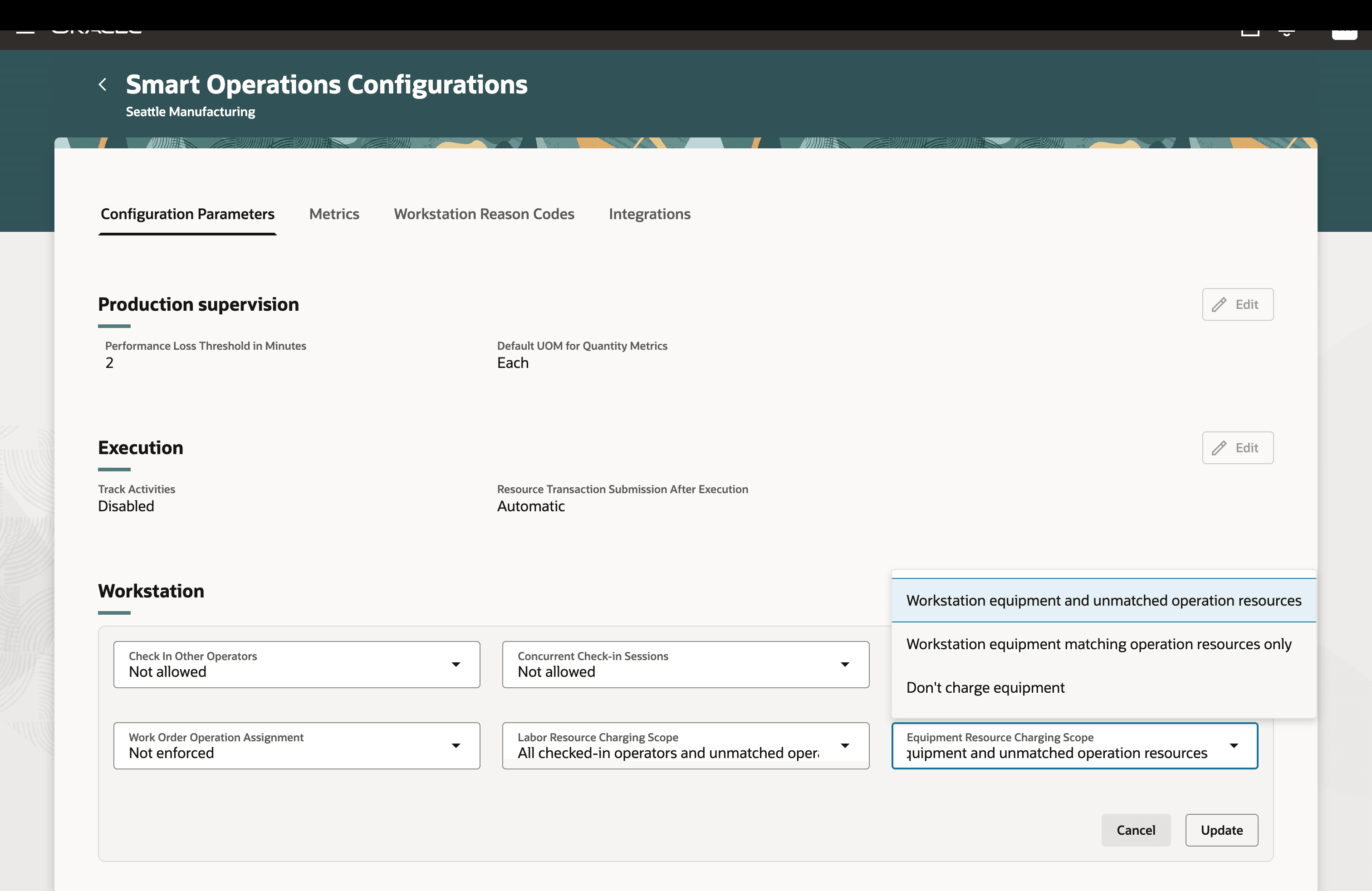

  • Equipment Resource Charging Scope:
    • Workstation equipment matching operation resources only: Charge only workstation equipment whose resource type matches an equipment resource defined for the operation.
    • Workstation equipment and unmatched operation resources: Charge matching workstation equipment and also charge operation equipment resources without a matching workstation equipment. This is the default option.
    • Don’t charge equipment: Do not create equipment resource charges for the operation.
Equipment resource charging scope

A new Smart Operations configuration, Check-In Other Operators, controls whether operators can manage the participation of other operators. By default, this setting is Allowed.
When Check-In Other Operators is set to Allowed, operators can check in and check out other operators and can stop the execution for all participating operators in the session.
When Check-In Other Operators is set to Not Allowed, operators can manage only their own participation. They can't check in or check out other operators and can stop only their own participation without affecting the work execution for other operators.
Check In Other Operators
Check In Other Operators Smart Operations Configuration
