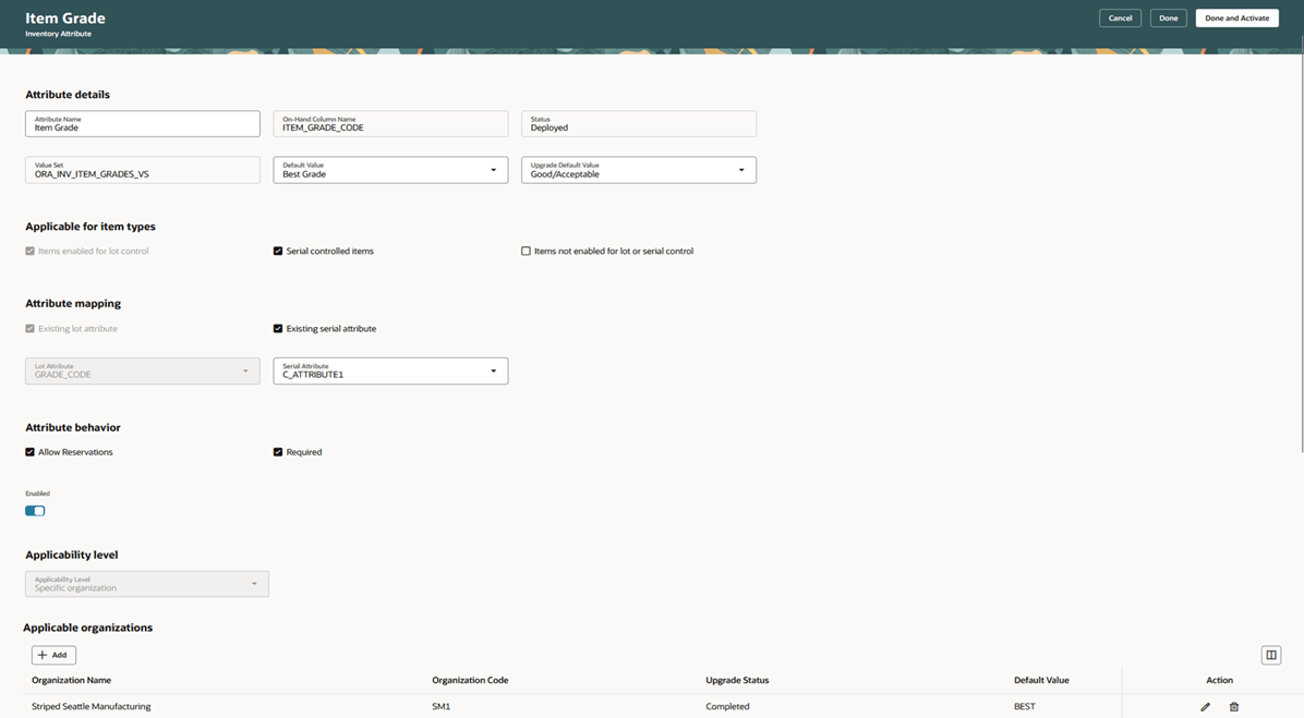

Configure grade and expiration date attribution on the Configure Inventory Attributes page in Inventory for the lot controlled or serial controlled items that you use in work orders. Refer to the 26D feature Use Grade and Expiration Date as On hand Attributes in Inventory Management for complete details. You can modify the following details on the Configure Inventory Attributes page:
  • Attribute Name: The name of the inventory attribute. For example, Item Grade is seeded by default and can be renamed when the inventory attribute is deployed.
  • Onhand Column Name: The onhand column to which the inventory attribute is mapped. Item Grade is mapped to the ITEM_GRADE_CODE attribute.
  • Status: Determines the lifecycle status of the inventory attribute.
  • Value Set: Indicates the value set associated with the inventory attribute.
  • Default Value: Indicates the value that defaults during transactions when the inventory attribute is not specified.
  • Upgrade Default Status: Indicates the value used to associate existing onhand quantities for items enabled for the inventory attribute but not enabled for lot or serial control.
  • Applicable for Item Types: Determines whether an inventory attribute can be enabled for lot controlled items, serial-controlled items, or items that are not enabled for lot or serial control.Configure Inventory Attributes

Attribute Mapping
Attribute mapping determines whether an inventory attribute is already used as an existing lot or serial attribute.
  • Lot Attribute: Item Grade is mapped to the grade_code ininv_lot_numbers. Item Expiration Date is mapped to expiration date in inv_lot_numbers.
  • Serial Attribute: Indicates that the inventory attribute is mapped to an existing serial-number attribute.
Reservation and Required Attributes
By default, both Item Grade and Item Expiration Date are enabled for reservations and required for transactions.
Enabled: Turn on the Enabled Flag to enable the the inventory attribute.
Applicability Level
Applicability level determines the level at which the inventory attribute applies to transactions. The applicability can be set at these levels:
  • All Organizations: The inventory attribute applies to all items in all inventory organizations.
  • Specific Organization: The inventory attribute applies to specific items.
  • Category: The inventory attribute applies to the items associated with a specific category.
Choose  Default value for an inventory attribute for each applicable organization. This defaults the inventory attribute when you perform transactions for items which are enabled for serial control or items which aren't enabled for lot or serial control.
Click the Done and Activate button after you have updated the attribute details. This launches the  Deploy Inventory Striping Attributes scheduled process.
