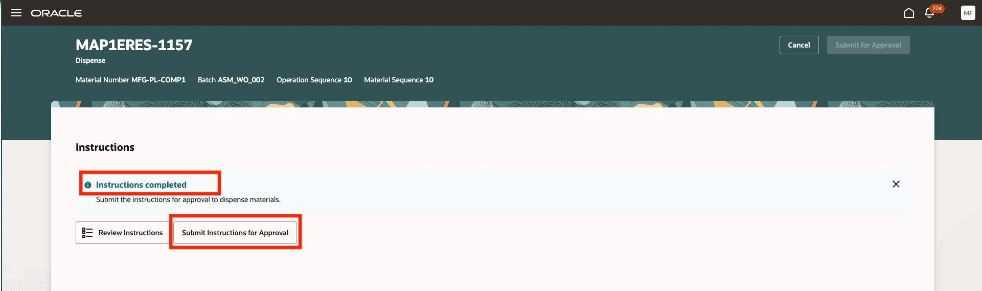

Submit the instructions completion for approval before you can start dispensing of materials.
Submit the instructions for approval before you can start dispensing of materials

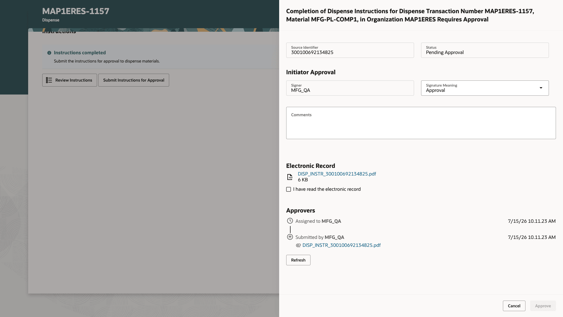

When you select Submit instructions for Approval, an inline approval task is invoked and the approver can review the details of the instructions completed before they record their approval.
Dispense instructions completion approval

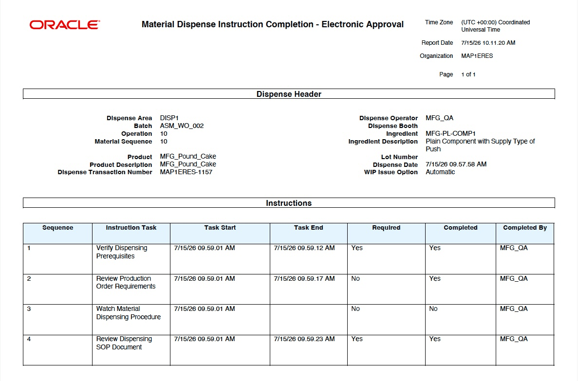

The e-record contains the details of the tasks completed, the time taken, and the details of the person who completed the instruction tasks.
E-record with details of the instruction completion.

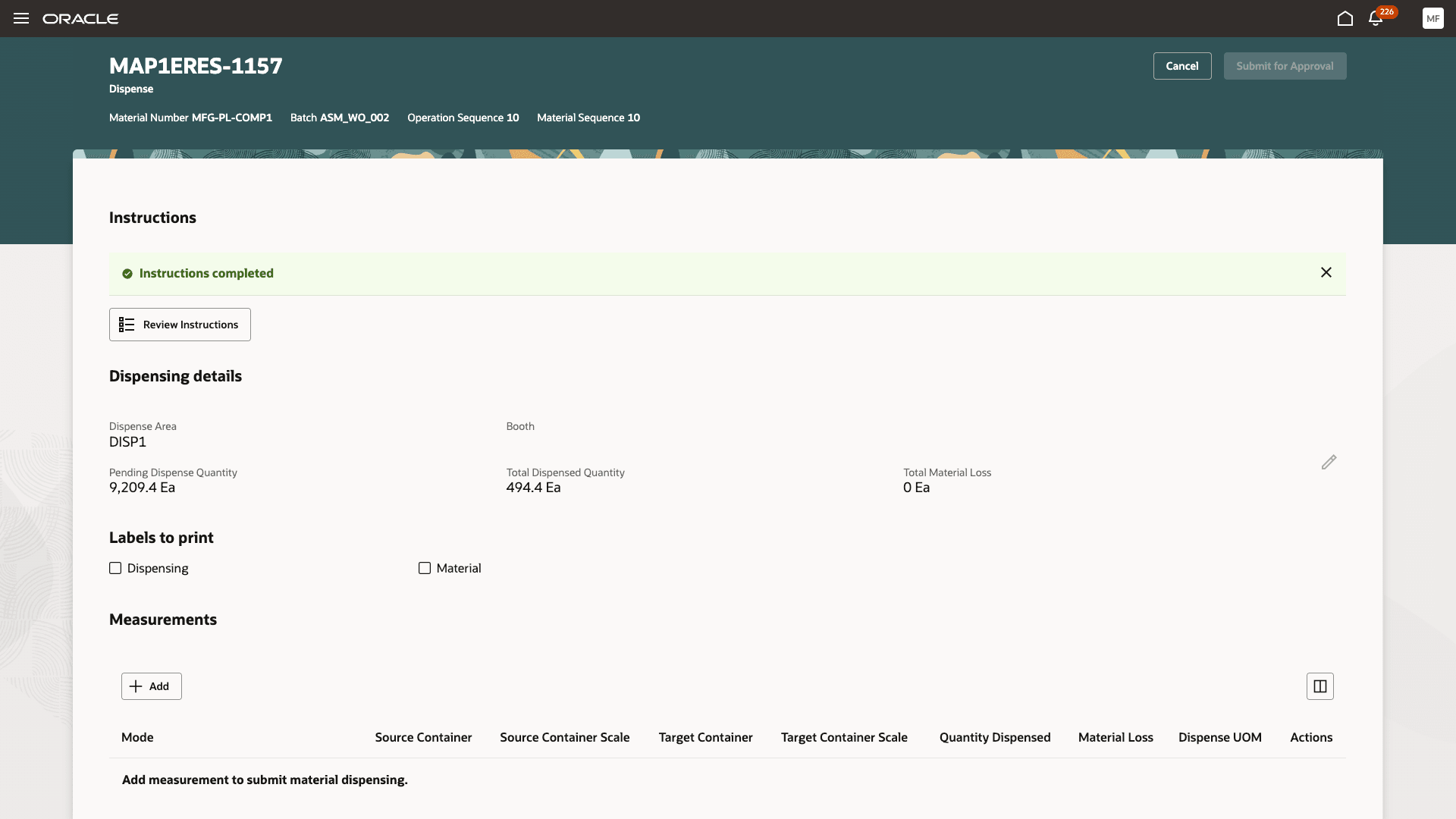

Once the ERES transaction is approved, the operator can go ahead with dispensing activity.
Instructions are marked as complete after ERES approvals are recorded.

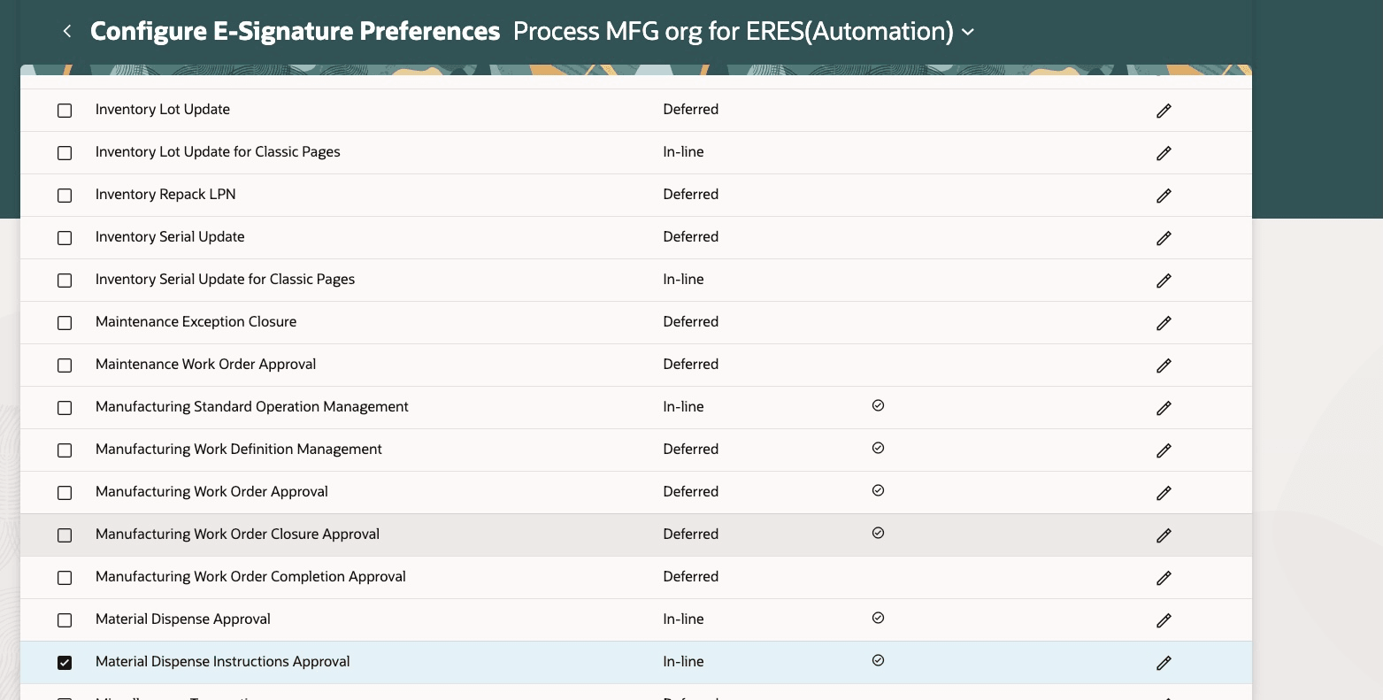

  1. In the Setup and Maintenance work area, search for and select the Configure Electronic Signature Preferences task.
  2. On the Configure E-Signature Organizations page, select the inventory organization/plant where you would be dispensing materials.
  3. Enable the Material Dispense Instructions Approval transaction.
    Enable dispense instructions approval.
