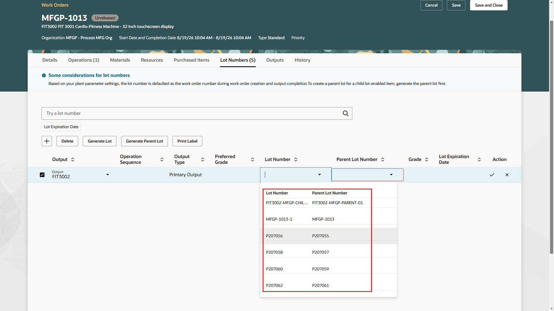

Define parent lots and lots for preassigned work order products

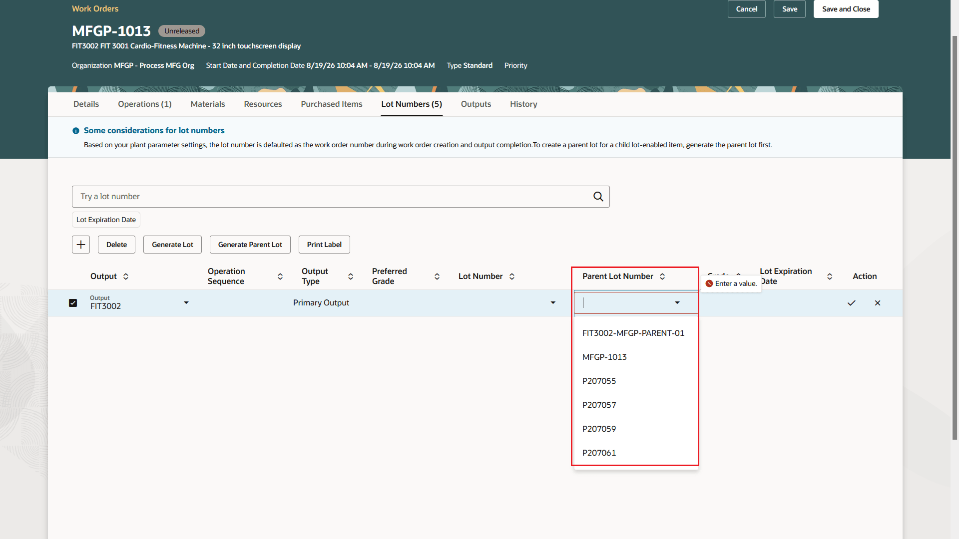

For products with preassigned lots, you can define the parent lot and lot from the Lot Numbers tab on the Work Orders page. Depending on the item and lot setup, you can generate or enter a parent lot and create the associated lots, or select an existing parent lot or lot. When you select an existing lot, the system automatically displays its associated parent lot. You can search by either the parent lot number or the lot number and select the required lot. You can also search for an existing parent lot and then generate or manually enter a new lot number to associate with it.

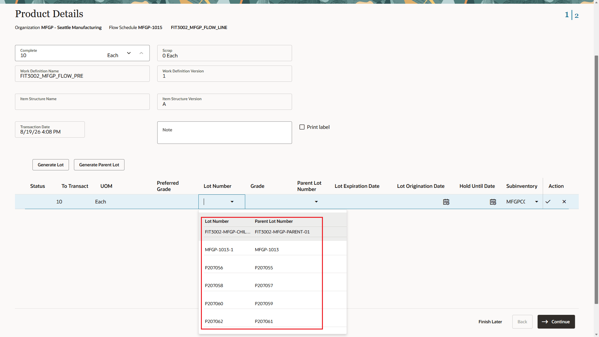

Search the lot or parent lot number and view the parent lot information while selecting the lot in a discrete work order
Search and select an existing parent lot in the discrete work order

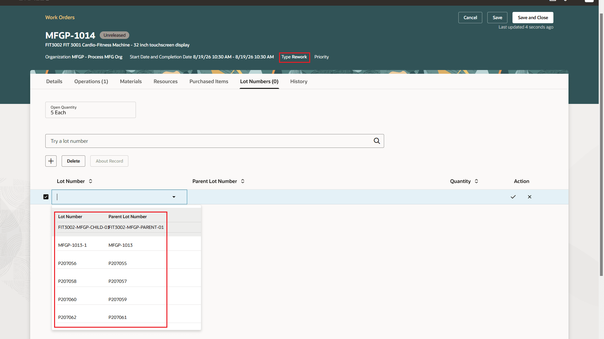

Search by the lot or parent lot number and view the parent lot information while selecting a lot in the Rework work order

Capture parent lots during product completion
You can use the enhanced parent lot behavior when reporting completion for a work order product from Production Execution, Postproduction Reporting, and the Report Output Mobile page.

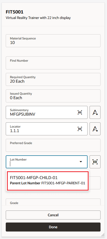

  • For products with preassigned lots, select an existing lot. The system automatically displays the associated parent lot as a read-only value.
  • For products without preassigned lots, you can create a new lot and provide the applicable parent lot, or select an existing lot that already has a parent lot association.
    • When you select an existing lot, the system automatically displays its associated parent lot number. You can search for an existing lot using its lot number or the parent lot number.
    • You can also search for an existing parent lot and then generate or manually enter a new lot number to associate with it.
  • If a parent lot is required and isn't provided, the system prevents you from saving the lot information.

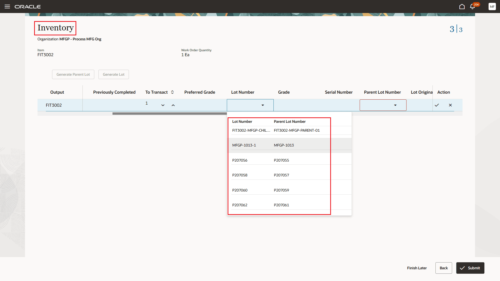

Search by the lot or parent lot number and view the parent lot information while selecting a lot in the Inventory Product Completion page
Search by either the lot or the parent lot number and view the parent lot information while selecting a lot in the Issue Material Transactions Mobile UI

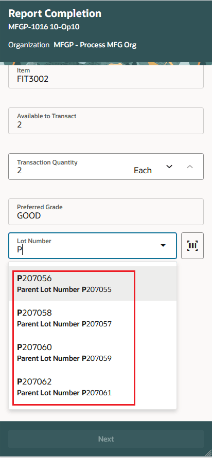

Search and select the lot or the parent lot number and view the parent lot information while selecting a lot in the Report Completion Mobile UI

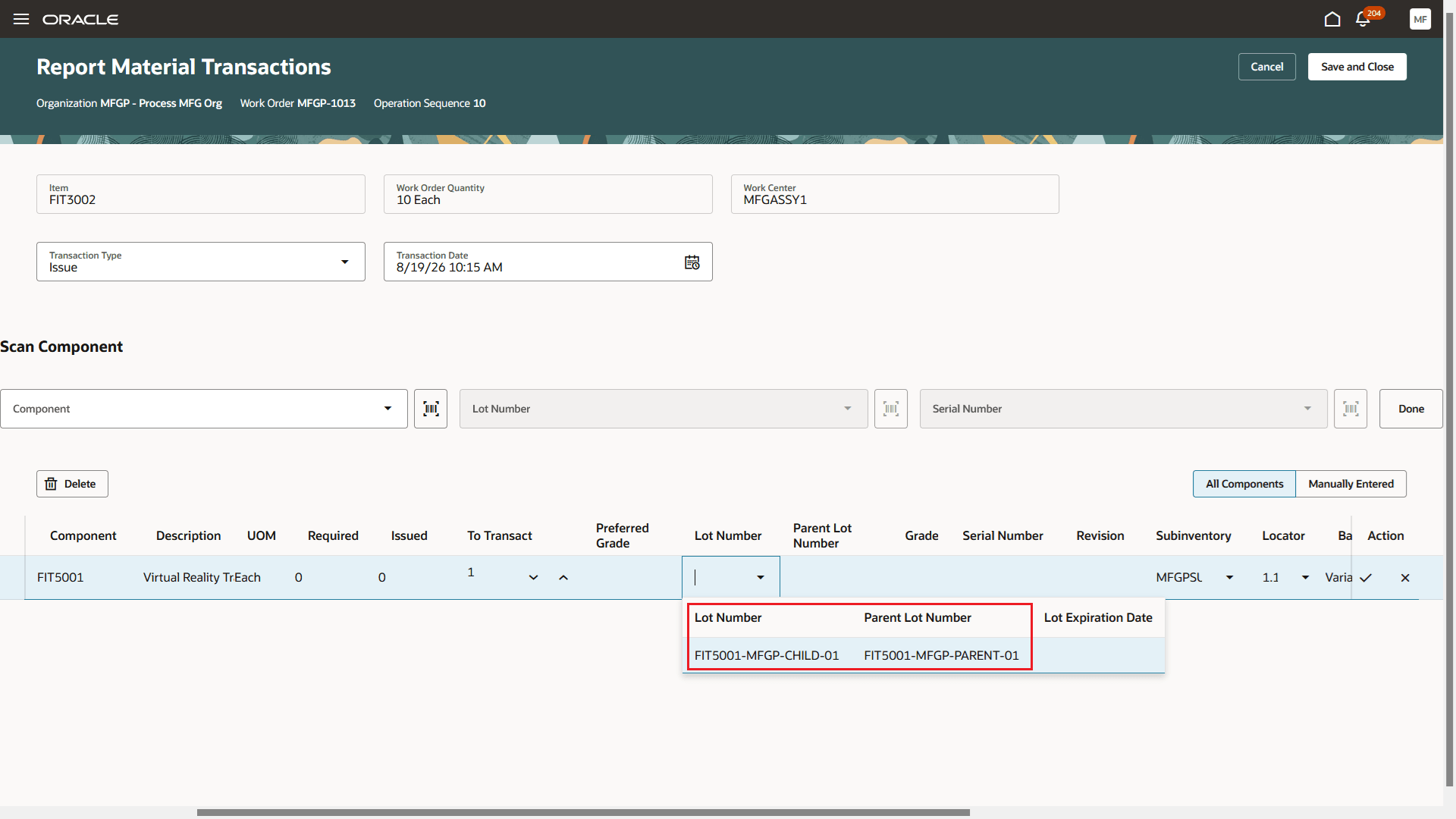

Parent lots during material issue transactions
The existing parent lot capability is extended to material issue transactions from Production Execution, Postproduction Reporting, Report Material Transactions, and mobile pages.
When you select or scan an existing lot for a material, the system automatically derives and displays its parent lot. A new column is also added to display the parent lot number as a read-only value. You can also search using a parent lot number to view all eligible transactable lots associated with it and select the material lot to issue to the work order.
Search by either the lot or the parent lot number and view the parent lot information while selecting a lot in the Production Execution (Report Material Transactions) UI

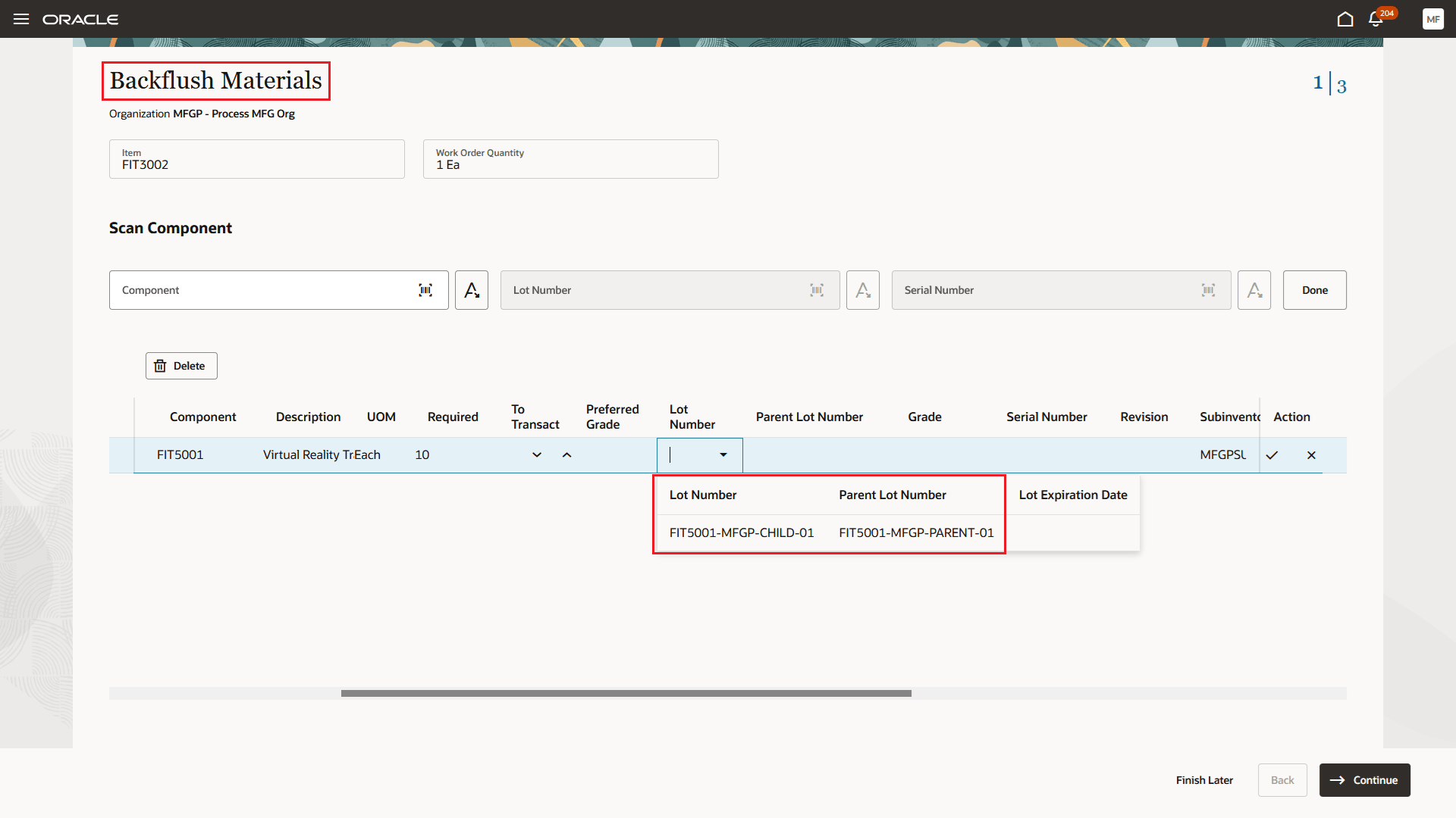

Search by the lot or the parent lot number and view the parent lot information while selecting a lot in the Backflush Materials page

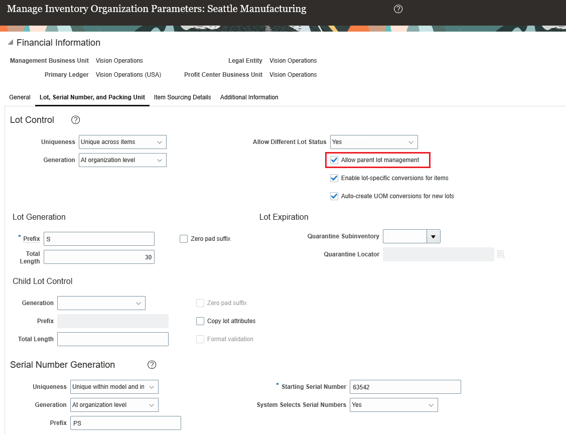

Enable parent lot management for the inventory organization:
1.    In the Setup and Maintenance work area, search for, and select the Manage Inventory Organizations task.
2.    Select your organization and select Manage Organization Parameters.
3.    Ensure that the flag Allow Parent Lot Management is enabled.
Allow parent lot management inventory organization parameter

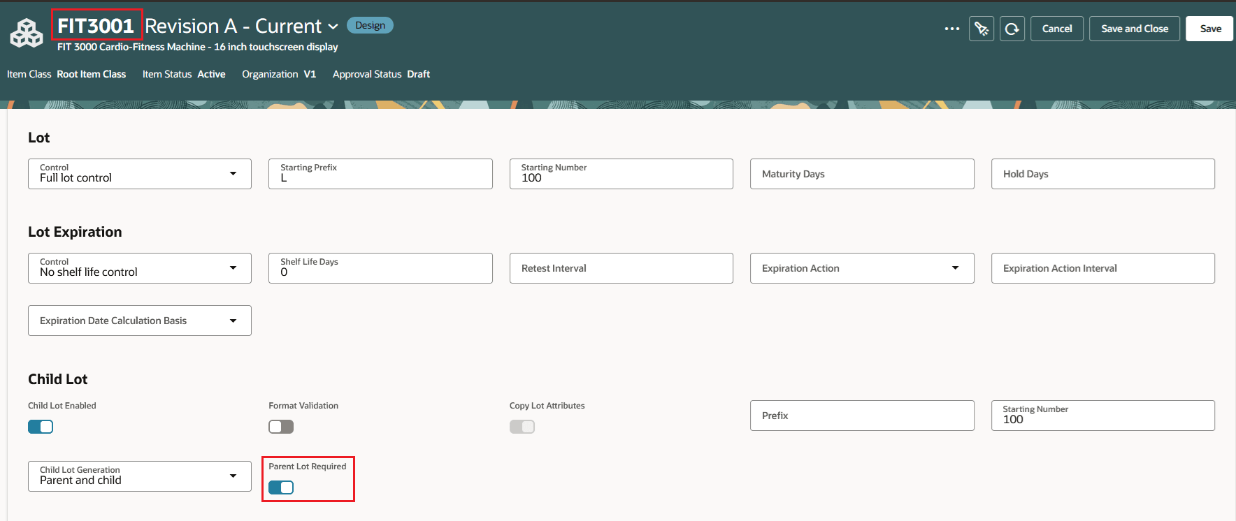

Enable the Parent Lot Required attribute for the item:
1.    After configuring the inventory organization, navigate to the Product Information Management work area and enable the Parent Lot Required item attribute for applicable items configured for child lot control.

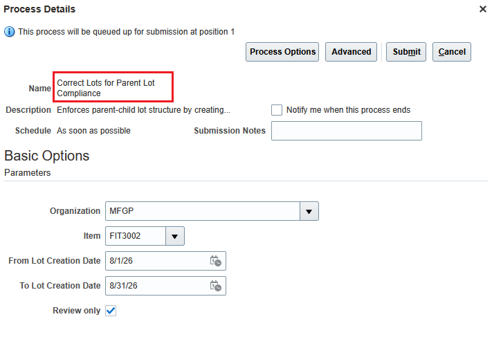

2.    For existing items and lots, ensure that the item has no on-hand inventory, and then run the Correct Lots for Parent Lot Compliance scheduled process before using those lots in parent lot required batch transactions. The Correct Lots for Parent Lot Compliance scheduled process creates missing parent lot records, makes applicable parent lots non-transactable, validates existing relationships, and makes corrected lots eligible for selection. You can also correct existing relationships manually from the Manage Lots page.
