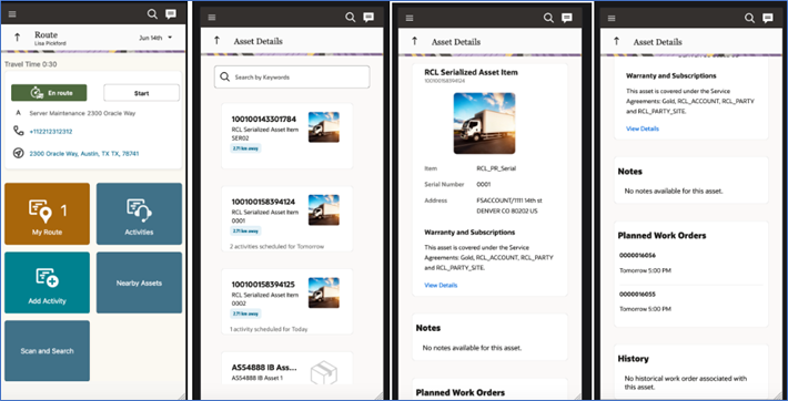

Find Nearby Asset and Access Asset Information
Mobile workers can find an asset near their current location and view more information by using the Asset Details plugin.
Once the Nearby Assets button is enabled on My Route page, mobile workers can:
  • Select the button to view a list of nearby assets.
  • Choose an asset from the list to see its details.
Find NearBy Asset
Find NearBy Asset
Notes:
  • Nearby Asset functionality supports both installed base assets and maintenance assets.
  • For maintenance assets, the Nearby search returns data only for assets in the work center to which the mobile worker is mapped.
  • A maximum of 50 assets can be shown in the search results.

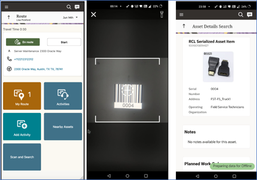

Scan an Asset and Access Asset Information
Mobile workers can search an Asset using the Barcode Scanning functionality. If an asset has a barcode and is associated with a barcode field, you can scan the asset and view more information using the Asset Details plugin. Once the Scan and Search Asset Button is enabled on My Route page, mobile workers can:
  • Select the button and scan the asset barcode to search for the asset.
  • View the asset information.
Scam and Search
Scan and Search
Notes:

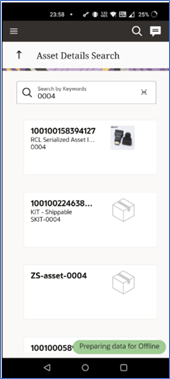

  • If the barcode scan fails, you can search for assets using other configured parameters such as serial number or asset number.
  • Barcode scanning works only if the barcode is mapped to the asset number or serial number.
Barcode scan
Barcode scan

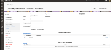

To enable this feature for specific users:
  1. Go to the Configuration page in Oracle Fusion Field Service and select the appropriate User Types.
  2. In the Activity List option under the Screens tab, add the buttons for the Asset Details plugin on the technician's Route page. This will allow the mobile worker to open the plugin from the Route page and view the asset.
 Screen
Screen
Activity List
Activity List

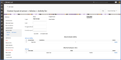

As part of the Asset Details plugin, a new parameter, NearBy, is introduced that allows the plugin to work as Scan and Search or Nearby Asset. This feature enables mobile workers to search for assets effortlessly. By default, it operates in Scan and Search mode from the My Route page of mobile worker. For Nearby Asset functionality, you need to enable the NearBy parameter. The plugin can be used in both, Scan and Search mode, as well as the Nearby Assets mode, and these are differentiated based on the open parameter set in the configuration.
Note: Ensure you have enabled the Scan and Search and Nearby Asset buttons in the Activity Lists context in the Screens page. This feature will not work if you are enabling Scan and Search and Nearby Assets buttons in any other contexts.
Additional Parameters
nearbyRadius and nearbyRadiusUnit parameters: Customize the search radius and units. These parameters offer the flexibility to override the search radius and units in the nearby functionality. While not mandatory, they enable customization of the search area. By default, assets within a 5-mile radius are displayed for Installed base assets. For maintenance assets, it shows assets linked to the mobile worker’s work center.
