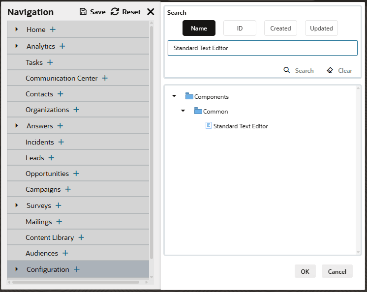

  1. Open the BUI Navigation Set by clicking on the three horizontal line icon in the upper left corner of the browser UI.
  2. On the Navigation Set, click on the gear icon in the upper right corner
  3. Click on the '+' sign to select which category in the Navigation Set you'd like to add the Standard Text Editor to.
  4. Search and select the Standard Text Editor in the search dialog.
  5. Click Save and the editor is now in the Navigation Set.

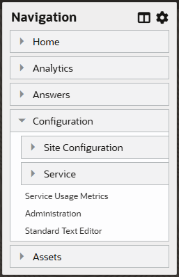

Adding Standard Text Editor to Navigation Set      Standared Text Editor in the Navigation Set
Adding Standard Text Editor to Navigation Set and the Standard Text Editor in the Navigation Set
