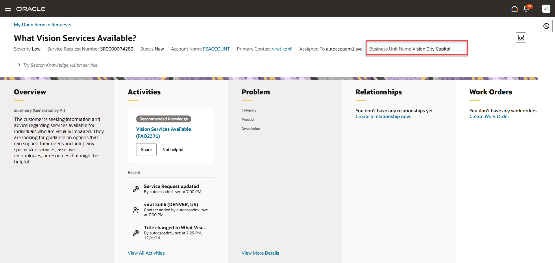

For example, here is the Service Request displaying the value of the Business Unit
Business Unit Stamped on Redwood Service Request Record

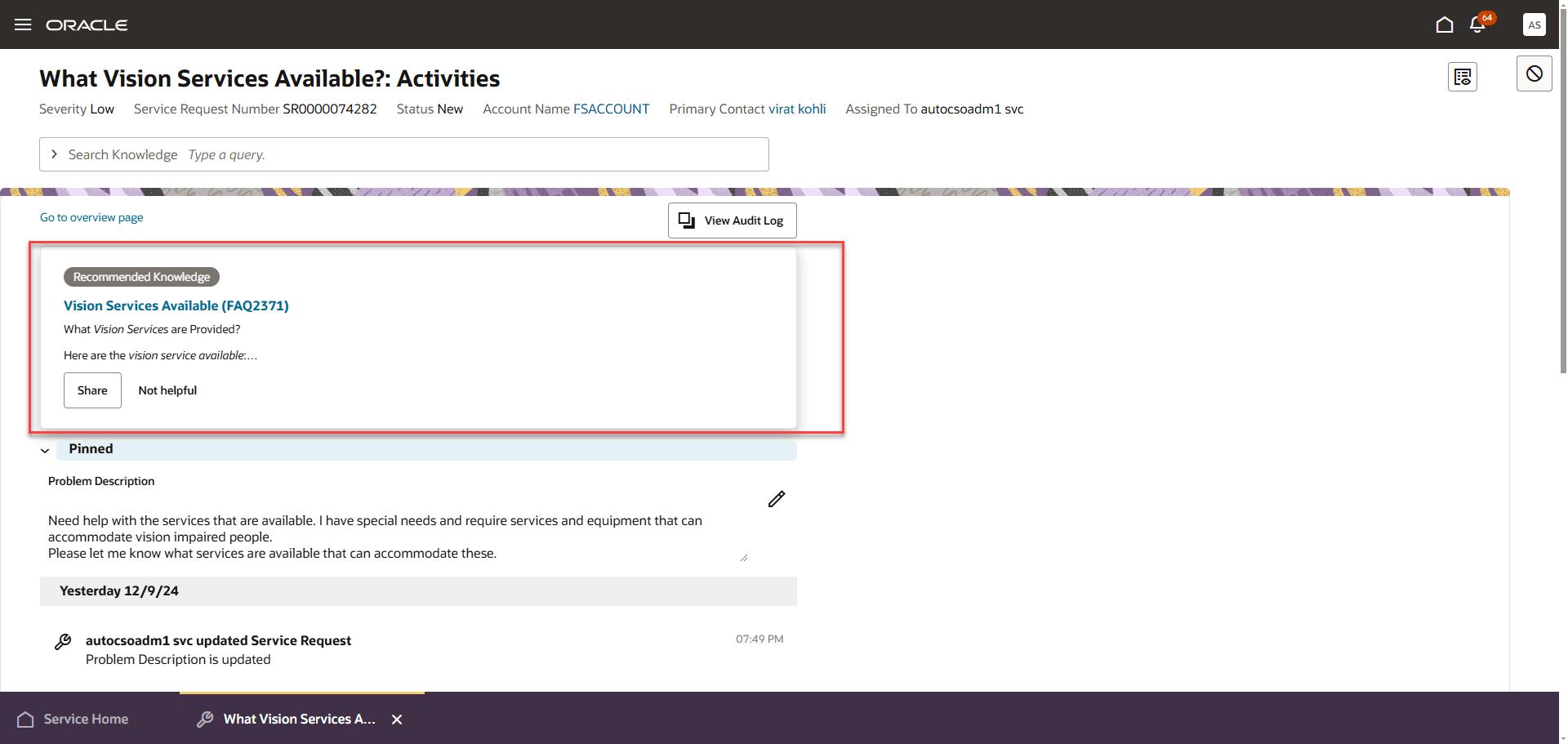

Lastly, here is the recommended knowledge article
Recommended Article

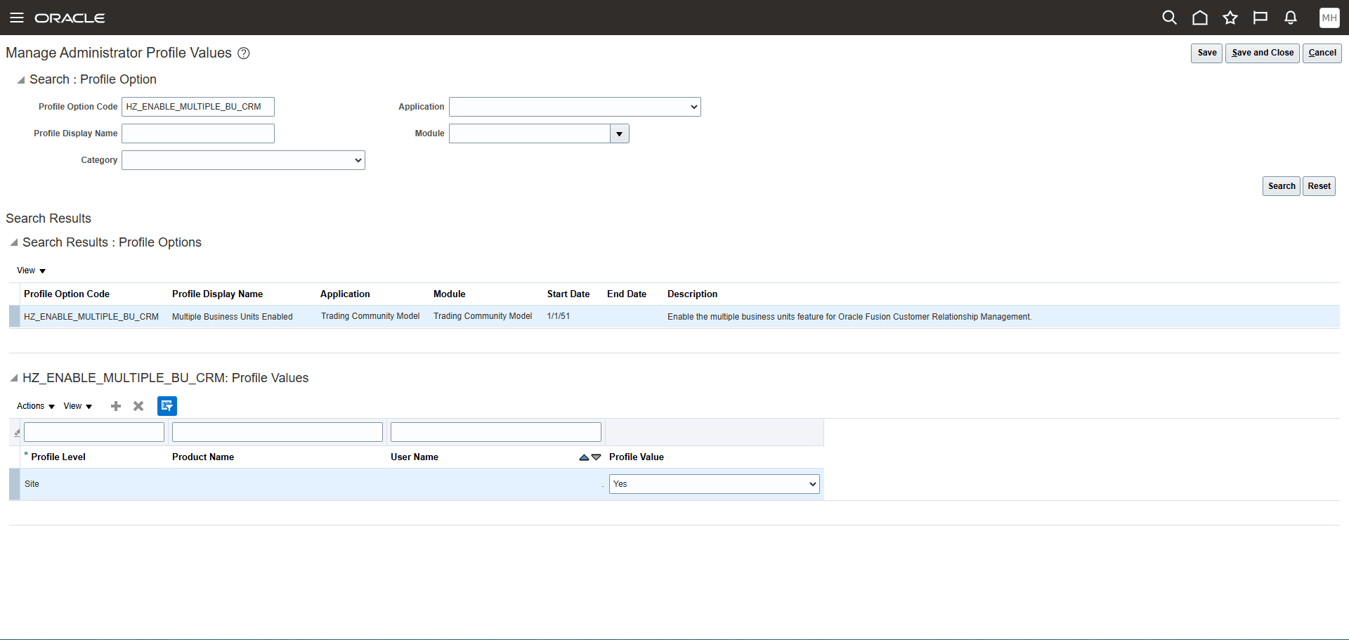

When testing Knowledge using Business Units, make sure HZ_ENABLE_MULTIPLE_BU_CRM profile option is set to Yes. This profile option can be found under the Setup and Maintenance > Service > and search for the Manage Administrator Profile Values Task as shown below:
Manage Administrator Profile Options

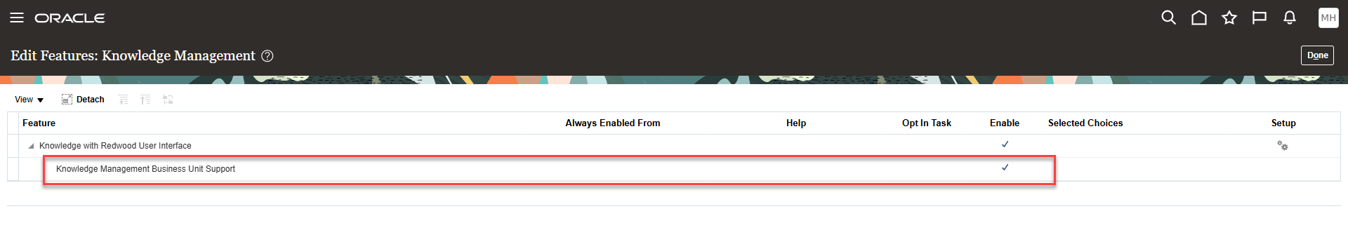

Also, under Knowledge Management feature, make sure the Knowledge Management Business Unit Support is Enabled. This feature option can be found under the Setup and Maintenance > Service offering > Knowledge Management > and click on the pencil icon under Features.
KM Business Unit Support Enabled
