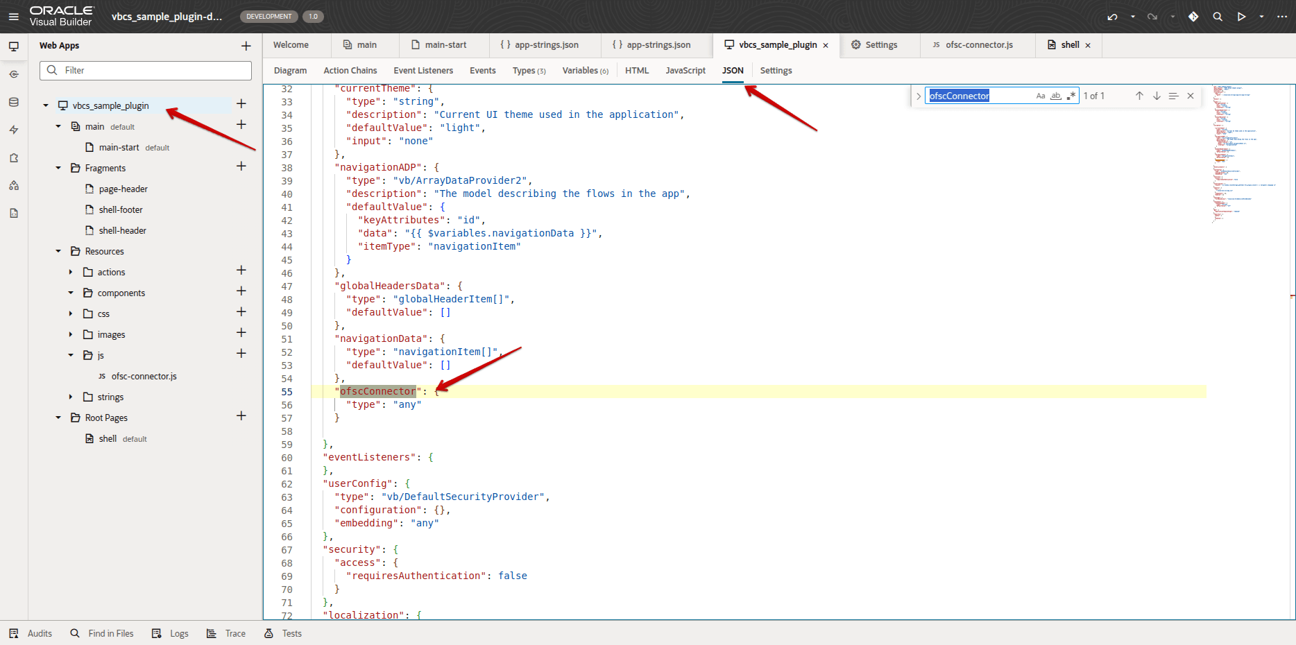

- Include the new file ofsc-connector.js into the plugin. This screenshot shows the ofsc-connector.js file included in the plugin:

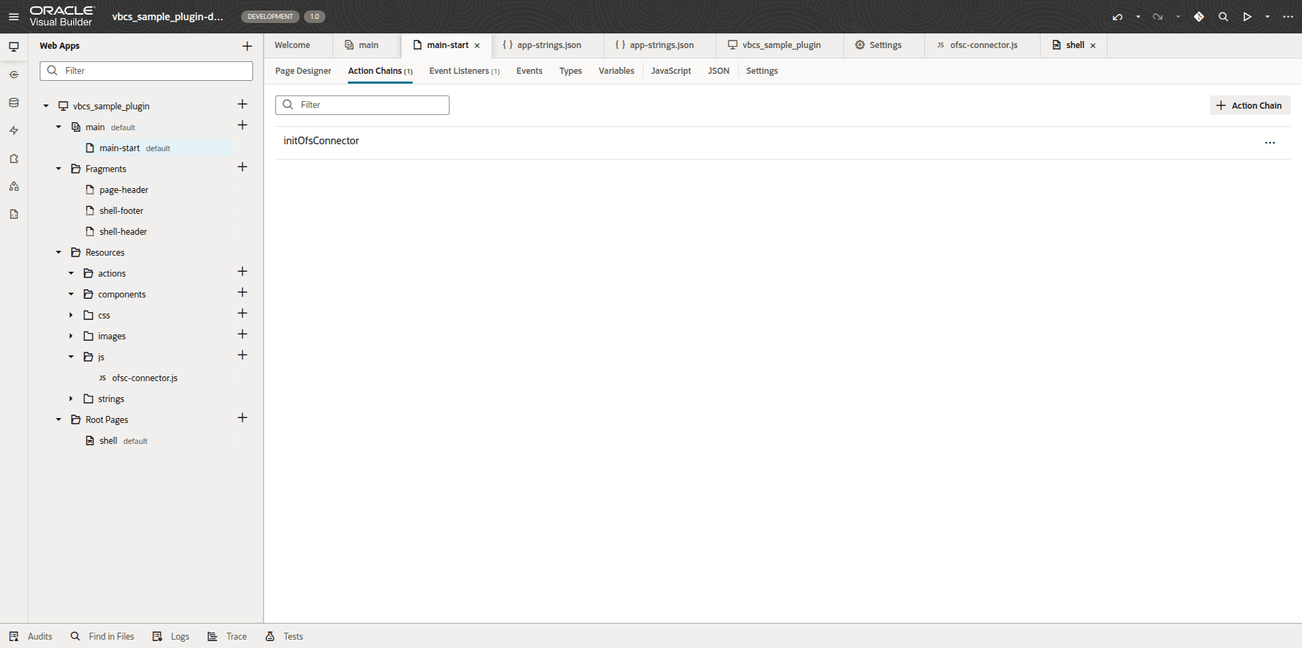

- Create a new Action Chain with the name initOFSConnector.
- Add the following chain using the UI or Code tab:
Add this code:

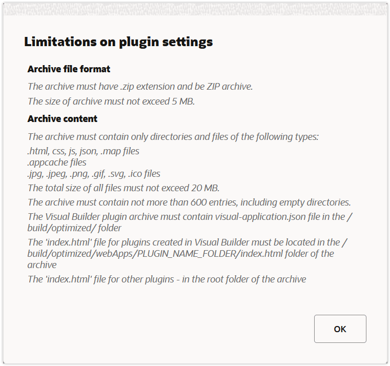

Review the Requirements for the Plugin Archive
This section includes the requirements to create the plugin archive, such as the file format and supported file types.
Archive file format
The archive must have .zip extension and be a ZIP archive. The size of the archive must not exceed 5 MB.
Archive content
- The archive must contain only directories and these file types:
- .html files
- .css files
- .js, .json, .map files
- .appache files
- .jpg, .jpeg, .png, .gif, .svg, .ico files
- Directories
- The total size of all files must not exceed 20 MB.
- The index.html file must be located
- in the /build/optimized/webApps/<plugin_name_folder>/index.html for an optimized Visual Builder plugin
- in the / (root folder) of the archive for a hosted plugin
- The archive must contain not more than 600 entries, including empty directories.
This screenshot shows the requirements for the plugin archive:
