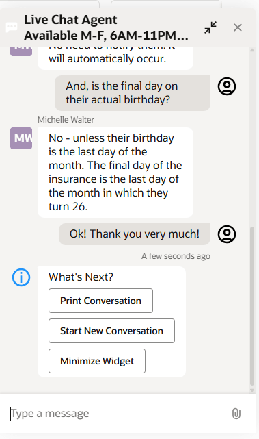

Chat users are now given the opportunity to print the transcript at the end of the chat so they can keep it for future reference. Printing/Saving to PDF can be used to keep an electronic copy. The option is shown when the chat is ended either by the agent or the employee.
Chat Print Button
Chat Print Button

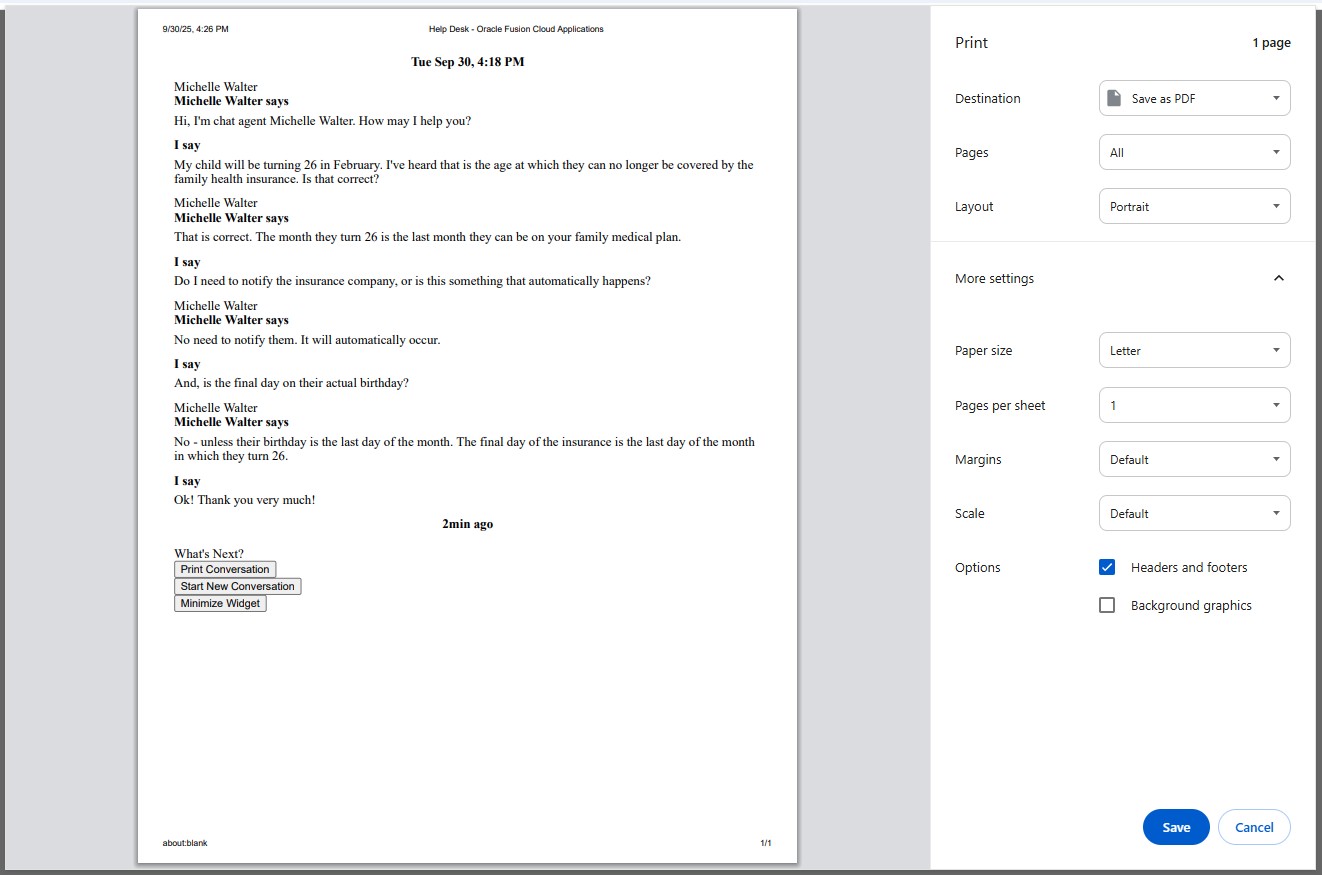

When the button is clicked, a preview of the chat is shown along with Print options that allow the chat to be retained by the employee.
Chat Print Preview
Chat Print Preview
Agents have access to the transcript through interactions, but this allows the chat user to keep the transcript as well, in a way that does not require access to the Help Desk.
