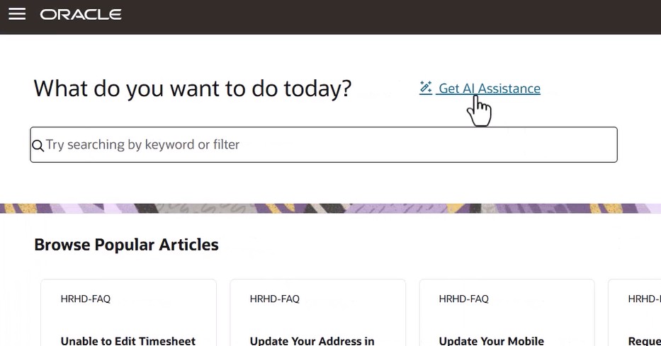

Use Help Desk Get AI Assistance for Employees
The My Help employee user interface now includes an option to Get AI Assistance that gives employees the opportunity to have a conversational question and answer session with an AI Agent.
=AI Assitance
AI Assistance

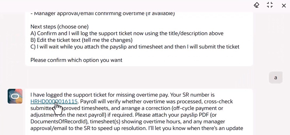

At the end, if their question has not been answered, it can also open a help desk request on their behalf, with the information that has been provided thus far. The Gen AI Assistance is based on the registered specialized AI Agents, and it will also search knowledge for answers.
Create Request from AI Agent
This allows employees to get immediate help even if live chat agents aren't available, and provides an easy way to open a help desk request without having to submit duplicate information.
