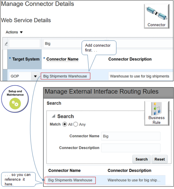

  1. On the flowchart, click Then > Do > New Action > Perform an Action.
  2. In the Create Action dialog, choose Set Connector Name, then click Search.
  3. In the Search dialog, set the value, then click Search > OK > OK.
    Attribute
    Value
    Connector Name
    Big Shipments Warehouse
    Note that the Manage Connector Details page defines the connectors that the Search dialog displays on the Manage External Interface Routing Rules page.
