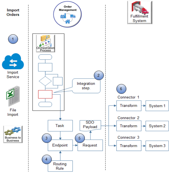

Examine Your Flow
Most Order Management implementations use a set up that's similar to this flow.
Note
Use the import web service, file-based data import, or B2B messaging (business-to-business) to import source orders from your source system into Order Management.
A step in your orchestration process starts the integration. Order management assigns each source order to an orchestration process. The orchestration process orchestrates fulfillment for each fulfillment line. You add an integration step that integrates the orchestration process with your fulfillment system.
Web service endpoints identify each of your fulfillment systems that reside outside of Oracle Applications.
Routing rules specify the conditions to use when determining how to route each fulfillment line to each connector.
Order Management creates a service data object (SDO) and sends a request that includes the SDO payload. The SDO contains details about the endpoint, connector to use, fulfillment lines, and so on.
A connector web service transforms the SDO payload into a message payload that your fulfillment system can understand, and then calls the fulfillment system. You can create a separate connector for each of your fulfillment systems.

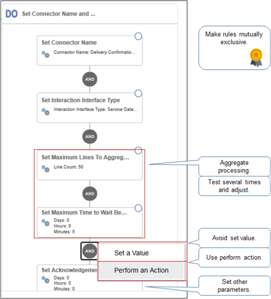

Use Business Rules
Note
To avoid logic problems, make sure rules are mutually exclusive. Make sure no two rules can be true at the same time, or false at the same time. For details, see Overview of Using Business Rules With Order Management.
Consider other attributes you can set.
To aggregate fulfillment lines before you send them to your fulfillment system, use the Maximum Lines to Aggregate and Send attribute and the Maximum Time to Wait Before Sending attribute. Run several tests and adjust these values after each test until you achieve the optimal balance between waiting and performance.
Use other attributes to control processing, as necessary, such as Resolve Cross-Reference for Customer to determine whether to use a cross-reference, or Set Acknowledgement Timeout to determine how long to wait before exiting out of an implicit wait during an interaction with your fulfillment system.
For details, see Manage Routing Rules.
Use Perform an Action. Avoid using Set a Value. Perform an Action automatically filters attributes and values for you to help make sure you specify values that the rule can understand.

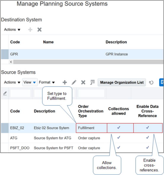

Enable Cross-References
You must create and maintain cross-references that relate business data between your fulfillment system and Order Management. Use the Manage Planning Source Systems page as part of this set up.
For example, set these values.
Attribute |
Value |
Order Orchestration Type |
Fulfillment |
Collections Allowed |
Contains a check mark. |
Enable Data Cross-Reference |
For details about.
Cross-references, see Overview of Creating Cross-References in Order Management.
Managing planning source systems, see the section that describes how to collect data in Quick Start for Setting Up Order-to-Cash.
