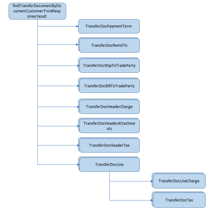

The data mapping and sample payload for the Oracle-1-0-B2B-Invoice-Out message definition are outlined in this section.
Data Mapping
Here's the structure of the payload that's received from the application:
Refer to Figure 1 in Oracle-1-0-B2B-Invoice-In for the structure of the transformed payload that's sent to your trading partner.
This table shows the mapping of the outbound B2B invoice message to the application:
