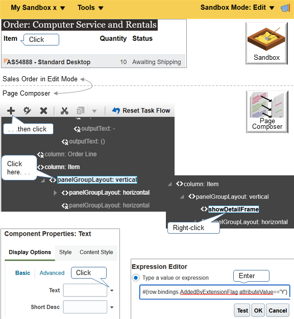

You will use this general flow to set it up:
Try it.
- Open Page Composer.- Create a sandbox, and enable Page Composer. For an example, see Modify How Order Management Displays Attributes.
- Go to the Order Management work area, then click Tasks > Manage Orders.
- On the Manage Orders page, search for, then open any sales order.
- On the Order page, in the upper-right corner, click your login name.
- In the Settings and Actions menu, click Edit Pages. Page Composer opens in a separate user interface that sits like a frame around the outside of the Order Management work area. You can now use Page Composer to modify the Order Management work area's user interface in real time.
- Access the sales order's structure.- Click Page Composer's Structure tab.
- Toggle the Hide Structure, Show Structure button so you can see where the Structure window is. Its usually at the bottom of the page.
- In the Structure window, click Dock > Right.
- Expand the Structure window until you can examine it's contents.
- On the sales order, on the order line, click the Item column header.
- Notice that the Structure window automatically scrolls to the
                                column: Itemcomponent.
- Add a text component to the sales order.- You're going to add text inside the panelGroupLayout: verticalcomponent, so click panelGroupLayout: vertical.
- At the top of the structure window, click the plus icon ( + ).
- In the Add Content Dialog, click Components.
- Click Add in the Text row.
- Notice that Page Composer added a new showDetailFrame: Textcomponent immediately below thepanelGroupLayout: verticalcomponent in the structure window.
- In the Add Content Dialog, click Close.
- Add an order management extension.- Right-click the new showDetailFrame: Text component, then click Edit.
- In the Component Properties dialog, on the Display Options tab, in the Basic section, click the down arrow next to the Text attribute, then click Expression Builder.
- In the Expression Editor dialog, select the Type a Value or
                                Expression option, then enter the
                            value.#{row.bindings.AddedByExtensionFlag.attributeValue=='Y'}
- Click OK.
- In the Component Properties dialog, click Apply > OK.

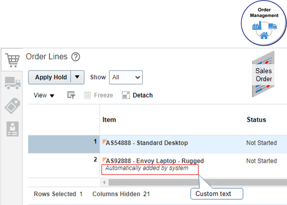

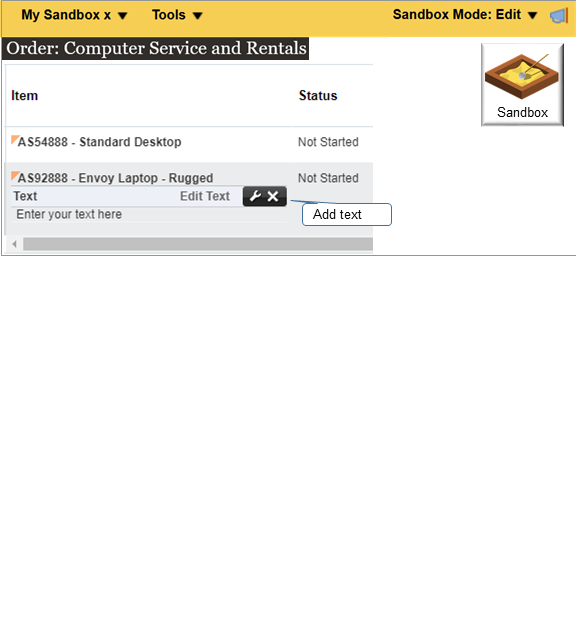

- Add the text that you want to display. - Notice that the Item column in the sales order now includes an area where you can enter text.
- Click Edit Text, then add the text that you want to display, such as Automatically added by system.

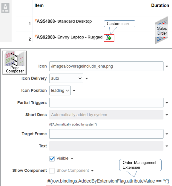

Display an Icon
Assume you have an icon name coverageinclude_ena.png, and you want to display it as part of the item. You can use an order management extension in Page Composer to add it:
