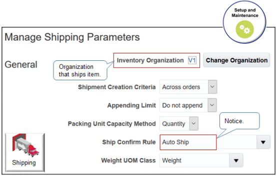

Identify the ship confirm rule that your inventory organization uses.
Go to the Setup and Maintenance work area, then go to the task:
Offering: Manufacturing and Supply Chain Materials Management
Functional Area: Shipping
Task: Manage Shipping Parameters
Set organization to Vision Operations.
On the Manage Shipping Parameters page, notice the value in the Ship Confirm Rule attribute.
For this example, assume the value is Auto Ship.

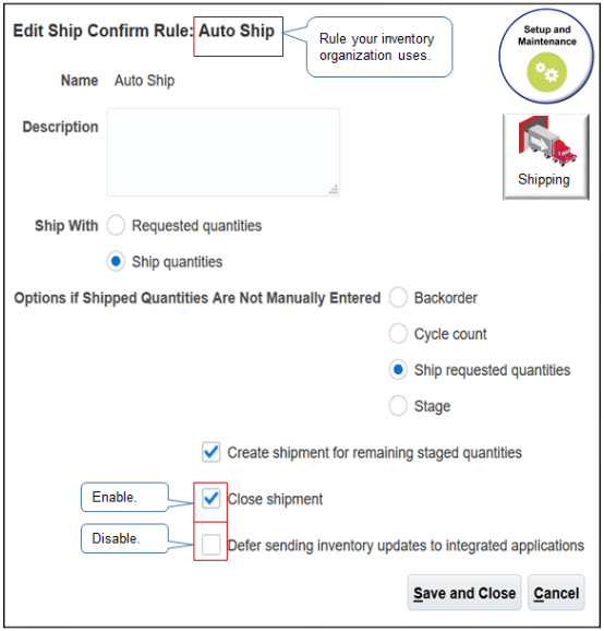

Modify the ship confirm rule.
In the Setup and Maintenance work area, go to the task.
Task: Manage Ship Confirm Rules
On the Manage Ship Confirm Rules page, search for Auto Ship, then open it for editing.
In the Edit Ship Confirm Rule dialog, set the values, then click Save and Close.
Option
Value
Close Shipment
Enabled
Defer Sending Inventory Updates to Integrated Applications
Disabled
