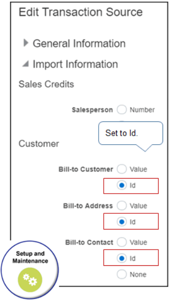

I encounter an error when I run the Import AutoInvoice scheduled process.
This error happens when you set the value instead of the Id during set up. Try this:
