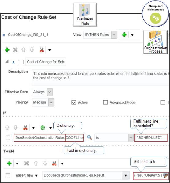

Create If Statement for First Rule
Here's the first rule.
where
Object
Description
DooSeededOrchestrationRules
Dictionary that contains rule sets, facts, functions, variables and so on for order orchestration.
DOOFLine
Fact in DooSeededOrchestrationRules. It contains order line attributes.
DOOFLine is an abbreviation for distributed order orchestration (DOO) order line (FLine). The phrase distributed order orchestration is an earlier name for Oracle Order Management.
statusCode
Order line attribute.
The entire value isn't visible in the screen capture. Here's the full value.
DooSeededOrchestrationRules.DOOFLine.statusCode
SCHEDULED
One value that statusCode might contain.
Result
Fact in DooSeededOrchestrationRules. You use it to store the results of the business rule you're defining.
resultObjKey
Property of the Result fact.
esultObjKey:5
Sets the value of resultObjKey to 5.
Create If statement for first rule.
  1. In the Setup and Maintenance work area, go to the task.
    • Offering: Order Management
    • Functional Area: Orders
    • Task: Manage Orchestration Process Definitions
  2. On the Manage Orchestration Process Definitions page, locate the orchestration process where you must add the cost of change rule, then open it for editing.
  3. In the Orchestration Process area, next to Cost of Change Rule, click Click for Rule.
  4. In the Cost of Change Rule dialog, click Add > General Rule > Properties, then set the values.
    Attribute
    Value
    Name
    Cost of Change for Scheduled Lines
    Description
    This rule measures the cost to change a sales order when the order line status is Scheduled. It sets the cost of change to 5.
  5. Click Left Value.
  6. In the Condition Browser dialog, expand DooSeededOrchestrationRules > DOOFLine, then click StatusCode > OK.
  7. In the Right Value attribute, enter "SCHEDULED". You must include the double quotation marks.
Create Then Statement for First Rule
  1. In the Then area, click Add Action > Assert New.
  2. Click Select a Target > DooSeededOrchestrationRules.Result.
  3. Click Edit Properties.
  4. In the Properties dialog, in the resultObjKey row, enter this value, then click OK.
    Attribute
    Value
    Value
    5
  5. Click Collapse.

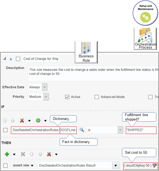

If Statement for Second Rule
Create the If statement for the second rule.
  1. Click Add > General Rule > Properties, then set the values.
    Attribute
    Value
    Name
    Cost of Change for Shipped Lines
    Description
    This rule measures the cost to change a sales order when order line status is Shipped. It sets the cost of change to 50.
  2. Click Left Value.
  3. In the Condition Browser dialog, expand DooSeededOrchestrationRules > DOOFLine, then click StatusCode > OK.
  4. In the Right Value attribute, enter "SHIPPED". You must include the double quotation marks.
Create Then Statement for Second Rule
  4. In the Properties dialog, in the resultObjKey row, in the Value column, enter 50, then click OK.
  5. In the Cost of Change Rule dialog, click Save.
  6. On the Edit Orchestration Process Definition page, click Save.
