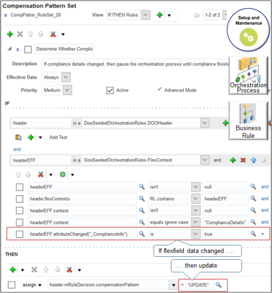

headerEFF.attributeChanged("_ComplianceInfo") is true
Make sure attribute ComplianceInfo of the extensible flexfield changed. You use attributeChanged to determine whether the value for ComplianceInfo is different in this revision.

  8. Make sure attribute ComplianceInfo of the extensible flexfield changed.
    • Click Simple Test.
    • Near the window to the left of Is, click Left Value, expand headerEFF, and then click hasChanges.
    • In the window in the Condition Browser, notice the value.
      Insert "_ComplianceInfo" between the parentheses, then click OK. For example:
    • In the window to the right of Is, enter the value.
Create Then Statement
Create the statement that pauses the orchestration process until compliance is done.
  1. In the Then area, click Add Action > Assign.
  2. Click Select a Target, then click header.mRuleDecision.compensationPattern.
  3. In the window to the right of the equal sign ( = ), enter "UPDATE".
    You must include the double quotation marks.
  4. Click Validate, make sure the Validation Log that displays doesn't contain any errors, then click Save.
  5. On the Edit Orchestration Process Definition page, click Save.

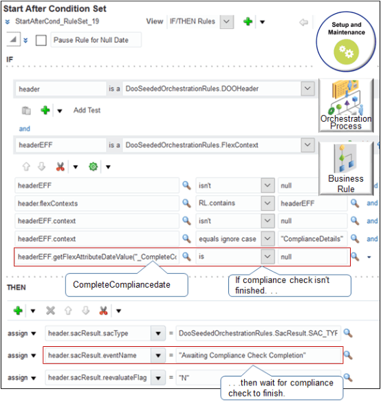

Pause Task While Date Is Empty
Order Management sets the compliance completion date when compliance check is done. If the date is empty, then it indicates compliance check isn't done, and the rule doesn't release the pause task. For example:
  • If CompleteCompliancedate is empty, then compliance check isn't done. Assign a business event to indicate we must wait.
rule that pauses task while date is empty
Here's the code that the rule uses.
If header is a DooSeededOrchestrationRules.DOOHeader
and if headerEFF is a DooSeededOrchestrationRules.FlexContext and
  headerEFF isn't null and
  header.flexContexts RL.contains headerEFF and
  headerEFF.context isn't null and
  headerEFF.context equals ignore case "ComplianceDetails" and
  headerEFF.getFlexAttributeDateValue("_CompleteCompliancedate") is null
then
  assign header.sacResult.sacType = DooSeededOrchestrationRules.SacResult.SAC_TYPE_EVENT
  assign header.sacResult.eventName = "Awaiting Compliance Check Completion"
  assign header.sacResult.reevaluateFlag = "N"

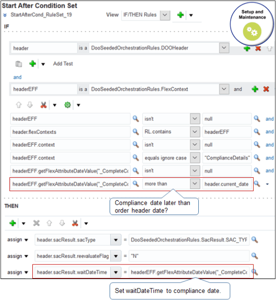

Pause for Future Date
You can create a rule that pauses until compliance completion date is later than order header date. For example:
  • If CompleteCompliancedate happens after order header date, then compliance check is done. Prepare to release the pause task.
To prepare to release the pause task, you set waitDateTime to the compliance date. For details about waitDateTime and sacResults, see Guidelines for Pausing Orchestration Processes.
rule that sets waitDateTime to the compliance date
  headerEFF.getFlexAttributeDateValue("_CompleteCompliancedate") isn't null
  headerEFF.getFlexAttributeDateValue("_CompleteCompliancedate") more than header.current_date
then
  assign header.sacResult.sacType = DooSeededOrchestrationRules.SacResult.SAC_TYPE_TIMER
  assign header.sacResult.waitDateTime = headerEFF.getFlexAttributeDateValue("_CompleteCompliancedate")

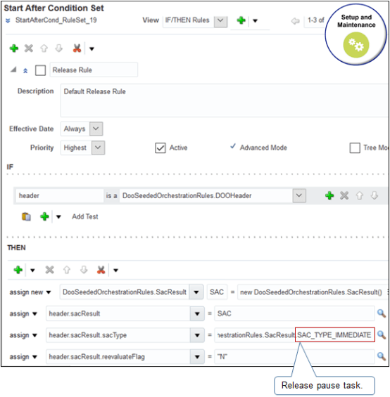

Release Pause Task
Create a rule that releases the pause task. It doesn't reference the extensible flexfield you set up earlier in this topic. Instead, it uses rules.
  • Pause Rule for Null Date
  • Pause Rule for Future Date
It uses the values that these rules set for SacResult to determine when to release the pause task.
Here's the rule that releases the pause task.
rule that Releases Pause Task
Here's the code that this rule uses.
then
  assign new DooSeededOrchestrationRules.sacResult SAC = new DooSeededOrchestrationRules.sacResult()
  assign header.sacResult = SAC
  assign header.sacResult.sacType = DooSeededOrchestrationRules.SacResult.SAC_TYPE_IMMEDIATE
You add this rule in the Pause Rule column on the same step where you added the compensation pattern.
